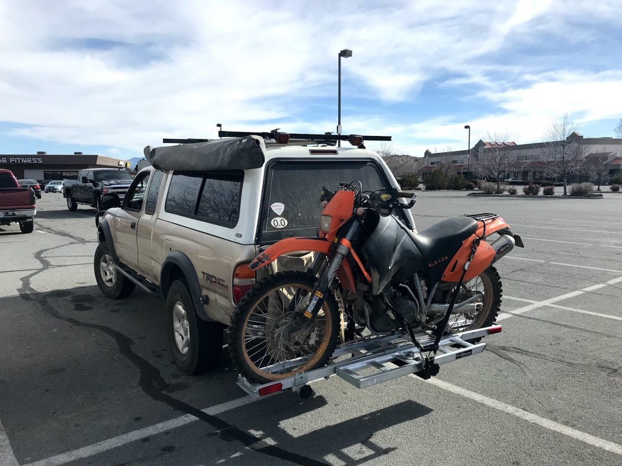

    I carried this 320 pound KTM from Carson City NV back to the Bay Area, about 220 miles. I have load bearing bump stops. The truck drove pretty okay. You could feel the extra weight.
    Edit - If I did this all the time I'd just get a trailer.
