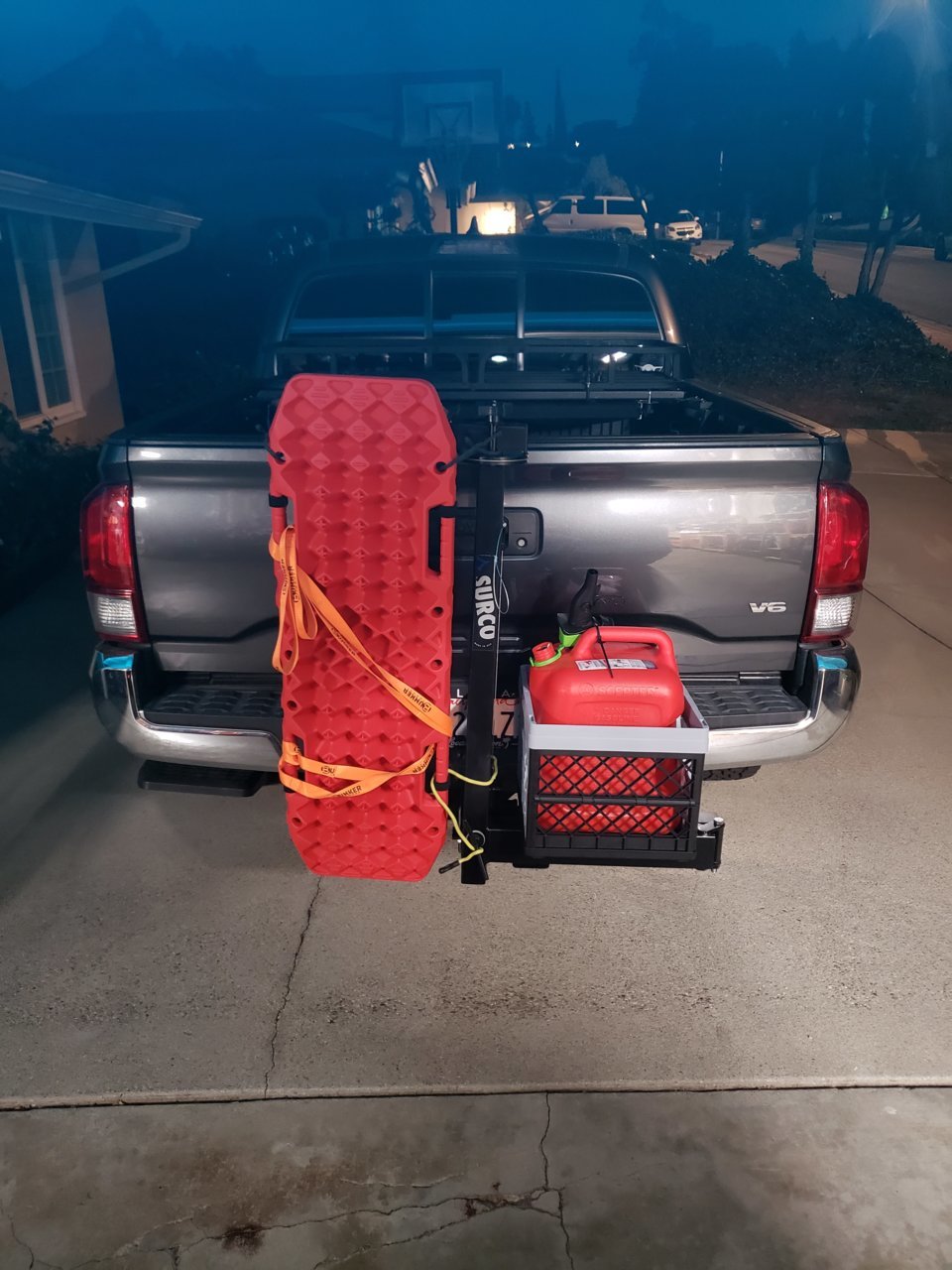

    Is this brilliant? or just plain stoopid?
    I bought a cheap and beefy swing-away bike rack. Want to chop of the bike mount part at the top and bolt everything but the spare tire to it!
    :thumbsup: / :crazy:
    :anonymous:

    Does the tailgate open with the Milk crate/gas can there?

    :pout: Unfortunately no, I would need to unstrap the milk crate and move it to the ground. I just didn't think 40# of fuel would would be stable up higher on the post, or sticking out another 13" from the rack.

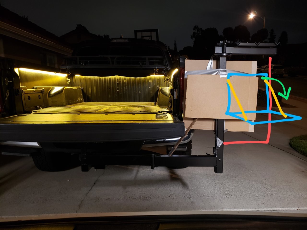

    and a table...

    Does your plate need to be visible?

    You carry a long table with you all the time. It's already built and already paid for. Just a suggestion.

    I do agree that the license plate should probably be visible, but what's the difference if it were a cargo carrier filled coolers and firewood? or 4 bikes?
    I am re-thinking this and mounting slimmer jerry can type of container higher up on the vertical post.

    I drive a DCSB, my main problem with this set up is that on a stock truck the receiver is the only really good recovery point back there. When I'm offroad I don't want to be messing around with a loaded rack trying to get it when I'm in trouble.

    True, I would miss having a recovery point back there.
    Seems sketchy...but maybe?
  17. Oct 21, 2022 at 2:38 PM
    #17
    saint277
    saint277 Vigilo Confido
    Apr 14, 2020
    #324724
    2,291
    No, unless you can do a perfectly strait pull the much lever arm is going to load the receiver in ways it wasn't meant to be loaded. That's why most receiver shackle adapters are so short.

    One can never have enough counterspace
