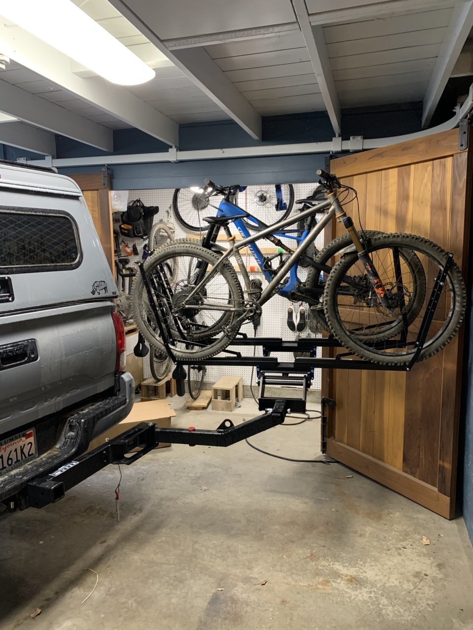

    I just changed out my hitch setup. Previously I had a Yakima Dr Tray with an EZ+1 third tray. On camping trips we added a Kuat swing out hitch.
    F318109E-5DDF-4144-84BF-35CFA093E536.jpg 0406B9AA-6E96-4977-A32C-AFAF2EA45C0E.jpg
    The Kuat was pretty good. Here are some pros and cons:
    Pros:
    • Not super burly, but plenty strong.
    • Works exactly as you want it to.
    • Easy to put on and take off
    • It comes with a locking hitch pin.
    • You can lock it in the fully open position
    • Relatively affordable, especially if you get it at REI with a 20% off sale.
    Cons:
    • It does hang down a little low but not so much that it really matter.
    • The anti wobble locking hitch pin that works okay but it's not that great.
    I never really loved the Yakima. One caveat is that I had one of the first generation racks so they may have resolved a lot of these issues. But here are some pros and cons from my experience.
    Pros:
    • It’s pretty light.
    • Adding on the third bike tray is super easy which is a great option.
    • You can open the tailgate completely with mounted.
    • The release handle to fold the rack up is at the end of the rack.
    • It has integrated cable locks (for what they’re worth).
    • It can accommodate long wheel bases, short wheel bases, skinny tires, and fat tires.
    • You can move the positions of the trays for and aft and side to side with no additional tools
    • Easy to load bikes on.
    • Good anti wobble mechanism.
    • Ability to match locking cores retroactively.
    • There is a built in locking point for throwing a chain through the bikes and locking them up.
    • Built in bottle opener?
    Cons:
    • The mechanism to fold the rack up is finicky. You have to have it in just the right spot to release the handle.
    • The bikes tend to wobble and sit funny in the trays. You really have to push the locking arm down hard to take the play out.
    • Once you push the arm down hard, it’s difficult to release the arm. You have to push down even harder to take the tension off the locking mechanism before you can push the release button. This is in fact the best theft deterrent the rack has!
    • The trays are a little short. I have modern geo mountain bikes, size large, and they always hung past the end of the tray. Technically that was fine, just weird.
    • The cables are a little short and hard to put away

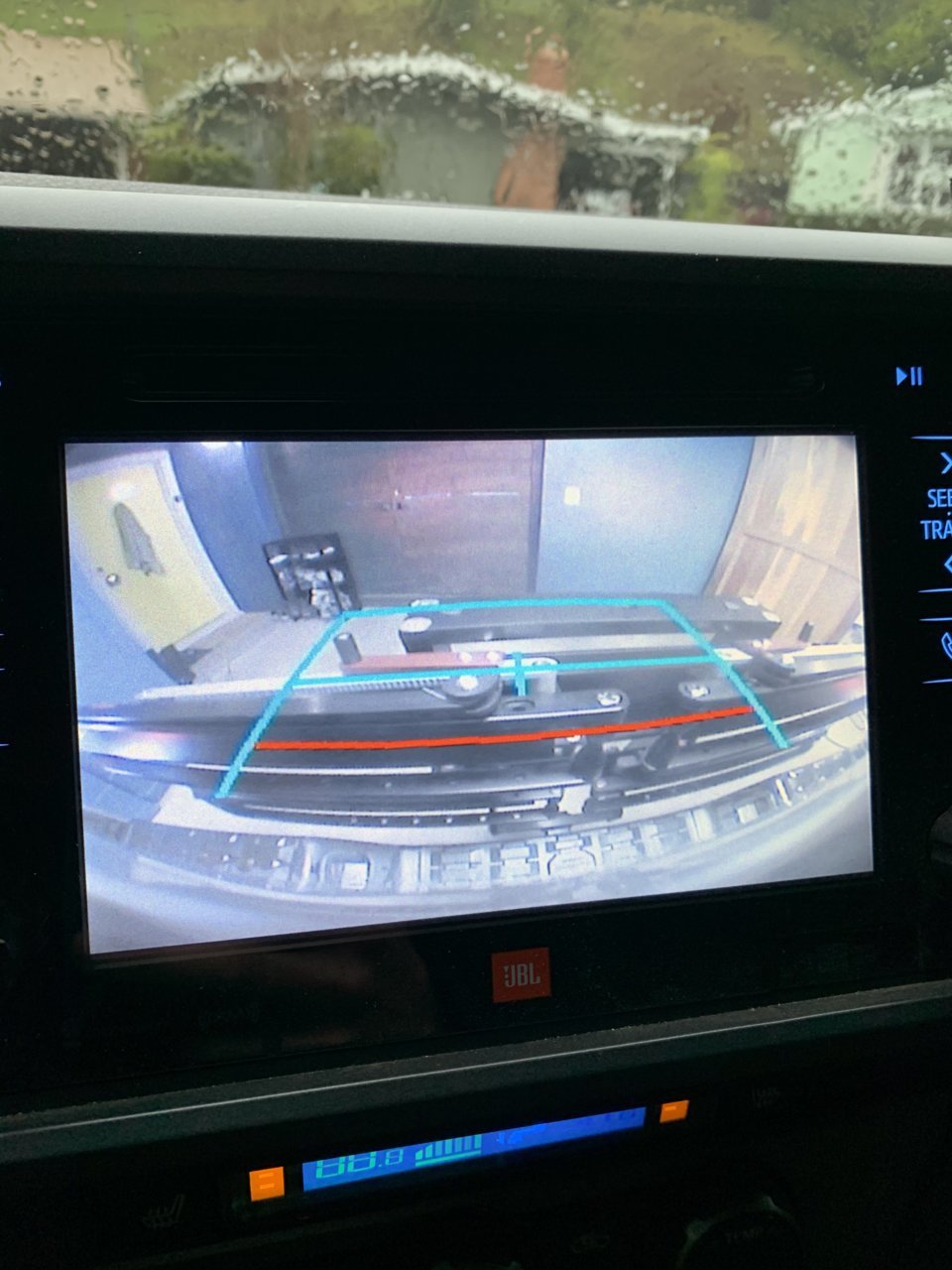

    • Completely blocks the camera and is just a big rack.
    • You can over-loosen the anti-wobble mechanism. Why is there no built in stop to prevent that?
    • Pretty damn expensive.

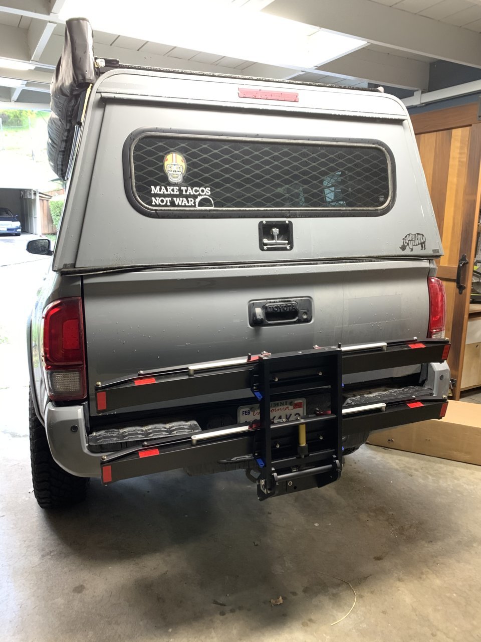

    I have since upgraded to a Wilco Hitch Swing and a 1up super duty double rack. These are both really well built and super burley, but not without faults. I haven’t thoroughly tested these but here are my initial impressions.
    A41FEE60-3304-4A1F-8FB7-CA934E47992C.jpg 98A73368-5D15-41A4-8634-2F97ED43FE5F.jpg 09B3A52D-50CE-4D1A-910C-272763902C20.jpg 5B1F1B3B-CF02-4EB8-A221-727162EFC6D4.jpg
    Note that the picture of the camera view is with the 1up only, not with the Wilco hitch. With the Wilco the camera is blocked.
    The build quality of the Wilco is top notch and it's super burly. But it's got a couple things I don't love.
    Pros:
    • Definitely built for off-road use. Super burly build.
    • Great ground clearance.
    • Amazing anti-wobble mechanism.
    • The fit is really good.
    Cons:
    • Awkward to mount to the hitch. The anti-wobble mechanism is a little tricky to load into the hitch.
    • The plastic shroud around the tailgate handle contacts the hitch. It just barely hits it, but if you dropped the tailgate it might do something.
    • The locking pin is a little hard to put in, especially compared to the Kuat.
    • No lock in the fully open position.
    • You can't open the tailgate all the way with a bike rack on. But that's why you have a swing-out anyway.
    • A little harder to swing out compared to the Kuat.
    • The bike rack is way higher, which makes it a little trickier to load bikes onto. (But that's the sacrifice for more ground clearance).
    • Expensive and long lead time. I scored this one used, fortunately.
    The 1up build quality is also top notch, but again, it's not without fault.
    Pros:
    • Super burly, well built, and an industrial aesthetic.
    • Bike heights are staggered which helps reduce conflicts between handlebars and seats
    • You can adjust how the bikes are centered with out you position the loading arms.
    • Great anti-wobble mechanism.
    • Everything can be replaced or repaired.
    • Relatively light.
    • Super easy to load
    • Way smaller profile. It tucks up very nicely next to the tailgate.
    • The tailgate can be opened all the way with the rack in the flat position.
    • The camera is still functional (without the Wilco swing-out on).
    • Clever locks for the wheels and the hitch.
    • The bikes are super secure.
    • Clever storage configuration.
    Cons:
    • The release mechanism to fold the rack is finicky. I ended up adding on the pull handle add-on, which should come standard with it IMO.
    • It's a little harder to load bikes on and to unload them.
    • 2.6" tires are a bit tight. Supposedly it can take 3" tires but that just doesn't seem right to me. You can get a spacer kit though.
    • Lots of exposed pinch points.
    • An industrial aesthetic.
    • You can't retroactively get keyed-alike locks
    • No built in locks for the bikes. (FWIW, I always chain up my bikes anyway if I have to leave them unattended).
    • No obvious locking point, but plenty to choose from.
    • Pricey, though not that far off from Thule or Yakima.
    I'll report back on this when I have more experience. Overall I have way more confidence in this new setup for biking/offroading trips. It's also awesome to be able to support smaller manufacturers that are making really killer products.

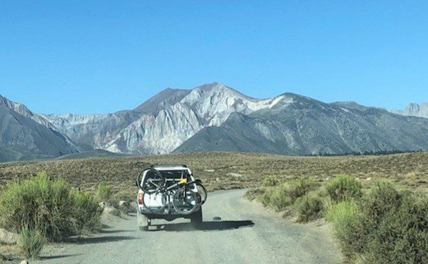

    Not sure which rack we used. My buddy is the biker with the rack. My Tacoma last summer near Crowley Lake

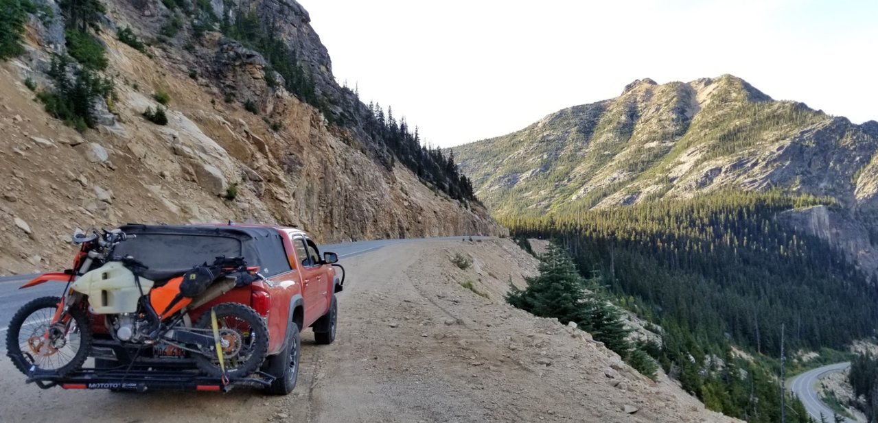

    Haven't seen a moto rack thread.
    Have been happily using one of these since 2017.
    https://www.mototote.com/mototote-mtx-sport-motorcycle-carrier.html
    Rock steady with a 500excf adv (280#) over all sorts of terrain.
    Very simple and effective steadying mechanism. An allen bolt goes through the rack hitch hole (slightly larger than the allen bolt head), the head rests against the truck hitch post and tightening the nut on the other end pulls the two posts together. Once you crank down the bolt/nut the rack is effectively part of your truck.
    One time backed into a barrier and the main horizontal post bent a bit, was able to order a replacement part shipped out and easily installed.
    They have a modular config.
    There's other styles, the one that raises up/down and supports the bash plate is interesting and probably smaller storage req. but haven't needed to change my setup.
    MTB with front tire comes off and goes inside, moto on outside, best of both worlds.
