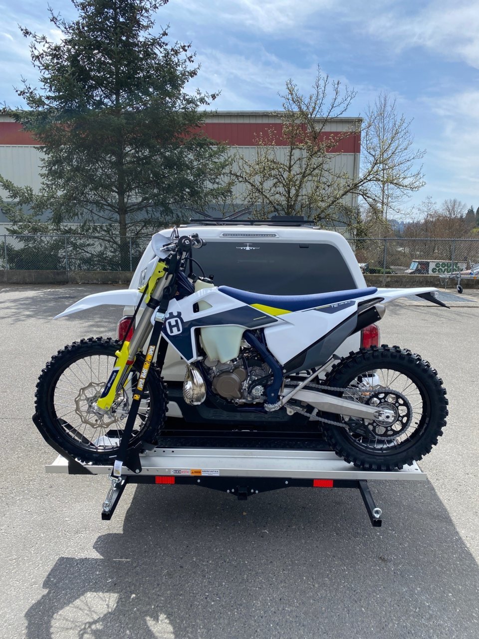

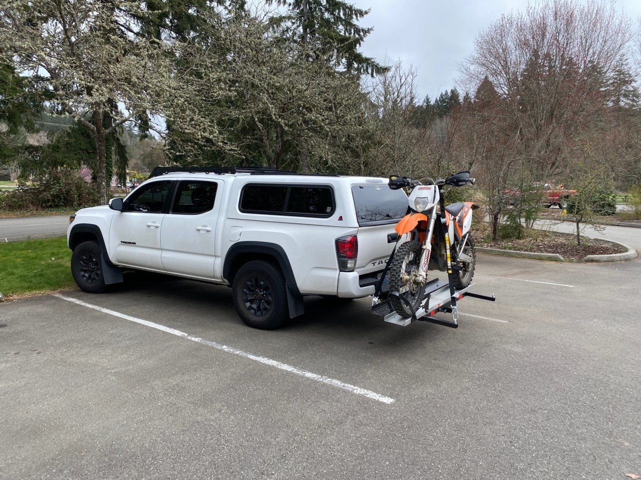

    I use that exact carrier on my 2020 TRDOR and it's been great for the price, I ordered it off Amazon and recieved it quickly with no issues. There is some surface rust developing on the ramp but that is expected I suppose, not the best paint quality I reckon. I carried my 12' 500 EXC for a while and now my 21' TE 300i with no issues, but these are sub 250 lb bikes. I would not be comfortable throwing my GSA or Road King on there obviously. Even with that weight and the canopy on the truck, it sags bad once the bike goes on. That hitch carrier is NOT light. I have firestone ride rite air bags showing up tonight that I will use to level it under load. I was not interested in a lift or leafs so we'll see how that works. The sag is manageable but at night your headlights will be to the sky on a factory truck.
    Also, these are in my opinion a must have and make life much easier. https://www.amazon.com/gp/product/B009XIP942/ref=ppx_yo_dt_b_search_asin_title?ie=UTF8
    A fork brace helps too, particularly with a dirt bike. I also bought a locking cable to secure the bike to the truck/rack if I want to grab some food or what not.
