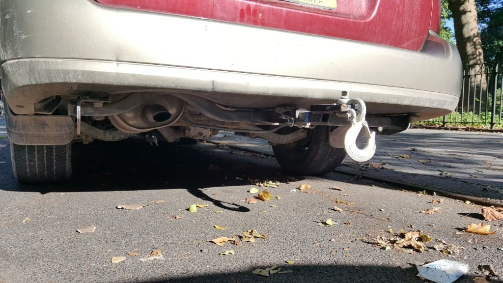

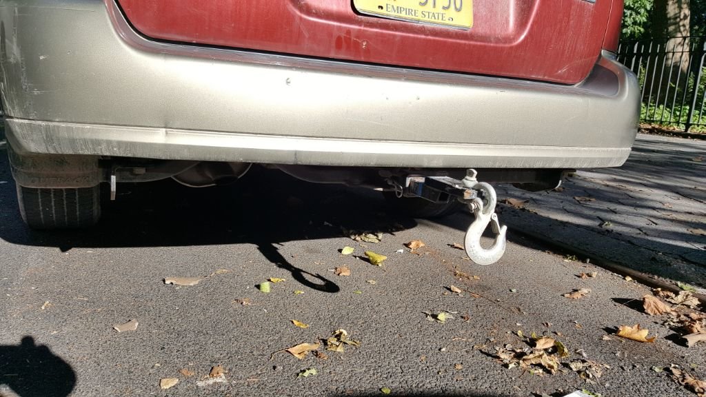

  17. Sep 8, 2017 at 6:02 AM
    #37
    Bastek
    Bastek Average Member
    Jun 6, 2017
    #220876
    4,304
    Seb
    SI NY
    '17 OR dcsb
    KDMaxP10, plastidip
    I bought my Smittybilt Receiver Shackle before doing research. Now I have it, hopefully I will not have use it... If I will, just because reading whatever you guys wrote, I'll feel better about it... At least maybe better, lol.
    We are contemplating about hefty chunks of steel, some people don't...
