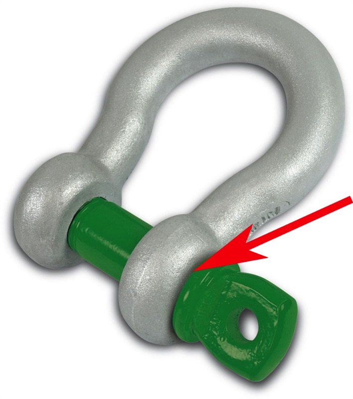

    If I understand what you're ranting against is the advise you sometimes hear about leaving the pin on the shackle a little loose as insurance against it locking in place.
    From one manufacturer's website: http://news.thecrosbygroup.com/news/shackle-to-shackle-by-crosby
    "The screw pin threads shall be fully engaged and tight and the shoulder should be in contact with the shackle body."

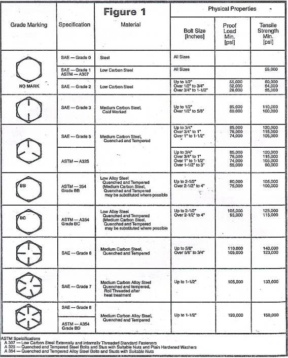

    I use a 5/8" grade 8 bolt personally.

    That's bad. Not only will DOT give you a ticket for that if they see it, bolts are tested for tensile strength (pull) and not shear strength. A grade 8 bolts as been hardened so it will take more pull to break it, but it does not stretch or bend, it just shatters. You don't want a hitch pin that shatters, you want one that will bend and bend and bend and hold that hitch in with its very last breath and then break. If grade 8 bolts worked as hitch pins, why would hitch manufacturers go through the trouble of making a pin. They would just slap a grade 8 bolt in there.

    I dunno about DOT, I don't tow anything. This thread is about a hitch mounted shackle adapter.
    The question of grade 8 has been around forever. It is true that as you heat treat a fastener to a higher tensile strength it loses ductility and becomes more brittle. That means the region between yield and ultimate shrinks. It still has a point where it will deform.
    The SAE charts for fasteners lists for bolts under 3/4" grade 5 proof is 85,000 psi and tensile is 120,000 psi. For grade 8 proof is 120,000 psi and tensile is 150,000. This means that even though the margin between proof and ultimate is smaller the grade 5 will have broken before you reach the proof point of a grade 8.
    But in this case we're worried about shear, which is generally assumed to be 60% of the tensile.
    For my 5/8" bolt.
    A = (.3125)^2 * pi = 0.307 sq-in
    Proof is therefore 0.307 sq-in * 120,000 lbf/sq-in = 36,840 lbf
    Taking the 60% assumption for shear = 0.307 sq-in * 150,000 psi * 0.6 = 27,630 lbs.
    Then for a hitch the pin is actually in double shear, so it's twice that at 55,260 lbf. In a recovery using my shackle adapter the grade 8 bolt is one of the last things I'm really worried about. Even if it's an impulse, which a shock load would be the concern on a fastener that more brittle, an 8,000 kg snatch strap is going break before the bolt.
    The reasons I use it are (1) I know a grade 8 bolt from a known source is actually grade 8. I couldn't tell you for sure what is true of a random hitch pin. The pins I have for my tractor 3-point are grade 5, so I would assume that's typically the case and I would trust that to be true from a reliable source.
    Second, using a bolt allows me to use a thick washer on each side of the hitch receiver and a lock washer and nut. So I feel the hitch is better supported and the pin/bolt isn't rattling around or sitting there rolling in the hitch.
    If I was towing I wouldn't necessarily come to the same conclusion, but that's my logic for using a bolt with my adapter anyway.
    Also think about this, the shackles and hooks we use sometimes get heat treated to grade 8. The Gunnebo hook I have on my winch is a G-8-10 series, which is heat treated to use with grade 100 chain. The material characteristics can't be taken out of context individually, being brittle is only important if your load is large enough for it to matter.

    Most bolts are hardened, the grading is telling you how much. A grade 5 is hardened to lower state (Rockwell C25 to C34) than grade 8 (Rockwell C33-C39), which is a byproduct of the treating they needed to get to reach their tensile strengths. A grade 5 is therefore more brittle than a grade 2. The question is a matter of degree. You should never use grade 2 or ungraded bolts on your truck, BTW. The flip side of the brittleness is being harder a grade 8 is more resistant to physical damage, e.g. it's a "tougher" bolt.
    That the joint isn't a tight fit doesn't matter, the load is the load. It changes the nature of the load. In this case the bolt or pin would be completely in bearing shear instead of clamping tension and friction shear. The object just needs to be able to deal with the load it's presented. The hitch pin and a bolt are undergoing the same loading. If the joint was tight and there was clamping the joint itself may hold an even higher load than the bolt/pin alone. But it isn't so it's just the shear of the bolt alone.
    One thing you should try never to do is a single shear bolt that puts a bending moment on it. That's where you get into trouble with fasteners, putting both compression and tension on opposing sides of it.
    Forging is how the steel shape was formed (as opposed to cast, NEVER use a cast shackle) from the original billet, ingot or bloom delivered by the foundry. A bolt can also be forged or rolled then maybe machined (depends). Heat treating is a separate process, could be done in various places in the production of the bolt, shackle or whatever else. The raw material was probably heat treated to some extent to meet the ASTM material spec the next factory in line requested.
    All shackles are heat treated, quenched and tempered, to give them whatever properties they need. They need to be tough but ductile but also hardened and stress relieved. There's a lot that goes into making this stuff.
    FWIW, the shackles we typically use in 4WD are grade A carbon steel hardened to grade 6 and not grade B alloy steel you may in aviation. You can tell instantly because a grade A 3/4" carbon shackle is rated 4.75 tons while the same size grade B 3/4" shackle would be rated for 7 tons.
    I also only buy known shackles from trusted sources, Crosby, Gunnebo, Van Beest, Columbus-McKinnon, etc. I don't personally even trust major name brand Warn, etc. Only primary manufacturers from sources known not to sell counterfeit. You can't get good shackles from Home Depot or 4 Wheel Parts or from eBay (usually). The place you buy them should be able to furnish certification or traceability documentation and if they can't they probably aren't approved to distribute or sell the brand.
    Your hitch pin did exactly what a grade 5 bolt would have done. That's all a hitch pin is, an unthreaded, loose fitting length of rod. If you cut threads in then it becomes a threaded rod. Put a 6-sided cap on it then it's a bolt. There's nothing magical about any of this. You start with iron, smelt and alloy it into steel, form it into a shape and treat it to whatever it needs to be.
    So a grade 5 hitch pin that's 5/8" in diameter is going to do the exact same thing as the shank (unthread part) of a 5/8" grade 5 bolt would in the same application. There is a small reduction in strength of a bolt due to being threaded, which is reducing the diameter to the minor diameter. That's something I did not calculate for before but should be mentioned.
