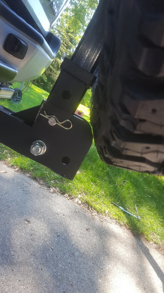

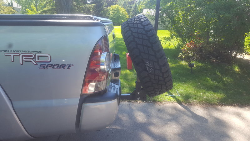

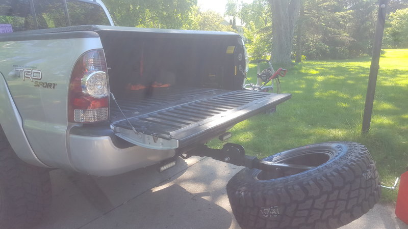

    I just finished stage 1 of my flip hitch mounted tire carrier...
    I have been wanting 33s for ever but was running 32s and last fall finally pulled the trigger on 33s, new rims and they are sweet. But wait there is no way to carry a 33" spare and I want to keep going out west. I plan on getting a rear bumper but that another 2 grand and still thinking about getting a new truck...
    I remember seeing hich mounted carriers but none of them filp because you have to make your own and I did..
    In fact all the parts are on Amazon and linked together so I'm not the first one... About 100 bucks..
    Fairly easy cut off the the receiver drill 2 holes buy hardware stage 1..
    Won't fit stock wheels 4 3/4 BS w 285s just clear with a little grinding..
    Stage 2 I'll do some welding and add a mount for my rotopax..
    Tested it on the road no problems at all...
    I would say good for light off roading / overlanding, I'll take it off for the dunes..
    I be out next week and over the 4th I'm going to the dunes..
    https://www.amazon.com/Goplus-Foldi...rd_wg=CcdfJ&psc=1&refRID=CHRW7E4W78680GFYV5PG

    Up date:
    Made a run up north and worked great. No problems and seams strong enough to take a beating. I'm still going to do some welding...
    Can still open the tonneau cover with out moving it and flips down when I need to...
    Seams tougher than I thought it would be...
