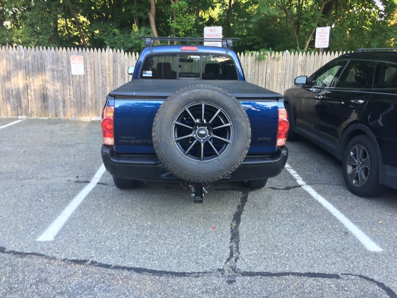

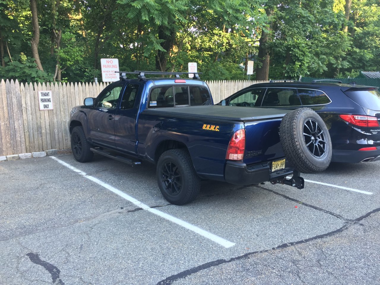

    Alright I finally got the pieces and put this thing together, gotta drill the holes still but here’s how it looks. I used an old 2 inch wheel spaced on the face so it keeps the tire off the tailgate. The only thing I notice is there’s a little play in the whole system so it wobbles a little but some hitch spacers will fix that alright. I’m pretty happy with how it looks, easy build. Will have to move my rear plate to the side of the bumper so it’s not blocked though!

    Alright so I drilled the holes and got it all in place so here's my thoughts. It works well and is pretty solid. There's a little wiggle room but that can be adjusted with on hitch stabilizers. The issue I'm having is the hitch hinge has two spots for a pin where the tire mount goes. The lower one is to hold the system in the upright or down low position, the top one is to keep the mount secured. The problem is when there's a pin in the top hole, the system will not lower all the way because the pint hits the metal on the sides of the hinge, (almost like the factory made the hole 1/8 to 1/4 inch too low. Now this could be corrected by either A) Drilling new holes just above the factory holes or, B) Taking a hack saw to the little bit of metal that catches the hinge pin. I think I'm going to do option A, because its simpler and won't leave sharp edges.
    Just a disclaimer to take into account for anyone trying this build.

    After All my hard work I think I might be ditching this mod, I got a roof basket recently and I think I may throw my spare up there. The problem I've had with this mod is a couple things. First I use my bed all the time and constantly having to lower the spare holder and raise it is getting to be a pain. I've noticed that my truck is now another foot longer in the back (already have a 6foot bed), so this has made parallel parking very difficult as I can no longer judge the room I have in the back. I'm gonna hang onto the setup in my garage but I think I'm gonna have to take it off my rig. This is just my personal experience with it, the rig is fairly sturdy and looks good its just not practical enough for me.
