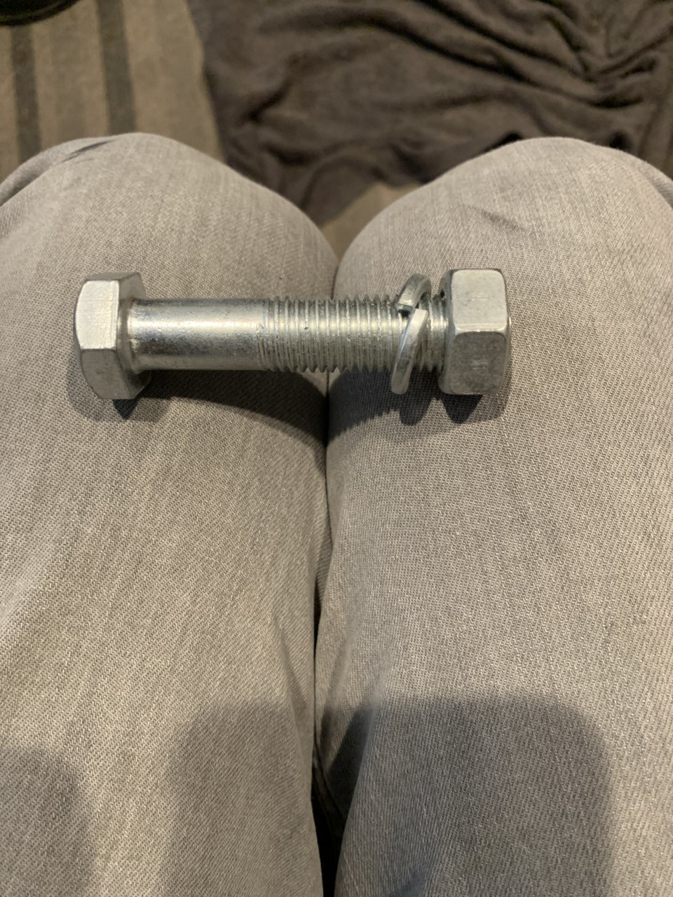

    Q: anyone suggest a non-locking hitch pin?
    could i skate with a 5/8" grade 8 bolt or would that be more expensive than a pin?
    thanks

    What's wrong with a $4 hitch pin from Harbor Freight?

    Exactly... I feel like a Grade 8 3" bolt, nut, and lock washer would be more expensive

    Plus, I'd be paranoid about the nut coming off.

    A grade 8 bolt will work if you make sure the shank is longer than the receiver tube width so the threads are not loaded in shear. Put a nylon lock nut on there so it doesn't back off. Only drawback to a bolt is you need tools to install and remove it.

    Dude who does truck mods told me that my grade 8 bolt was dangerous and he actually
    gave me a pin like the one below. Not sure what he was concerned about but he didn't
    think twice about his observation.

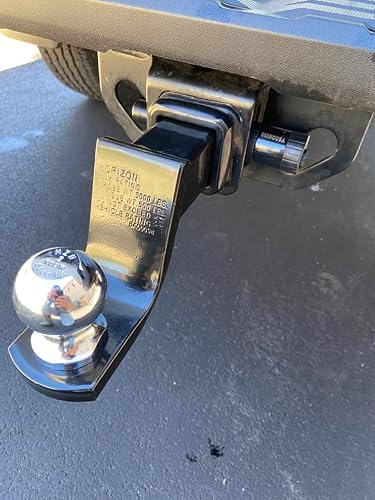

    One of the Amazon reviewers shows it on a Taco:
    For a visual deterrent it's OK...
