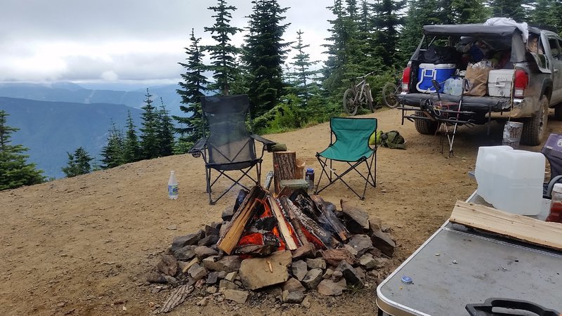

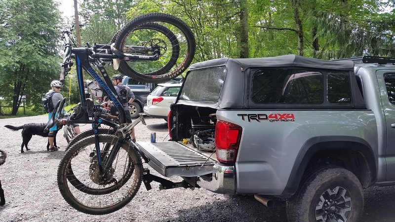

    I have the NSR 4-bike model and it's the best, most compact 4 bike carrier on the market. Designed for mountain bikes but I carry road bikes no problem (wheel out facing the opposite way as mtbs using the stem/handlebar).
    The entire rack pivots down, even fully loaded so I can get easy access to the tailgate. Also I have it set up so I can open the tailgate with bikes on there, there is a lot of flexibility in set up.
    Pics from this last weekend camping/biking. Will try to get a pic next time my bikes are loaded on it.20160704_141503.jpg

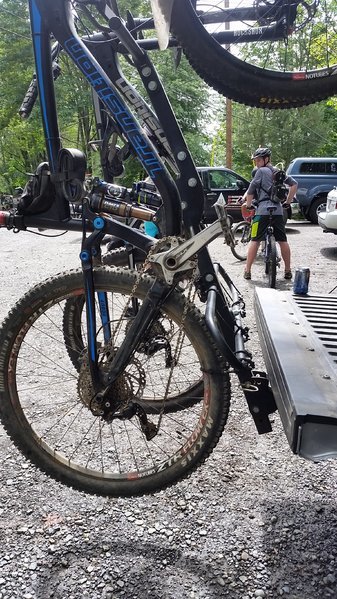

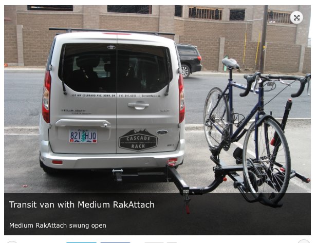

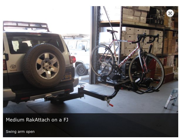

    I'm thinking about getting one of these for my Kuat NV hitch mounted bike rack.
    http://rakattach.com

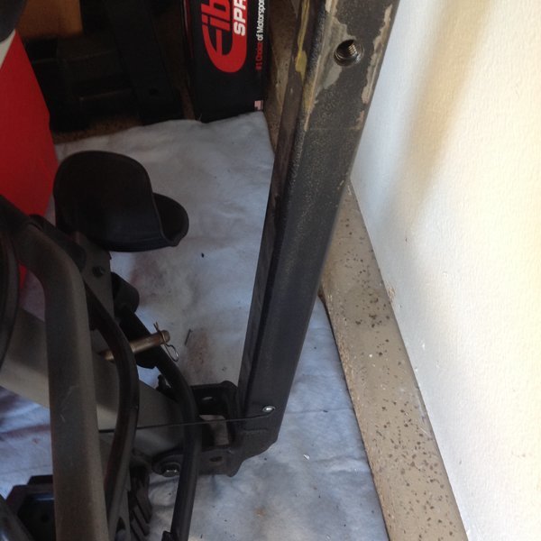

    I made new mounting holes on the side plates so that the entire rack sits about 2 inches lower. This required a bit of measuring a work to get just right since the mounting location is inset (you can see the original inset on the far side plate. I marked off the holes and inset and used a Dremel with the routing attachment to make the new insets.
    This solution allows me to use the tailgate when the rack is folded up. Please note that I have the single bike rack.

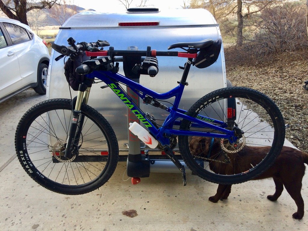

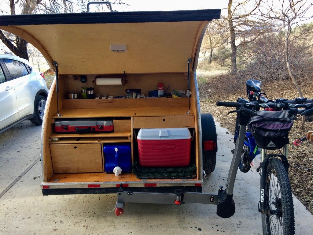

    I just picked up a Yakima Swingdaddy for our Teardrop. It'll work great on the Taco.
