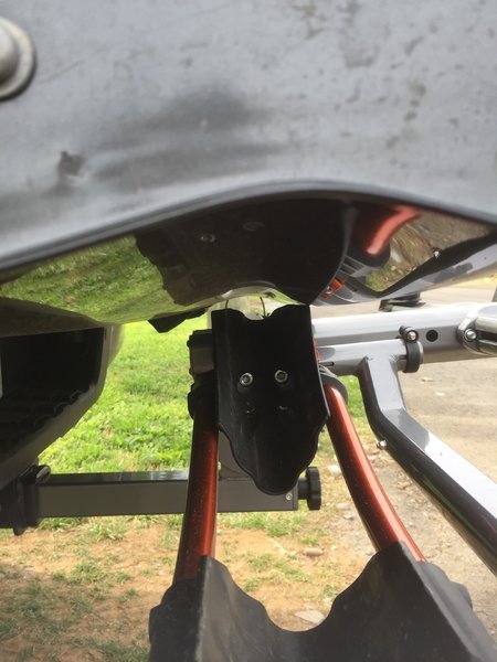

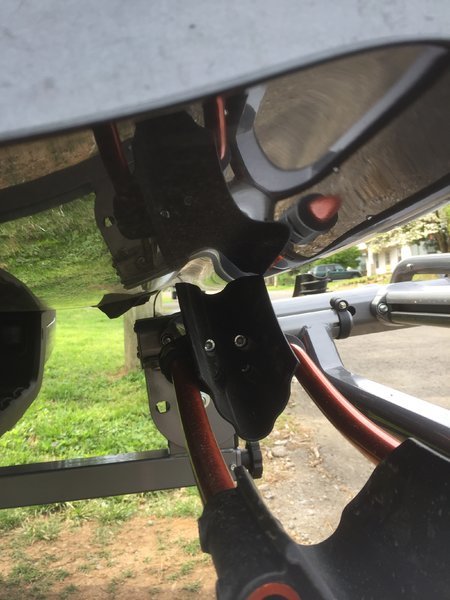

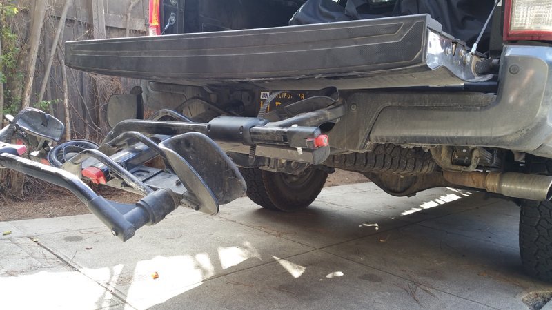

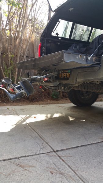

    What year did you buy that holdup? I have one I bought in late 2015, so I think it's still the latest model, and I had way more contact with the wheel trays on my tailgate. If I lowered the rack, the tailgate hit the metal end that moves up when you lower the back (the metal end i'm talking about is visible right to the left of the "W" on your license plate". Is that the factory hitch? Looks like it. Just wondering why it sits so much lower than mine did.
    Also, does yours have two pins to pull out to raise/lower, or the single pin from the left side? I've seen some on the road that have just one pull pin. Mine has two, and the second pin can be hard to get in/out. If I have the older version of the rack, I might sell it and get the latest. Those two things drive me nuts.

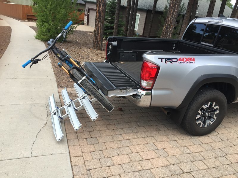

    I have the latest 1up 2" receiver heavy duty model. My tailgate clears by about 3/4" when the rack is in the normal carry position. I use it with 2,3 and four trays frequently. I've never had a clearance issue. I can also (with bikes loaded) tilt it down and still open the tailgate.
    I've used (owned 3 Yakima holdups) all the tray racks extensively except the new Thule T2 Pro (Thule including sport rack before Thule bought them, Kuat, lots of Yakima models). Although Thule and Kuat (leaving Yakima out on purpose) make great tray racks I feel very comfortable stating that the 1up is the best rack on the market for me.
    Hell they have a full money back paid shipping return policy!
    I also shuttle up a dirt road here in Flagstaff fairly often and have never felt like I've needed something to secure the rack other than the regular cinch bolt.

    Thanks for the pics, I was checking out a 1up at a trailhead in Moab yesterday and it pretty much sealed the deal for me, they are way solid in person - I was just afraid of the clearance issue. I was planning on getting the same one as you so it's good to know that it will work out and sounds like it is pretty burly.
