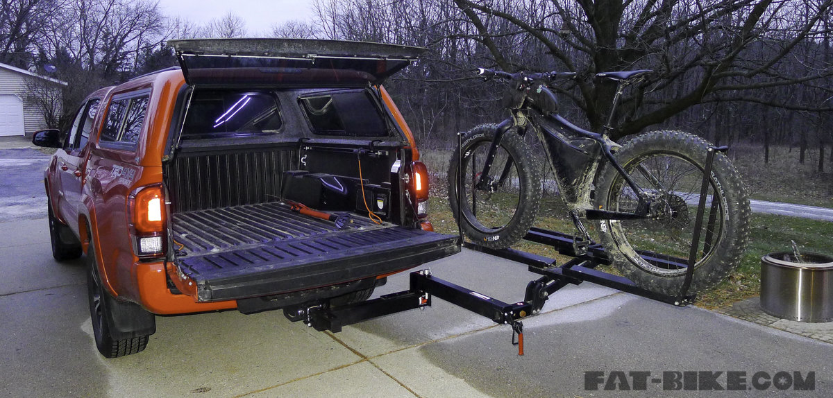

    x2 on this - if you cannot find it used, you can still get the T2 with the old geometry - it is called the T2 classic. I have it and it works with the tailgate down when it is folded down(without bikes on it)
    As far as folded down with bikes on it - it might work, but I have not tried that.

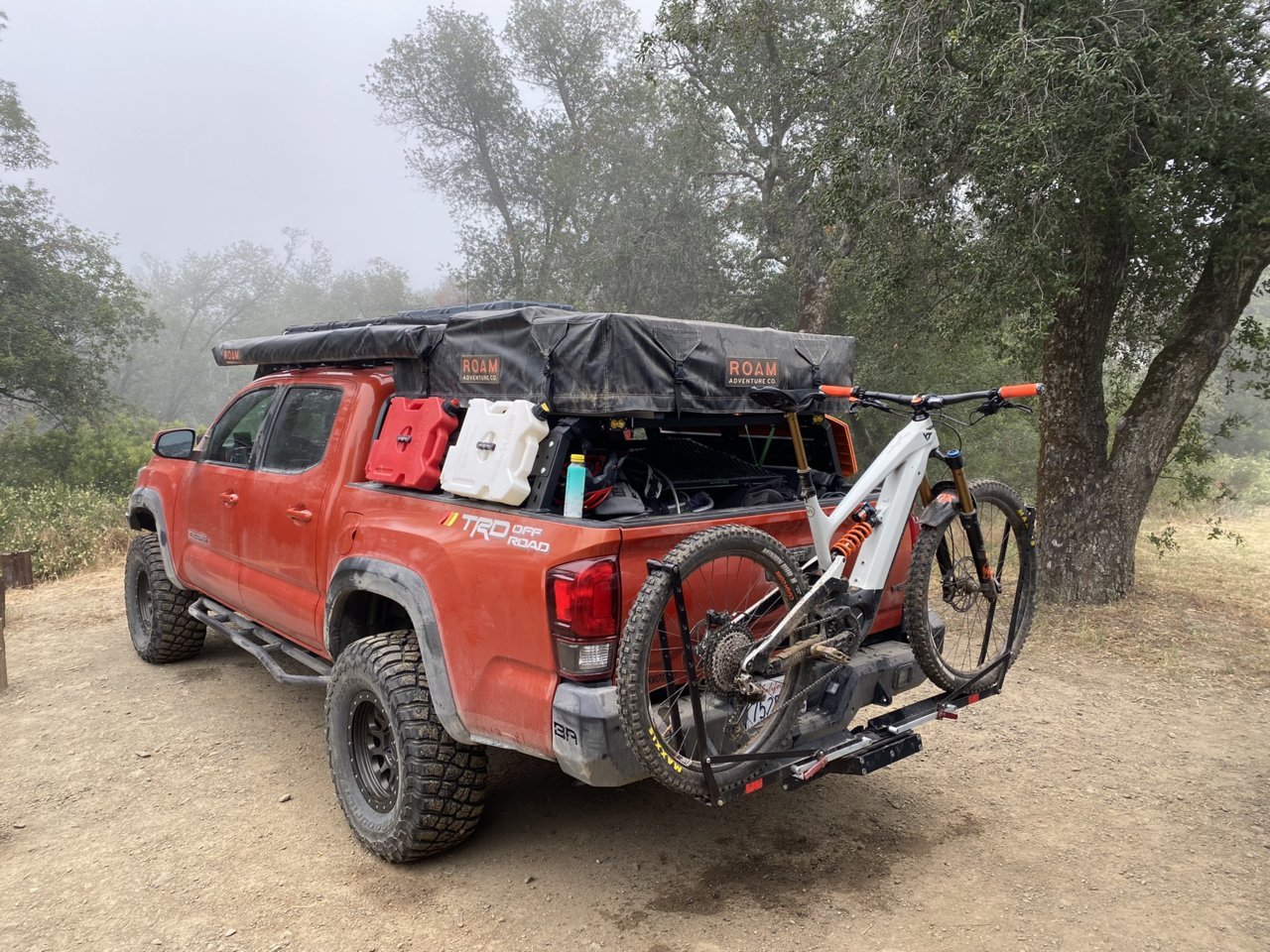

    Can you confirm that the tailgate, when opened, doesn't hit on the bike or 1Up rack when the rack is angled down/back? Your last picture makes it seem very close.
  9. May 29, 2022 at 5:51 PM
    #89
    DingleTower
    DingleTower My truck is like yer truck
    Dec 21, 2020
    #350283
    1,487
    Manitoba
    Pro MT - Lunar Rock
    I can confirm that it doesn't hit with mine though it is very, very close.
    It will depend on your particular bike and how far in/out you have your rack in the receiver though.

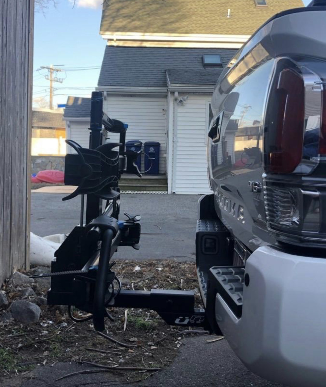

    Sorry to quote you on a post from 2016, but I recently picked up the same Yakima HoldUp 2 and I can't figure out how yours clears the tailgate.
    Mine hits in both the laid flat and the tilted position. I've not seen anyone else say it clears either. I thought from 2014ish and up the HoldUp 2 (the black and red one) are all the same until they released the Evo awhile back.
    Give us your secrets!

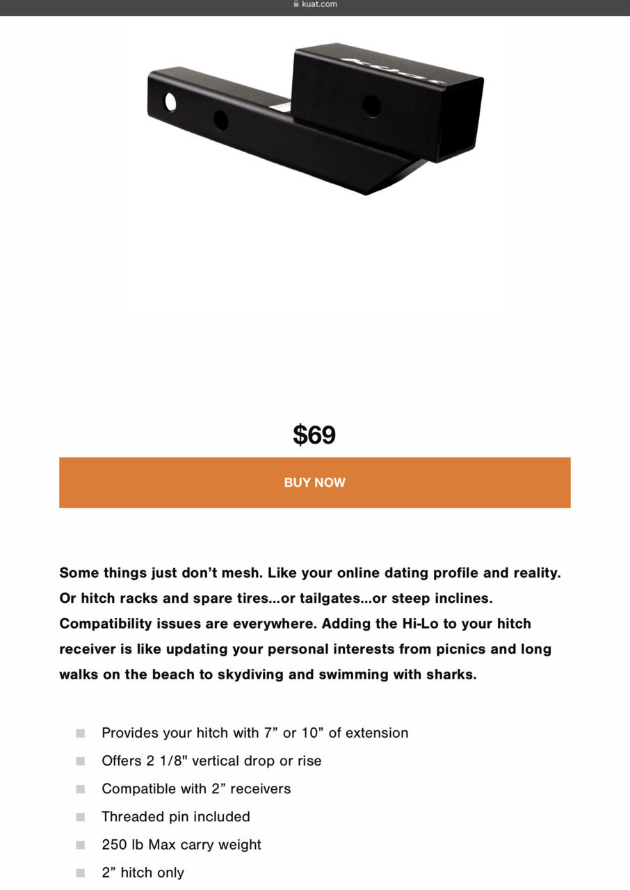

    The Kuat Hi-Lo should solve the clearance problem. Seems like it adds enough length to clear the tailgate and/or it can drop it enough to clear it.

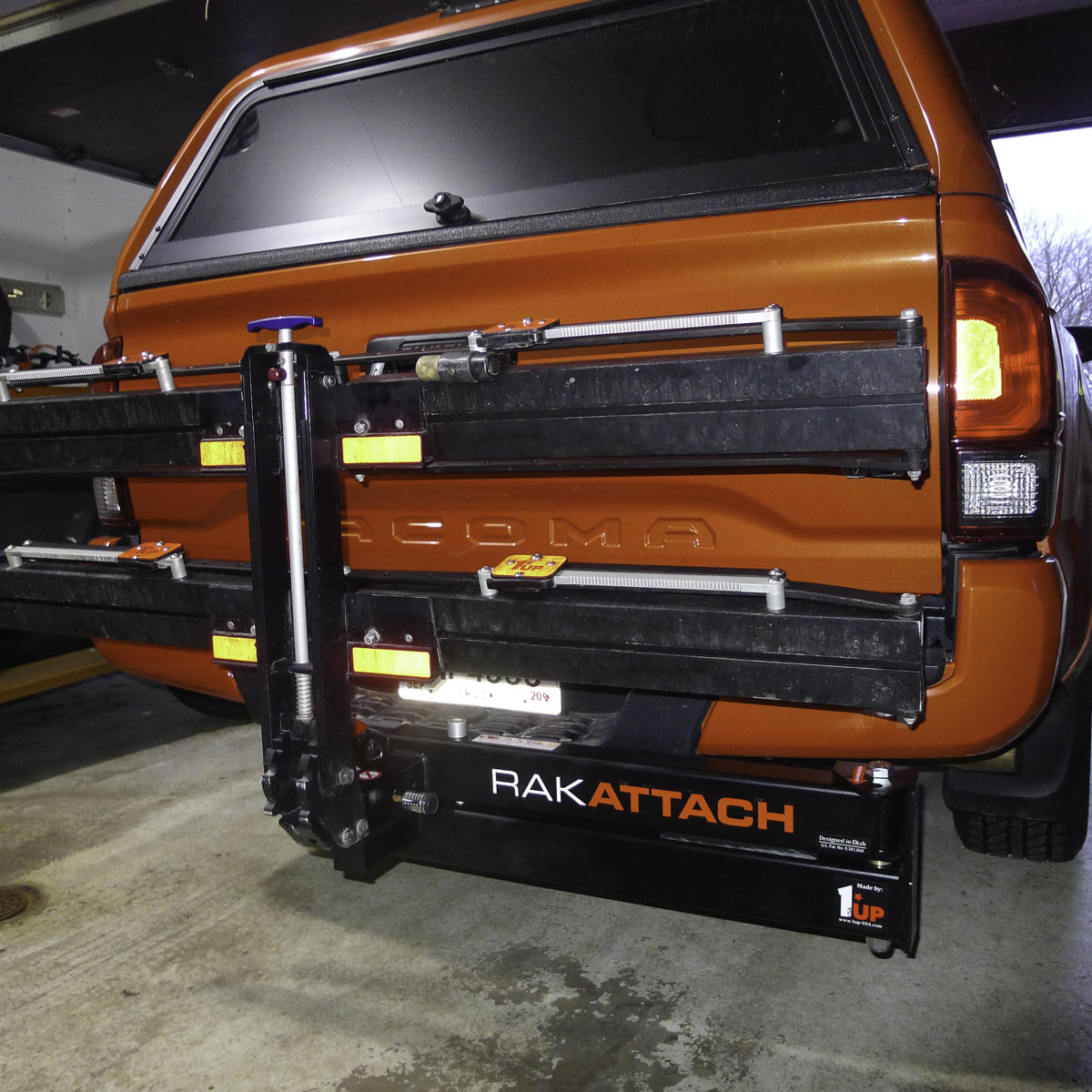

    My bikes go in the bed now but when I drove a cruiser I used my 1up double rack paired with the 1up RakAttach swingarm. It’s very heavy duty and swings quickly and easily out of the way for full access to the rear of the vehicle.
