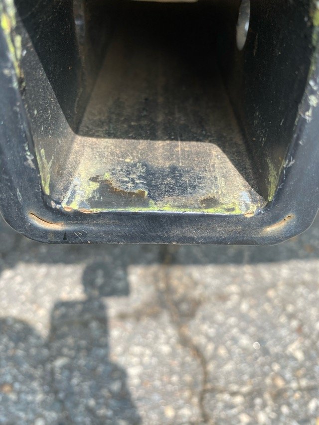

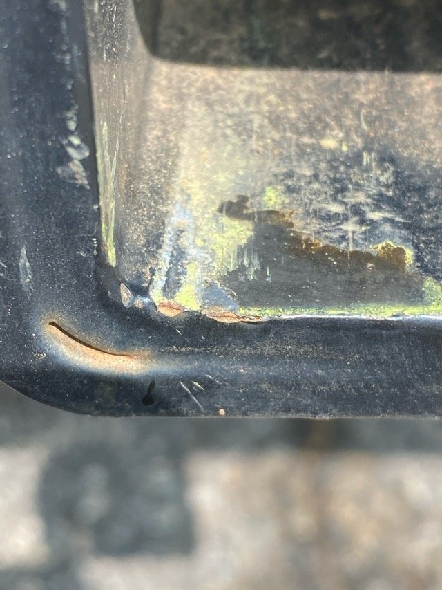

    Had mine burnt, blasted, and re-powdercoat painted 2 years ago. It’s got some rust/flake in the common problem area.

    I'll see if I'll grab a pic from my buddy that still owns the Jeep. I'm not terribly bothered with surface rust but this paint chipped right off. I was pretty surprised it didn't just slowly rub away like safety chain attachment points.

    2 years ago. Looks a hell of a lot better than mine - more evidence that Toyota's paint is cheap. Oh well. Guess I'm just fixing it up myself.

    I also think the chipped/flaked paint is more a function of hitting the opening with the shaft as you put it in. I try to be careful with putting it in, but I always seem to bang the edge of the opening on my way in. There's a joke in there somewhere.

    I keep mine absolutely loaded up with fluid film. No rust yet, and I use it a lot in the winter to tow snowmobiles. I'd scrape off the major rust, hit it with rust reformer and then black rustoleoum, and then just keep it properly coated and lubed with fluid film, woolwax, etc.
    The hood latch pin on mine flaked and rusted, all within a year and 18k miles. These guys can make fun all they want, but these examples are some hoopty-level lack of QC on Toyota's part IMO and I agree with you. These trucks aren't $25k new, mine stickered at over $40k, and I don't think that kind of chintzy shit is acceptable at that price point.

    I doubt Toyota makes or paints the trailer hitch. Time for a repair and more fluid film.

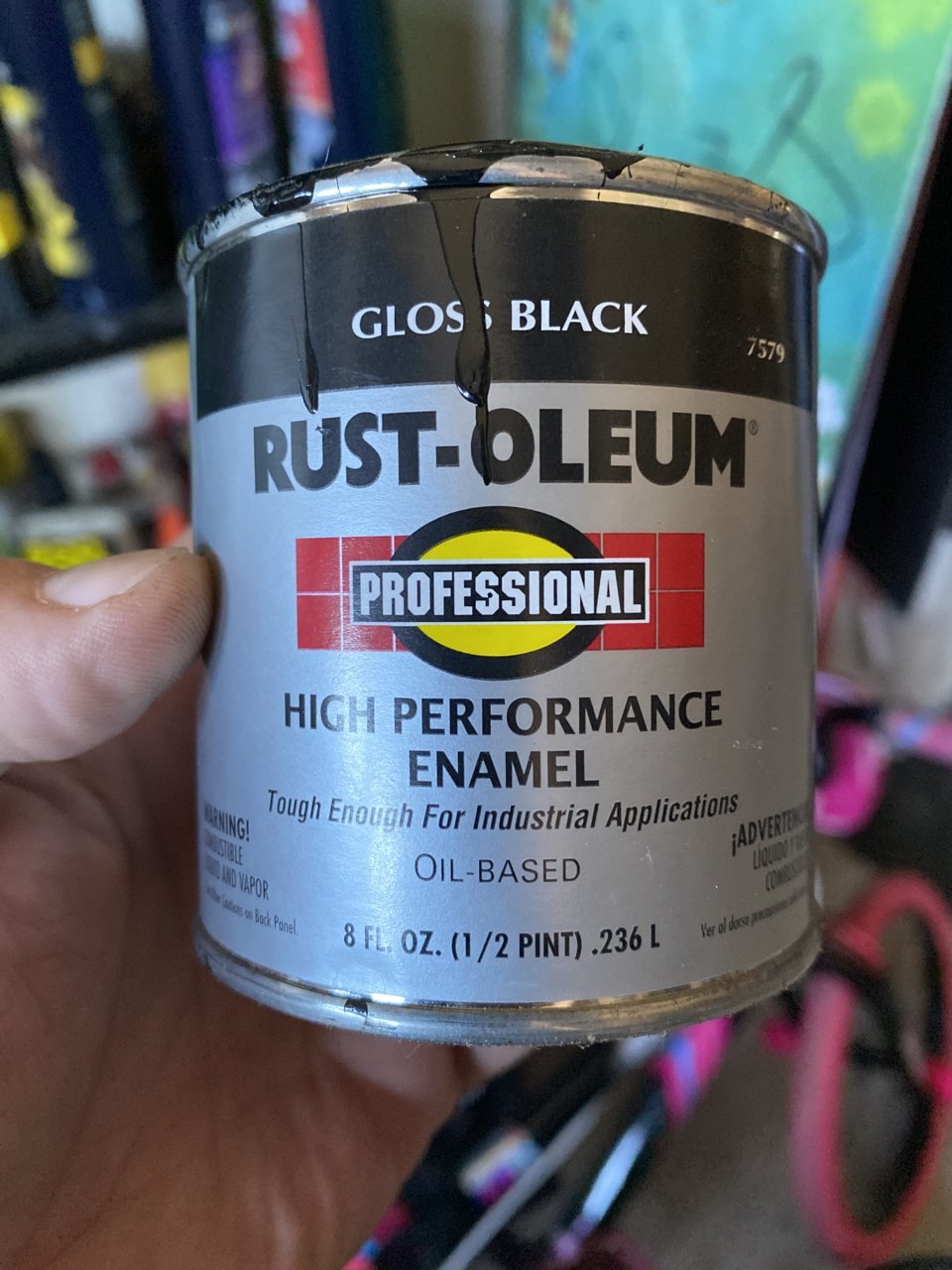

    I use this with a brush on the hitch, sliders, armor, diffs, etc...fast and easy.
