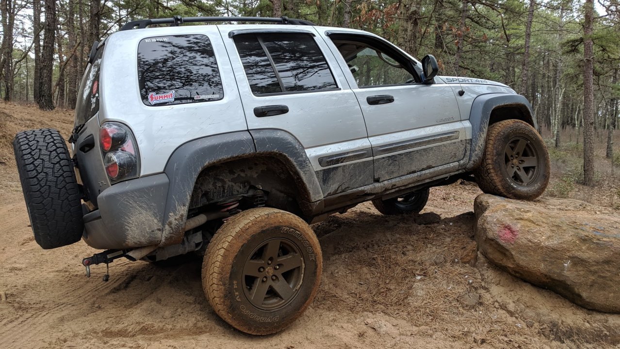

    Hey I had a Jeep Liberty for 11 years. I had the CRD(diesel) with a 2 inch lift. I went to Rausch Creek off road park with a group from the local Jeep shop. they all with lifted Wranglers that were mostly mall queens snickered at the Liberty. when we got there the group split up. I went with most of the stock and lightly lifted Jeeps to go in green and moderate yellow rated trails. I did everything they did and was even showing the NOOBs how to drive better offroad. those Liberties have more capability than given credit for. The downside is very little aftermarket support and for the diesel parts and people that can work on them if you cant yourself. the Liberty pic caught my attention and distracted me.
