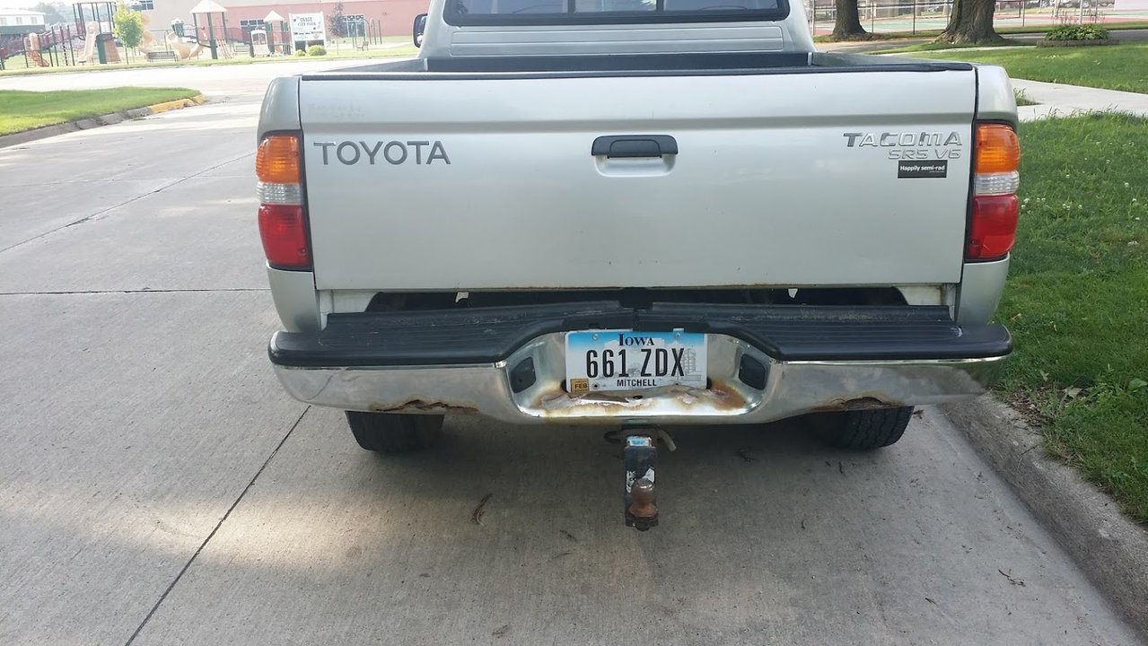

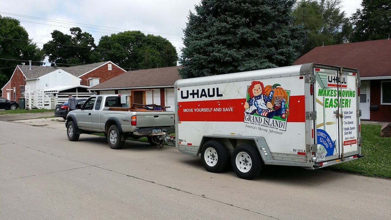

    I bought my 2001 Tacoma 2 weeks ago. The dealership had it sent in for a frame replacement after taking it in on trade from the previous owner. Since the truck has a receiver hitch, I used it to pull a 12 foot Uhaul trailer last weekend.
    kavR7yL4O6b193DIfeud0-_32RZW4kwAed_BL8Vs_62c8cc53aa83f75635b60c7dfebb0d18733ef7c0.jpg
    After I dropped off the trailer, I noticed the bumper and hitch were sagging a few inches lower than before.
    bAef7MjQCGy_gdvypTBGTlJrWo8PN8WE48QTz2PN_0c059be31494b7086db02876e2c1f1154e89c3b9.jpg

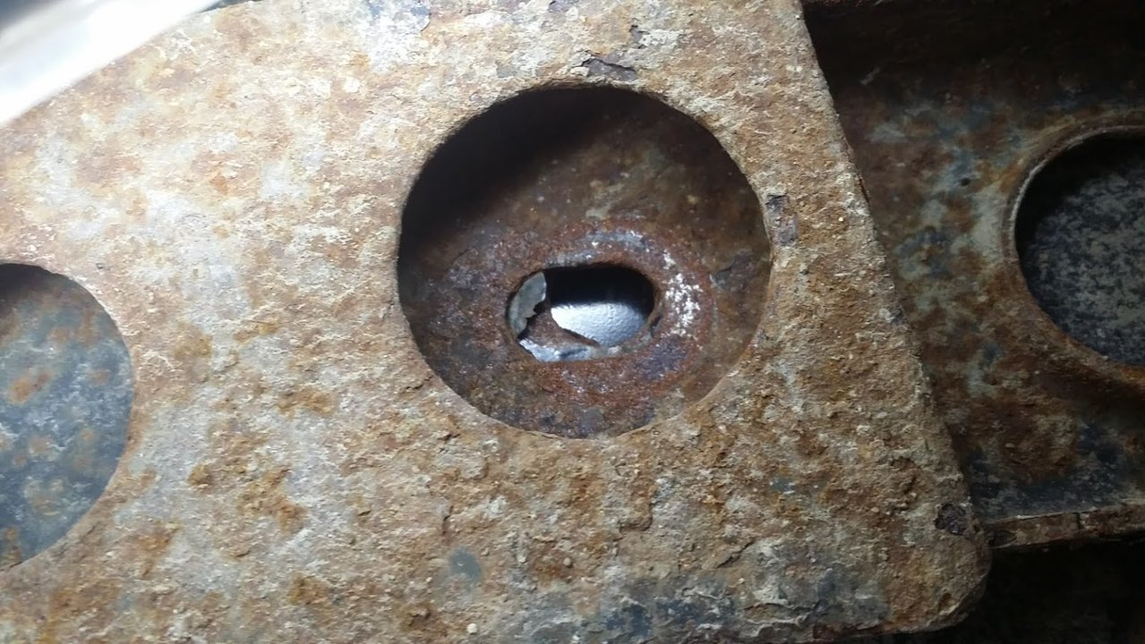

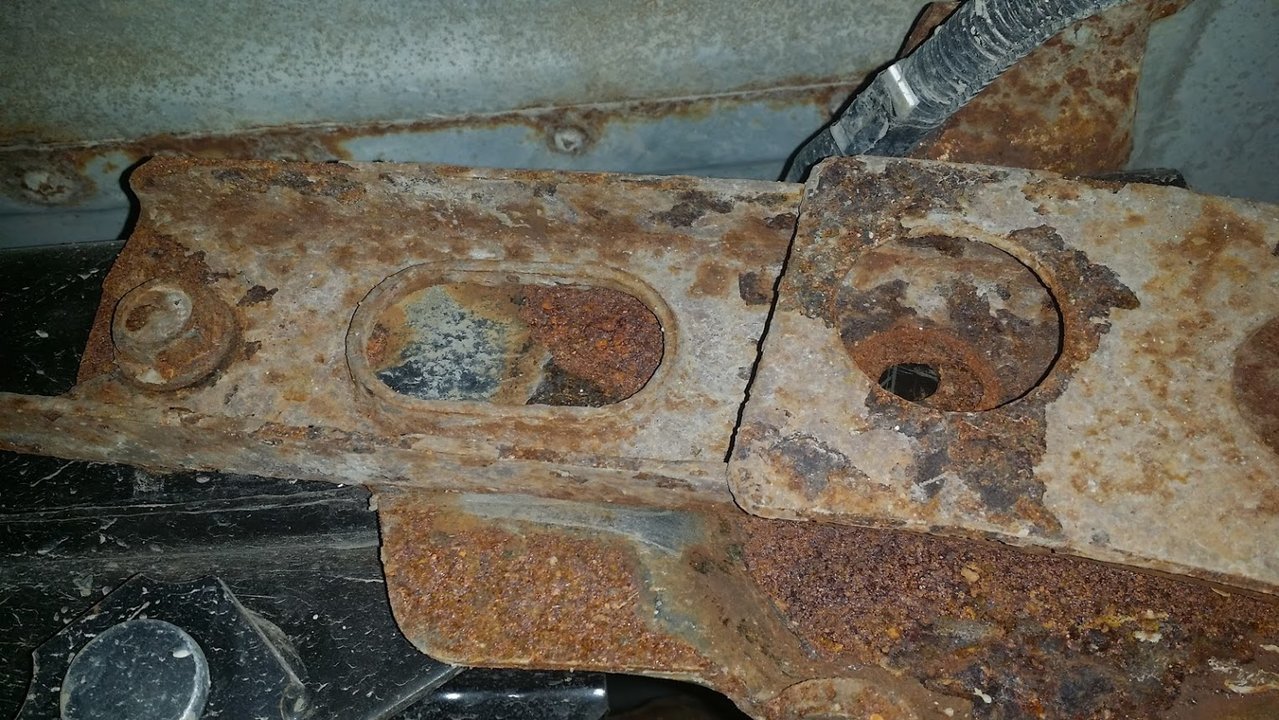

    I looked it over and either the dealership or Toyota forgot to put in the 2 rear hitch bolts that attach the hitch and bumper to the frame. The hitch pivoted down and was held in place by the welds at the rear spring shackles.

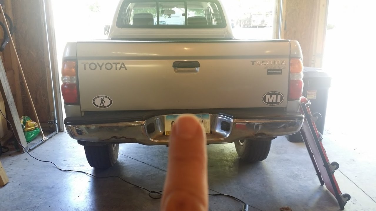

    I jacked up the hitch and bumper to align the holes and installed two new grad 8 bolts. It's good now but I'm just glad it didn't come apart pulling the Uhaul for three hours last weekend.

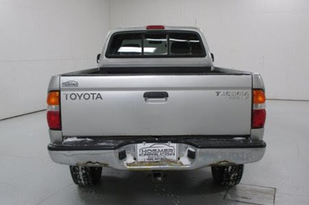

    Photo from Dealer site before I bought the truck

    From the looks of that hitch its not to far behind the frame in the rust dept. I would look into replacing it before towing anything.
