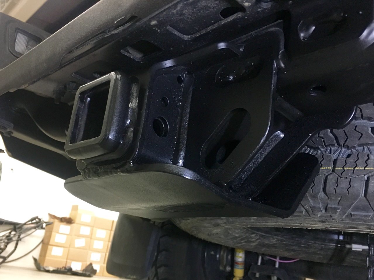

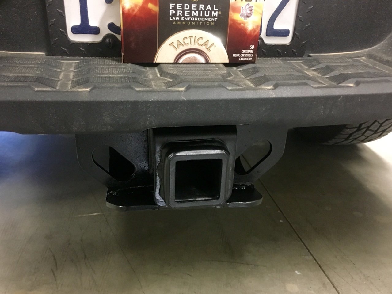

    A skid plate for my hitch. To help it slide when I bottom out on the hitch 4 wheeling. So I used a pic of 5/16" steel I had laying around, bent it and welded it to my hitch.
    I'm not losing any ground clearance with this design and I still can use my tow hitch

    Actually, this looks handy. Didnt think it'd be an issue, but it was a few weekends ago. Nothing a few whacks and some spray paint to get the chain loops close enough.

    Got some photos of that ? Just mostly curious about it.

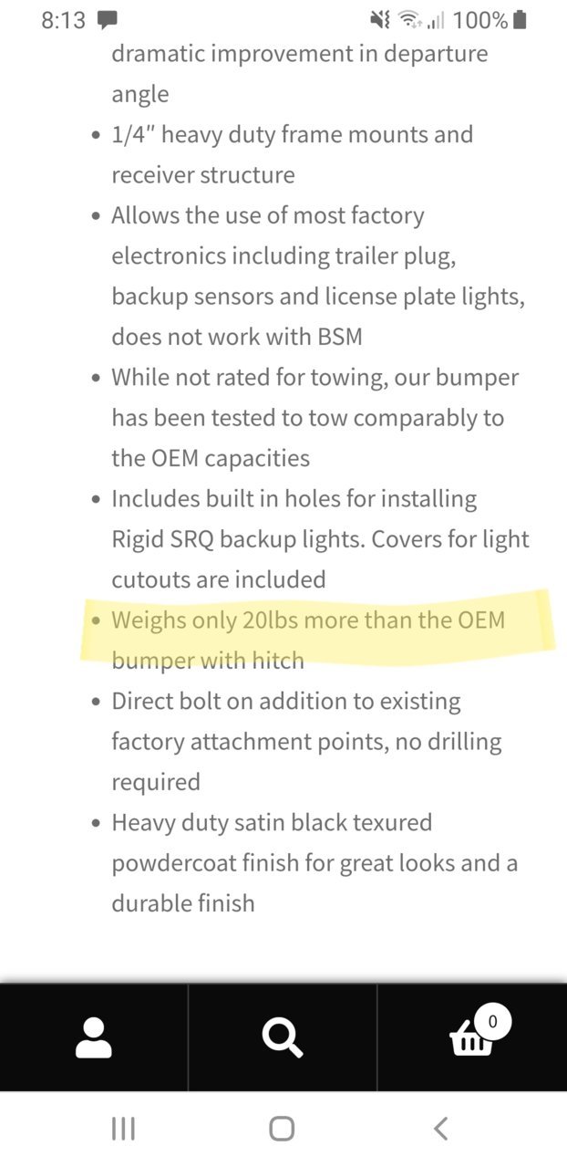

    I've taken one off on a previous gen. It was maybe 50lbs? I don't know if it changed for the 3rd gen, but surprising if it's within 20lbs of a plate bumper.

    From their website...
    https://rcimetalworks.com/product/2016-tacoma-rear-bumper/
    I ordered mine from truckbrigade.com
    Free shipping and no tax collected. @Truck Brigade has awesome CS too.

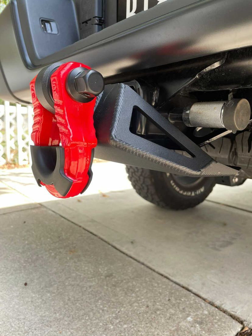

    DRT hitch skid Dclb over here
