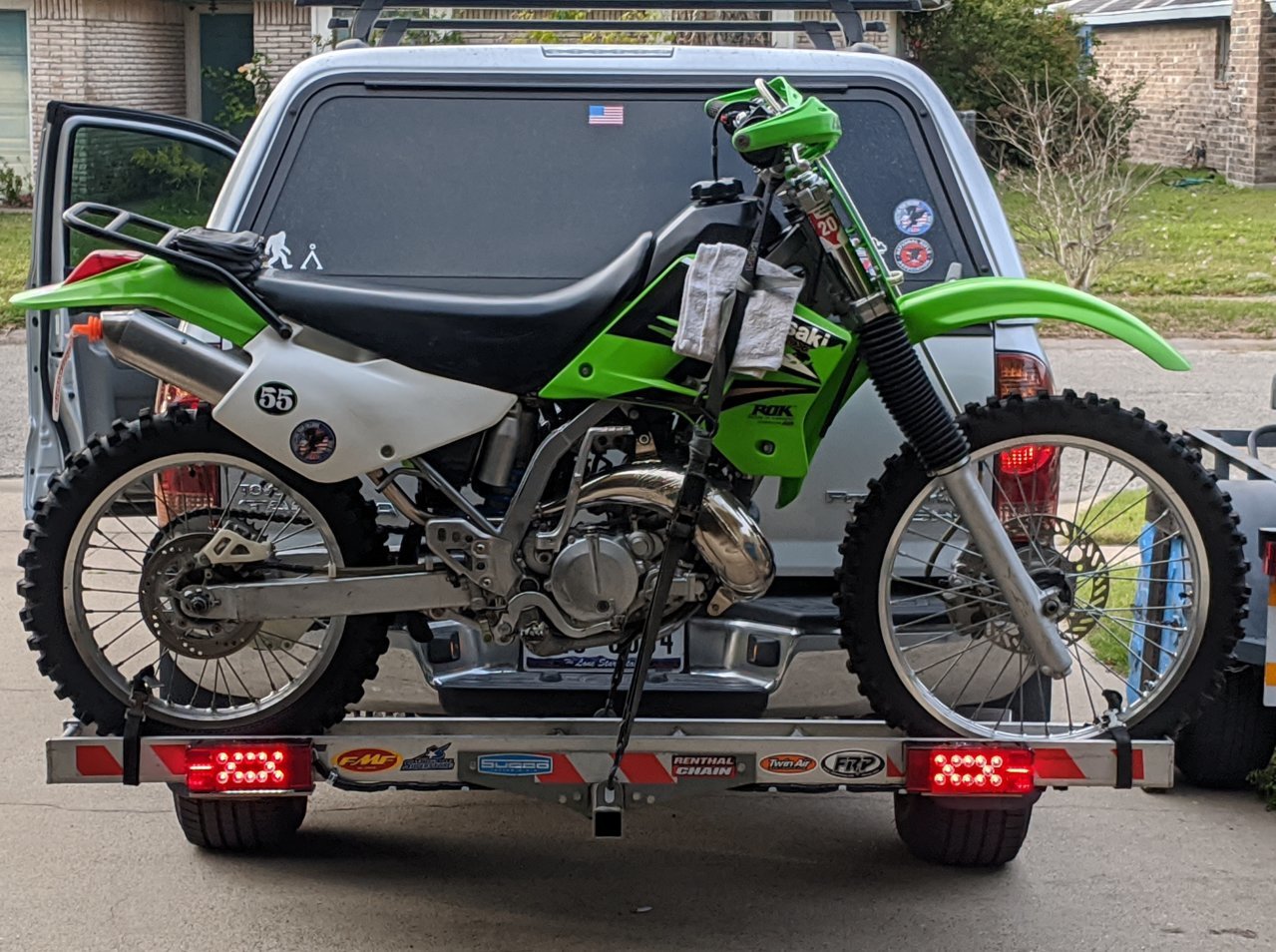

    The tubing that goes into the hitch for the carrier would have be lengthened to allow for the rear tire and the handle bar that faces the truck. Besides making that tube longer, I would think you'd have to make it stronger too. Then the tie down tab on the inside of the carrier, along with cinching the tie down strap may be a pain to get to due to the tire.
    Question, will the tire be mounted in the center or off centered? If off centered, then have the bike load up with the handle bars on the opposite side for a little more room.
    Here's my Rage carrier

    Offset will work. Getting to that inside strap is a little bit of a hassle. I use a zip tie on the hook for the tie down tab to keep it from falling off while straping down the bike. Some have carabiner style attachments for the tie down points which makes it really simple. I also lean the bike out a little when strapped down so I can open the hatch on my cap. It doesn't open all the way, but just enough to put the ramp in.
    You will have to remember you're putting the weight a little further back, which (to me) is really no different that hauling a trailer. However, the bouncing and swaying of the bike will be exaggerated. You may have to come up with some additional bracing to help eliminate or lessen that exaggeration.
    Thanks for the compliment on my 2004 KDX220R. Bought it for $500 this time last year, tore it down and went through the bike front to back. Yep, 2 smokers are on the way back.
    Loads of fun!
    Here's what else I carry on my carrier, a 2010 KLX 250 with a 331cc big bore kit, FMF megabomb and Q4 silencer.

    Not an exact measurement, but my fat ass can get between the bike and tailgate, especially between the back of the bike and the tailgate. And remember, I lean my bike out a little bit to I can open the rear hatch on my cap.

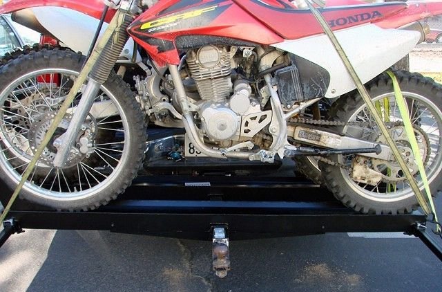

    I haul 3 bikes wide in the bed and one on my hitch hauler. i have the 2 bike hitch hauler from harbor freight. b/c the tailgate has to be down to fit bikes in the bed, i can only use the farthest aft position for the hitch hauler.
    So what you should do is get a 2 bike hitch hauler and remove the forward ramp. now you will have an extra long tongue hitch hauler giving your tire carrier room. OR you can just get a normal 1 bike hauler and use a tongue extender...
    Fyi it is a lot of weight far aft but the truck handles it like a champ
    My buddy does the single/extender method on his Rubicon because of the tailgate mounted tire. works great

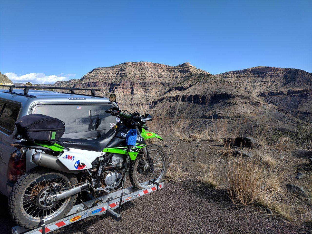

    You'll definitely need to upgrade your suspension. I carried a pig (DRZ400) on a hitch carrier with no problems (OME Dakars on the rear and I've got an ARB and winch on the front to add some weight up there) but I wouldn't want to add a spare tire and move that weight out much further. I also wouldn't want to try anything much more than forestry service roads either, too much movement even though I had a clamp on the receiver. I have a camper shell too so I had to lean the bike outwards slightly to make sure that it had some room to move without the possibility of striking my rear window.
    If I were going to do it again, I'd probably build a dual receiver hitch setup and carrier; I've seen a couple that folks built and they were a lot more stable. They welded a receiver stub outboard of the regular center hitch and the motorcycle rack had two tongues instead of a center one.
    On a semi-related note, I added thin profile trailer lights to the hitch carrier as the bike made it difficult to see the rear lights, especially from certain angles.
