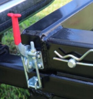

    Some actual factual information. It appears that the most likely weakest link in this swing out is the latch for the swing out.
    The hitch pin that's visible is 5/8" thick. That puts the latch somewhere around 5/16" thick (x2). The latches striker looks to be about 1/4" (x2).
    The maximum weight on the swing out is 250 pounds. The most likely scenario of that latch breaking is when forces are applied directly to the striker. That 1/4" thick striker is doubled up and is probably mild steel and not hardened. That puts the striker's shear strength somewhere around 5800 pounds. A 250 pound load on that swing out that is attached to a vehicle traveling at 65 mph is around 5100 pounds of force.
    There are many other factors that come into play. Factors like gravity will further reduce the stress placed on that striker. Check out Newton's Laws. There simply isn't enough information to create concrete proof that it will or will not break at its rated capacity.
    But without factual statistical information anything else is just opinion and is based on absolutely no facts.
    My opinion is based on the manufacturers capacity rating because that's what capacity ratings are specifically for. Idk why there seems to be confusion on that extremely simple to understand fact.
    One thing is for sure, some opinions on TW are far weaker than that swing out's striker. Lmao

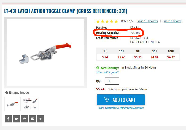

    A far cry from 5800lbs.
    Just because it's rated at 700 lbs, that doesn't take into consideration leverage, shock loads, and side loads. Now, there's also a hitch pin holding the swingout from swinging out, but it's still of my opinion that the steel structure could possibly fail long before the latch and hitch pin, and it's simply not worth it to gamble a $2K+ bike on a $159 swing out.
    How's that for factual information?
    Oh, and in case you dig up the 2000 lb rating for this clamps bigger brother, the bigger brother has a mounting plate that is 2 1/2" tall. It's obvious from the pic of the clamp on the 2" tubing that they are not using the big brother clamp.

    That clamp isn't near strong enough, not even close. Yes it's great factual information, unlike the swing out.
