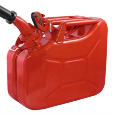

    I’m looking for a hitch basket that I can use for hauling Wavian cans and other things. I probably will want to get at least 150 pounds in it.
    To be clear, I’m looking for one of those baskets that hangs freely off of the hitch.
    I do get in and out of the bed a lot, as does my dog. So I’m looking for something that:
    A) doesn’t interfere with opening the tailgate (with a wavian can on it vertically)
    And
    B) terminates before the edge of the hitch so that I don’t have to lunch over it when getting into the bed.
    does anything like this exist?
    tldr i dont have a roof rack and need extra storage but need to be able to easily get in and out of the bed, so looking for a low profile hitch basket that fits under open tailgate

    Are you willing to go with the 2.6 gallon Wavian cans? Same base dimensions as the 5 gallon, just 6 inches short (12 vs 18 inch height). If you actually were hanging full size cans under the open tailgate you'd have next to no departure angle, probably leading to regularly dragging it when leaving driveways, parking lots, etc (unless your truck is already seriously lifted).
    I don't have a specific rack to suggest, but this would definitely give you a better chance of finding something off the shelf. Still might not be SAFELY possible without going custom.

    Open your tailgate, and measure how much vertical room you have static (at rest, no load) from ground to tailgate. Now measure again, with your proposed load weight in the bed/truck (include proposed weight of fuel + wavians, and rack - don't forget your weight and weight of dog too). Now subtract the height of the wavians, and a couple theoretical inches for whatever platform you may need to carry those wavians, from the loaded weight height of tailgate to ground.
    Now factor in suspension movement, and approach/departure angles due to added length from platform.
    Is there enough room? Safely?

    I was just picturing a custom rack in my head, that sits at bumper height for travel but could be lowered to below open-tailgate height would probably be the safest option. Dunno how you'd leverage that weight up/down 'on the fly' though, as unloading and reloading the wavians & other gear from the rack just to raise/lower the rack kinda defeats the purpose...and at ~40lbs per full 5gallon wavian, well, at least you'd get a workout every time you stopped to setup camp.
