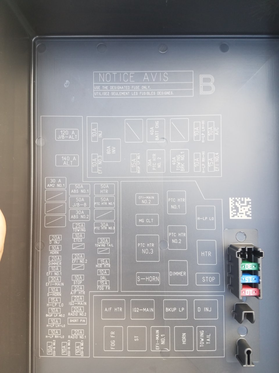

  12. Apr 20, 2019 at 10:17 AM
    FastEddy59
    FastEddy59 TTC #0061
    Jan 20, 2017
    #208155
    24,453
    Eddie
    '13 Barc. Red Tacoma SR5 4X4
  13. Apr 20, 2019 at 10:20 AM
    johntoyota
    johntoyota "I'm higher than you'll ever be." -Treetop
    Mar 11, 2016
    #180956
    5,249
    John
    Down yonder in TN
    16 truck
    To summarize the important part:
    "The Alt-S circuit is the circuit used by the voltage regulator to monitor voltage at the battery and adjust accordingly. You can read more on the Toyota Alt-S circuit here. This simple mod is only works in vehicles where the Alt-S circuit exists for the voltage regulator to control the voltage. In some newer vehicles like the 2017+ Tacomas, the voltage is regulated by the ECU, meaning no voltage regulator Alt-S circuit to spoof. "
