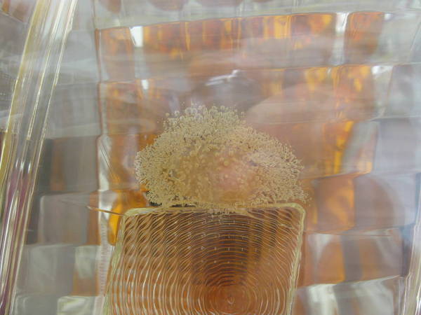

    The problem with this is that it will eventually melt the turn signal lenses. So, if you want to do this and not melt the lenses, then you need LEDs. However, if you just swap in LEDs, and do nothing else, you will get hyperflash. There is no available LED flasher for DRLs. So, then you have 2 choices. Install resistors at the turn signals, or modify the factory DRL flasher.

    how on earth would it melt the lenses... its just a bulb

  8. Dec 6, 2018 at 2:46 PM

    Very common problem..

    weird I've never seen that happen

    It happens to almost all 2nd gen tacos.

    Yup happened on my 11, but only one one side???
