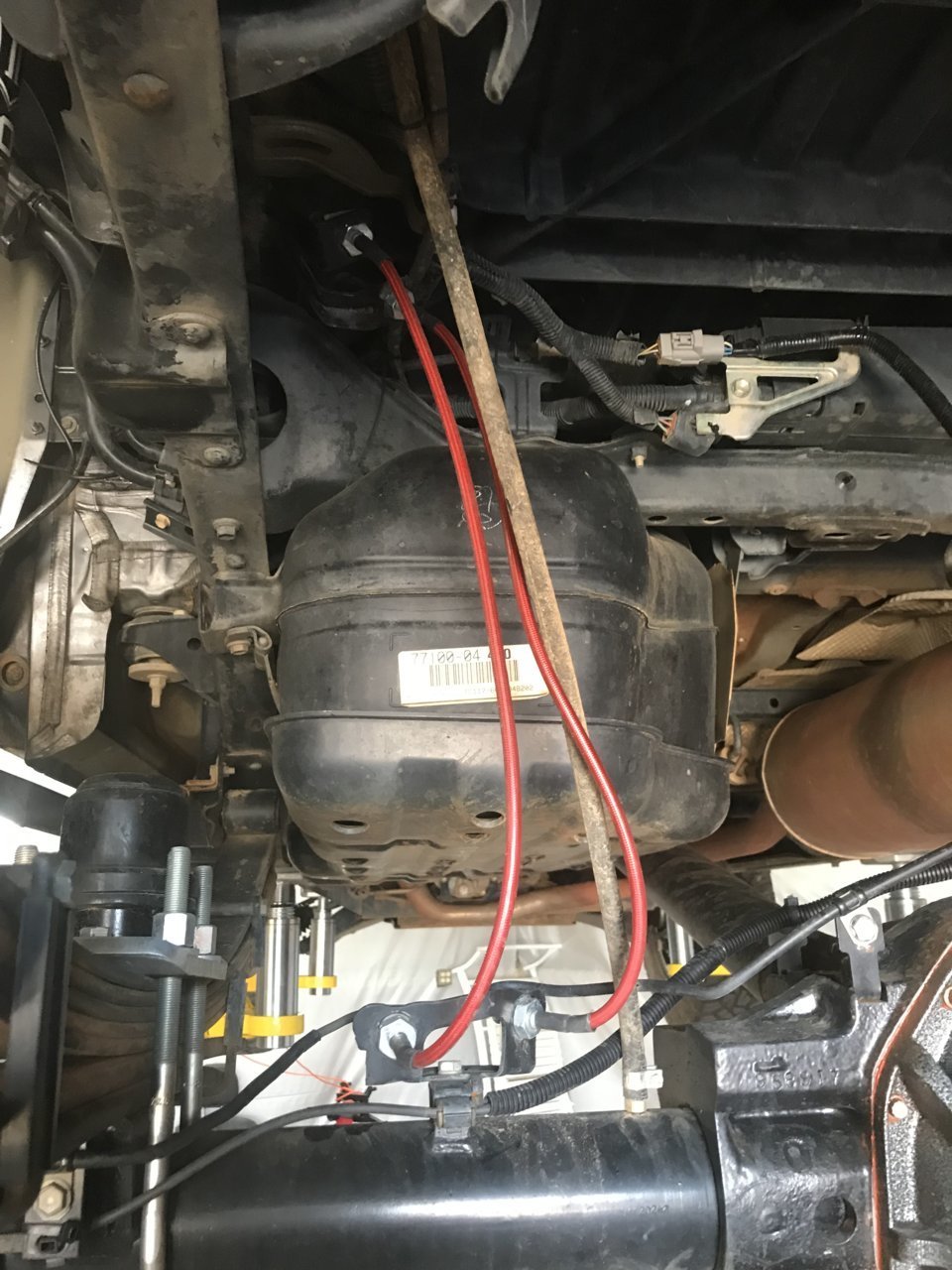

    @hoarder23
    What length brake lines are you running in the rear?
    I have +3 and I dont' think they are going to work once I have the new hangers on the truck.

    I have a set of All-Pro +4 on the rear with plenty of room to spare. You should be fine with +3.

    The +3 that I have on the truck now are almost stretched to max when we put the truck on the 4 post lift. They can prob handle another half inch or so... but would need to put some spacers on the bottom mount where it attaches to the axle and then try and get extra out of the hard line.
    Talked to Wheelers and they can get me a set that are 26" total made and shipped out and I think @Naveronski may want the ones I have since I said I would install them at Jambo for him.
    Since brakes are a pretty important part of a vehicle... I would rather not pop a brake line if I flexed to much. Since the shocks were at 10" when the brake lines were pretty much maxed, add in the new hangers and it would be pushing the brake lines more than I would want to.
