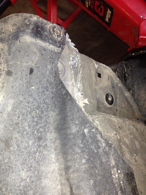

    Oh alright thanks. I didn't know this going into to it and now I'm kinda realizing there's more to this than just simple steps. How do you trim the pinch weld?( yes it's a stupid question as I am a beginning builder)

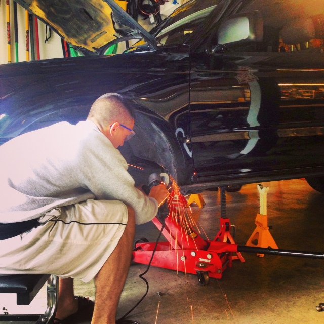

    Let's see... Eibach coils were $180, Expo leafs were $400, new Bilstein shocks all around were $320ish, U-Bolts were $10 each(x4), Extended brake line/BAMF BPV relocation was $30. Soooooo like a thousand dollars lol. && that's not including shipping/installation of coils (in my case)
    Pinch weld is on the front wheel well on the inside of the fender flare behind the plastic closest to the cab... here's a pic of it & me grinding mine off, hope it helps:

    That helps A LOT thank you. I totally had no idea. I'll have to go see what I can do up at our college and change that. Do you just weld it with a mig welder once you grind it?

    Ginder isn't necessary. Just use a BIG hammer and pound it flat.
    As has been said, those 33's will tear up your fenders without a lift. You'll still need to trim after the lift but I wouldn't put the 33's on until the lift is done.
