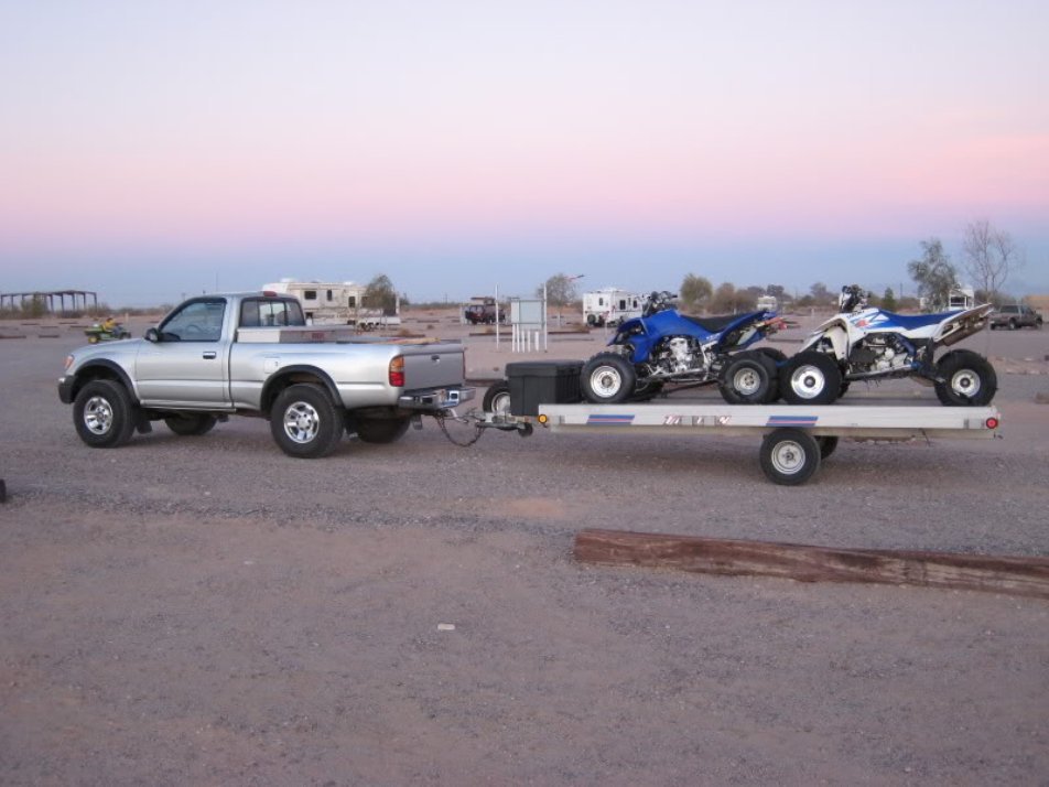

    You found the twin to my old Gen 1 that Toyota purchased back due to frame rail rust. Had just about 200K on it and was the best vehicle I've ever owned for problem free miles.
