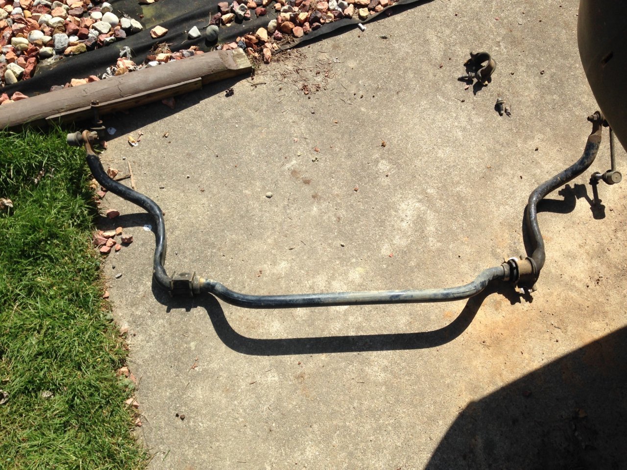

    Spacer Lifts are bad yo.
    Bye Bye to this

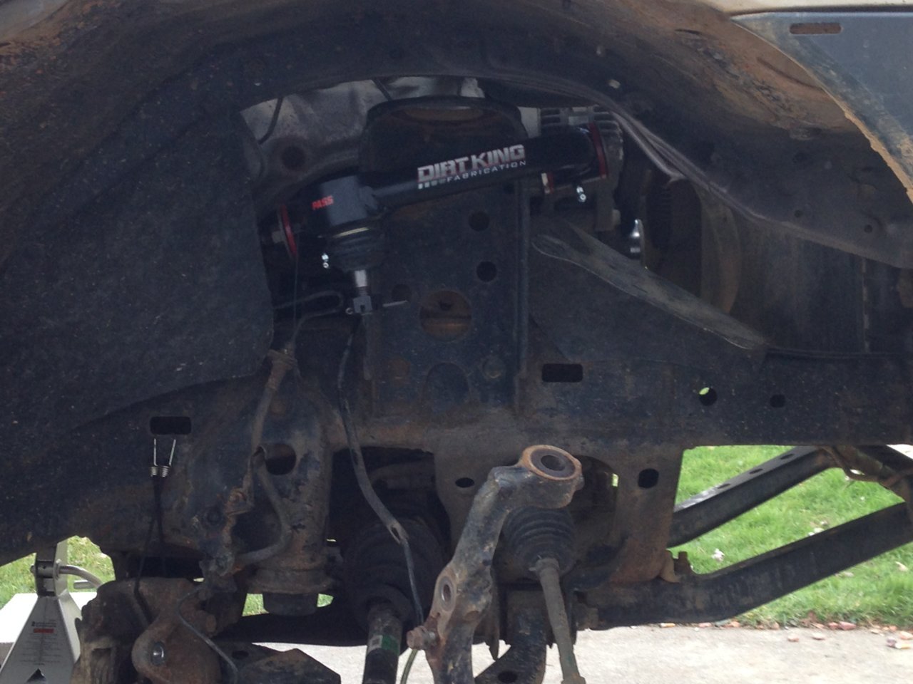

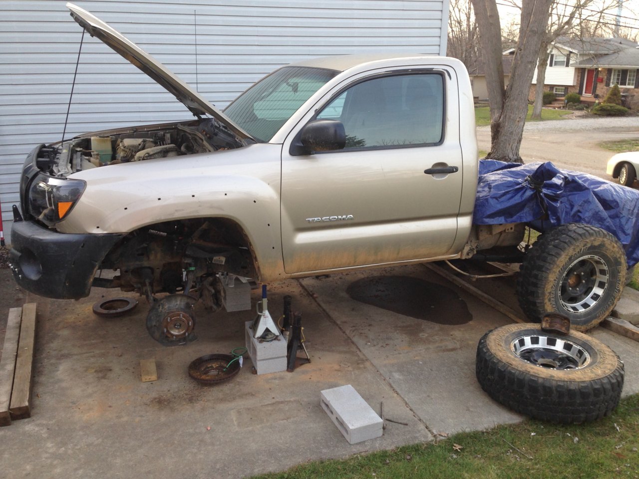

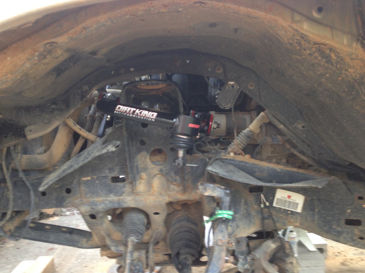

    Was nice enough out Sunday afternoon to get out and do something. D/S suspension is apart. I love Toyota, we always get along so well when I wrench.
    Taking note of other things that need to be addressed as well:
    -Front Brake Job - Pads/Rotors
    -Front axles - interior boots are both torn. Replace boots or CVs
    -New spindle/CV seal. Found the metal spring ring in pieces when I took the CV out.

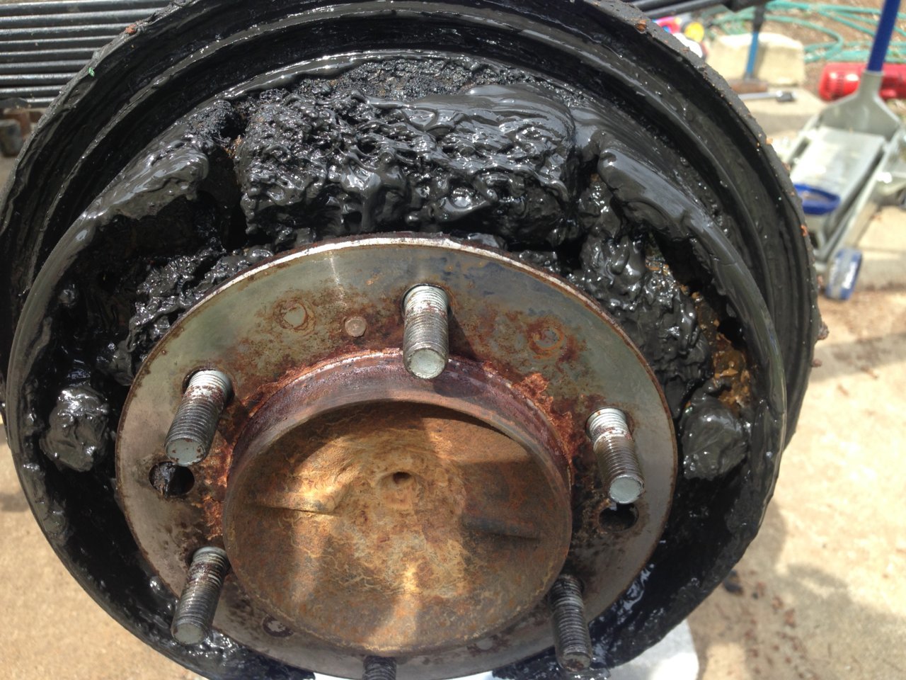

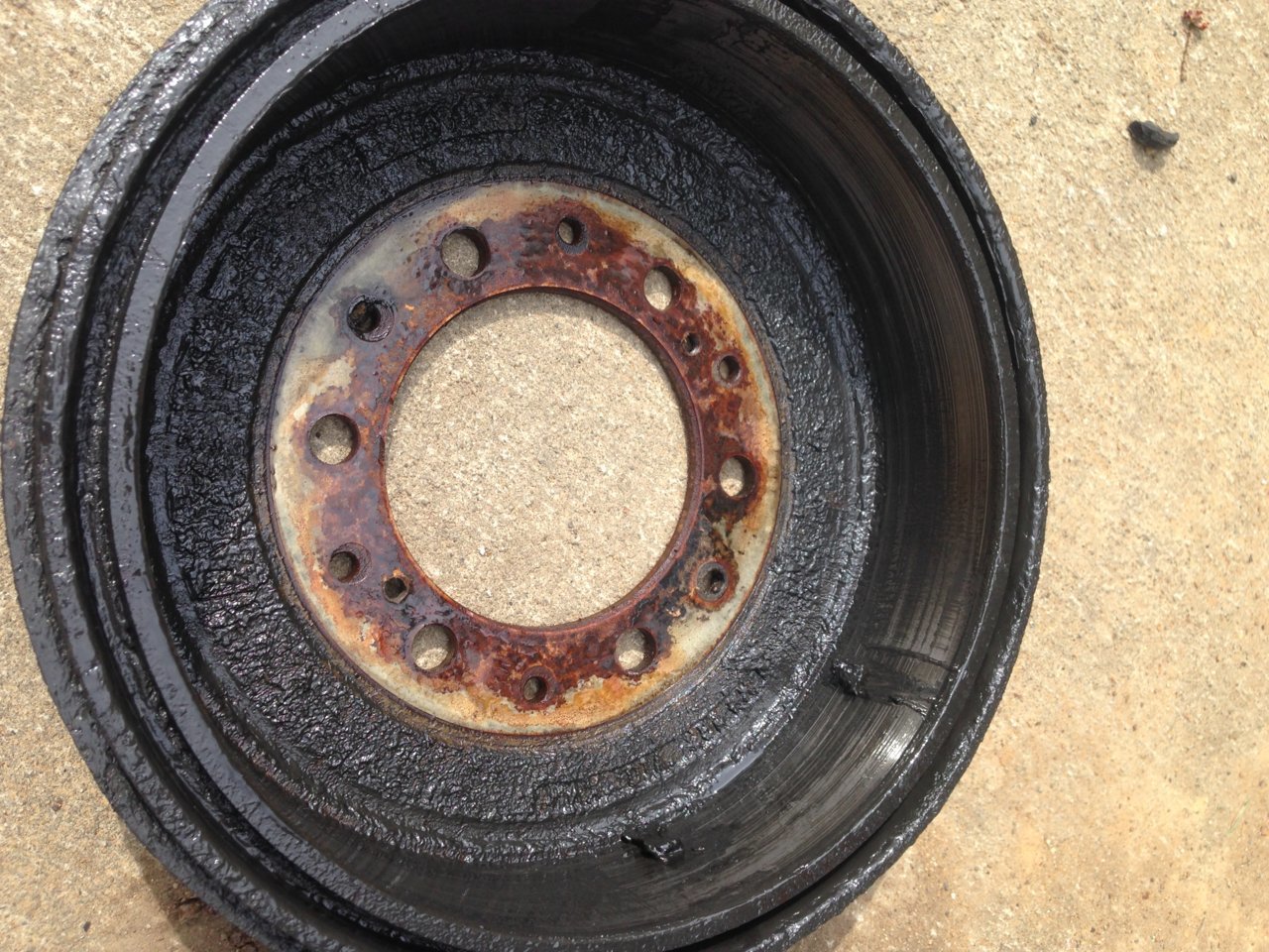

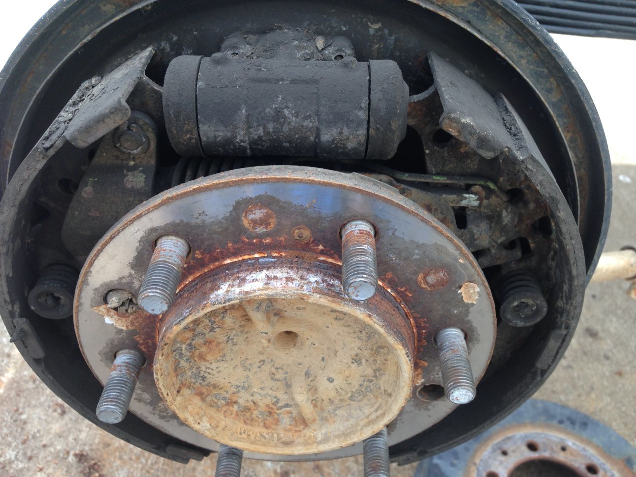

    Pulled the rear wheels this morning.
    I knew I had problems before I even put the jack under the rear axle to set it on stands.
    Some time ago I noted a leak from the driver rear drum.
    Even I was surprised by what hid behind the drum. Rear axle seal is leaking. Slung diff lube all inside the drum. Drums gets hot. Turned everything to sludge.

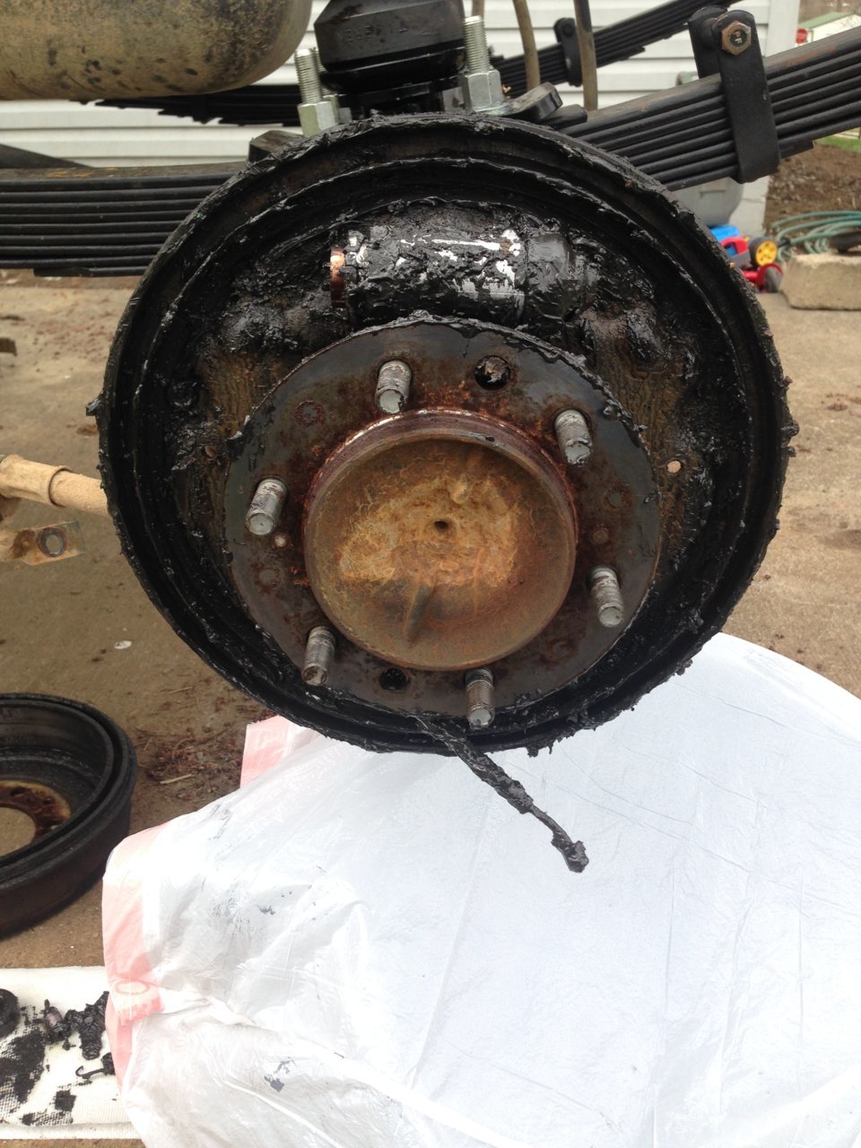

    How lovely. So gross. What a mess.
    Totally could reuse this. :rolleyes:
    Oh, its supposed to look like this.
    Neato, the right tools for the job.
    1/2 a roll of paper towels later.

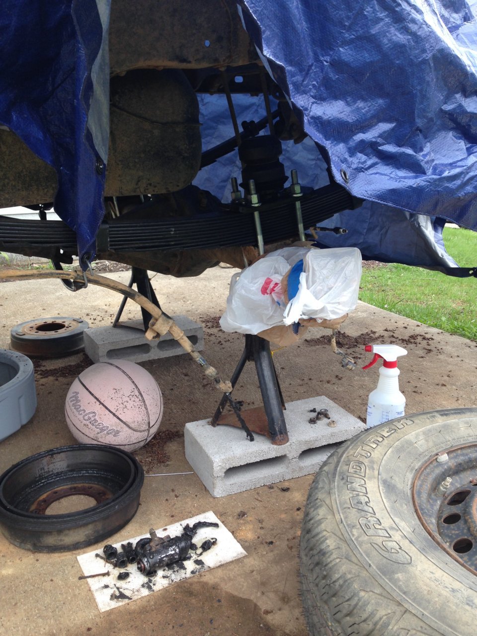

    The biggest pain of the whole situation was getting the caked in grease brake assembly apart.
    Cleaning it up. Pulling the axle, replacing the seal, replacing the brake hardware and shoes is the easy part, to me anyway.
    Most people go "Yikes". I go "meh, it's all parts"

    Looks pretty thick. Parts cleaner help any?
    The drum didn't look that bad from the pics too
  16. Apr 15, 2018 at 8:38 AM
    #336
    2TRunner
    2TRunner [OP] Snoop Dad
    Jul 30, 2010
    #40980
    4,226
    My House Usually
    Had half cans of carb cleaner and brake cleaner. Used it up. Carb cleaner worked better.
    Rain came in Saturday afternoon. Hasn't left yet.
    No sense in keeping the drum. Personal preference. Drums are cheap and I want something a little beefier anyway.

    I agree about the drum. They were gummed up, but looked okay. I'm sure there are some grooves not seen in the pic

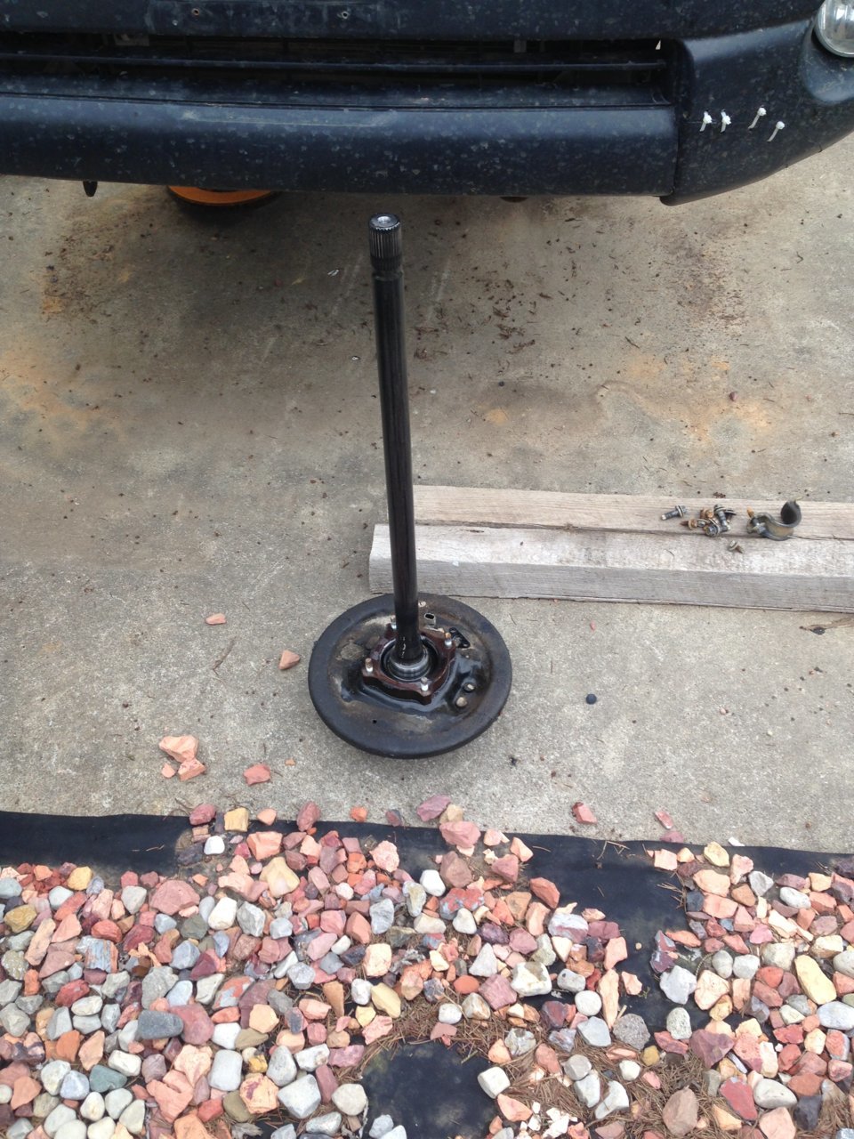

  19. Apr 21, 2018 at 2:38 PM
    #339
    2TRunner
    Jul 30, 2010
    #40980
    4,226
    My House Usually
    Pulled DR axle today. The hub/bearing assembly will need replaced. The mess from above and gear lube had started to pool on the pavement under the DR tire from the leak.
    Ordered a new bearing, new brake shoes and a brake hardware kit from RockAuto. Will just take the axle shaft and new bearing to either Toyota or a driveline shop I am familiar with to do the swap. Will replace the axle tube seal too.
    Hopefully the start of getting it back together.
    https://www.rockauto.com/en/moreinfo.php?pk=3065214&cc=1434688&jsn=8
    https://www.rockauto.com/en/moreinfo.php?pk=1021647&cc=1434686&jsn=17
    https://www.rockauto.com/en/moreinfo.php?pk=1857746&cc=1434686&jsn=9
