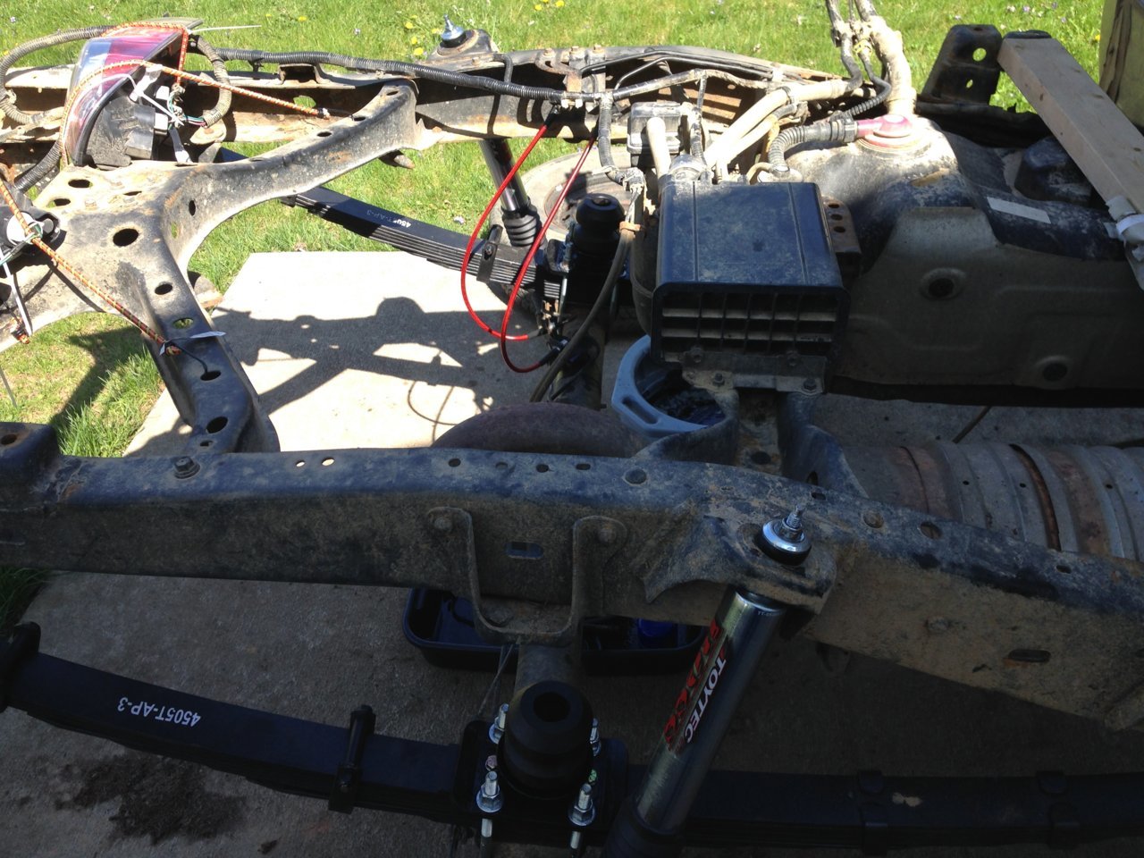

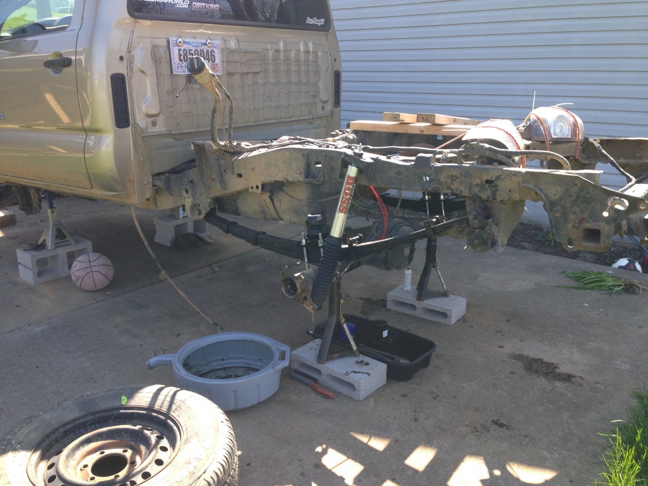

    Extended brake lines and rear shocks are on. Picking up the rear axle shaft tomorrow.

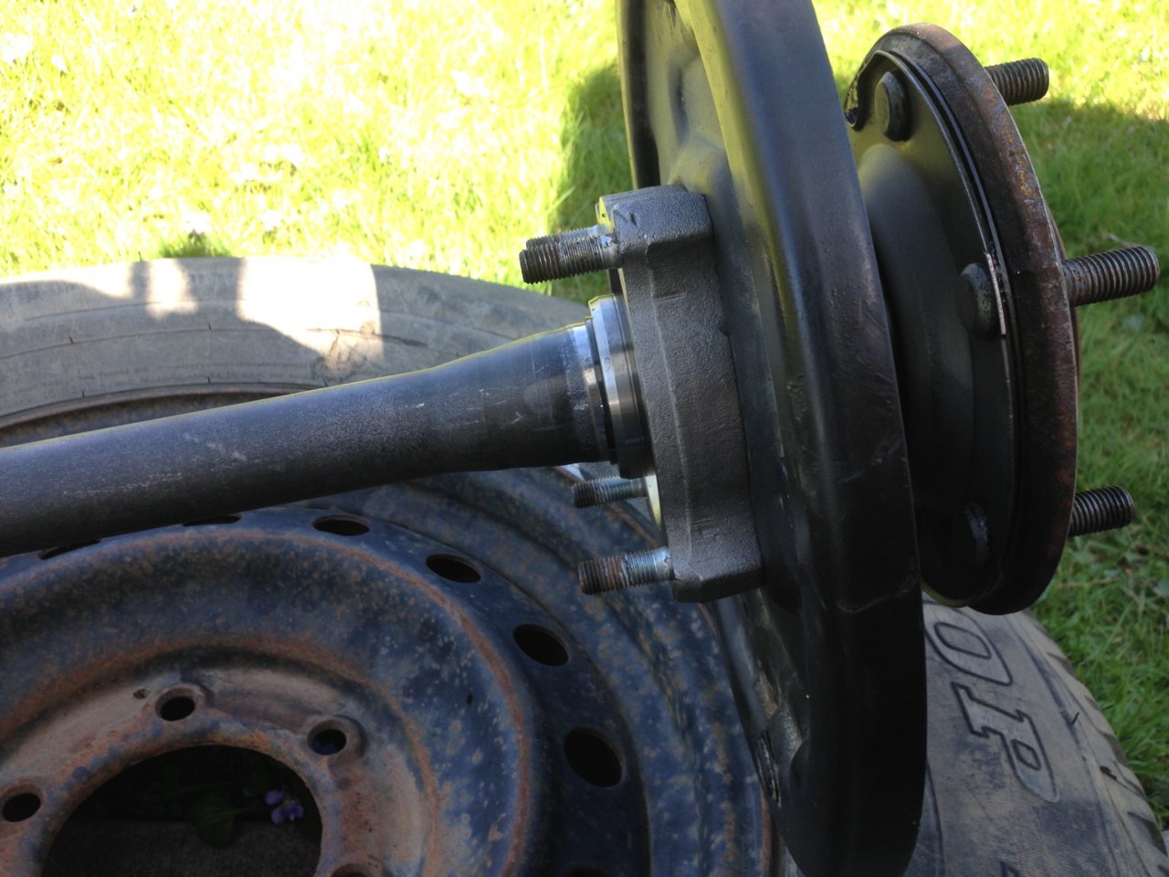

    Like I said, pick the axle with a new hub tomorrow. Also pick up a new axle oil seal as well. Get that stuff on, get the shoes on and will only have drums left to get.

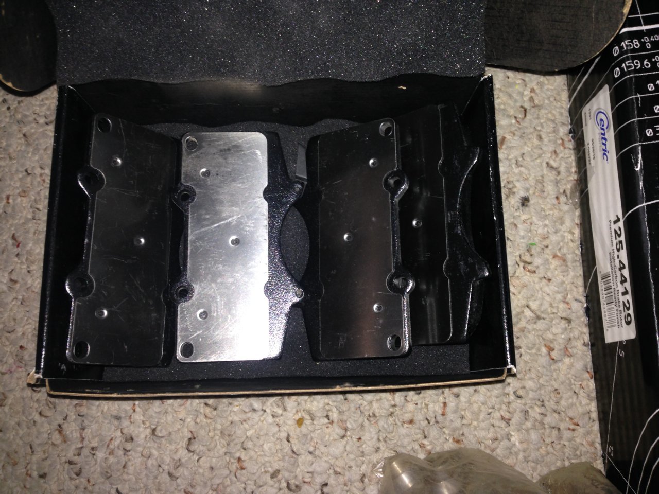

    Also got a set of front brake pads today. Performace Friction Brakes/Carbon Metallic.

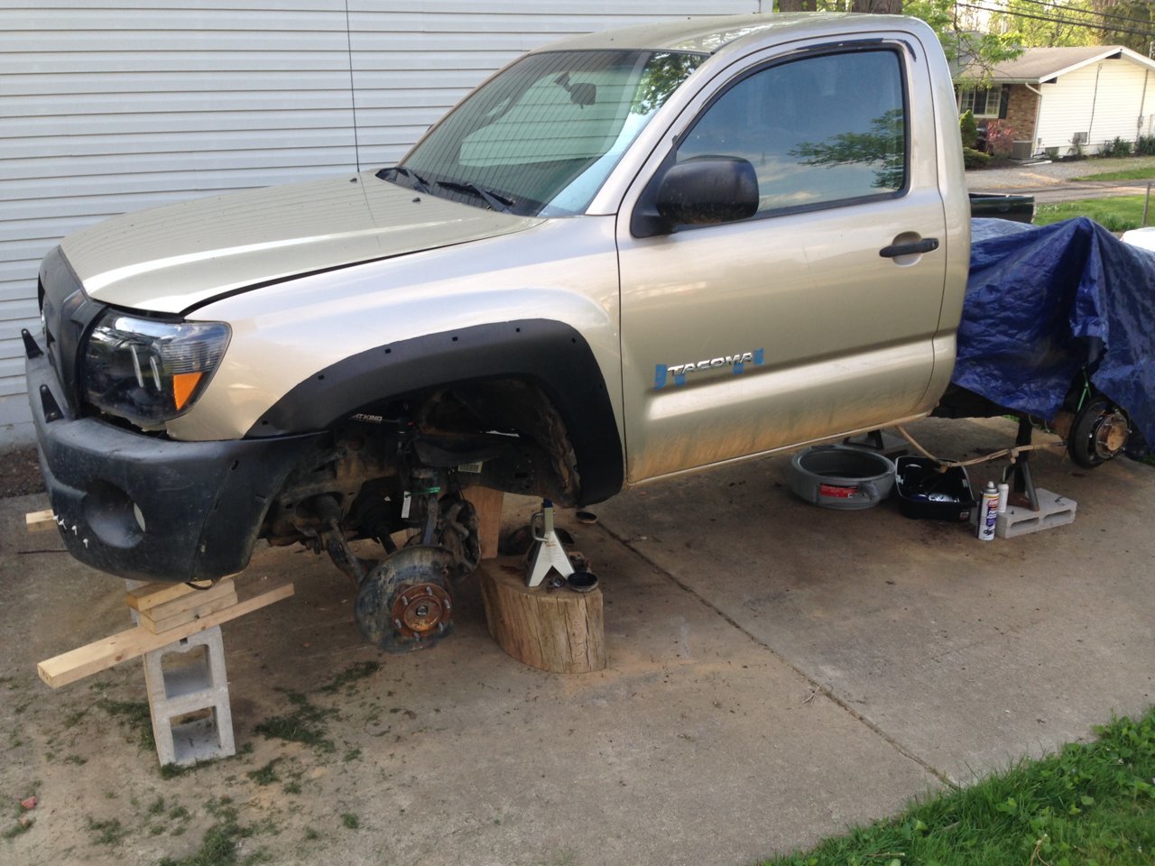

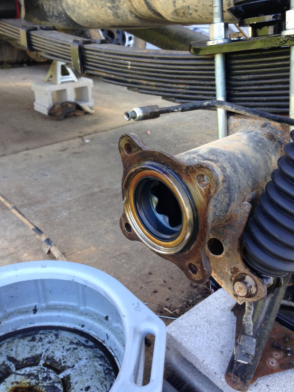

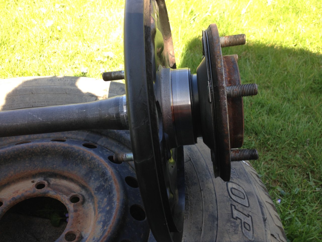

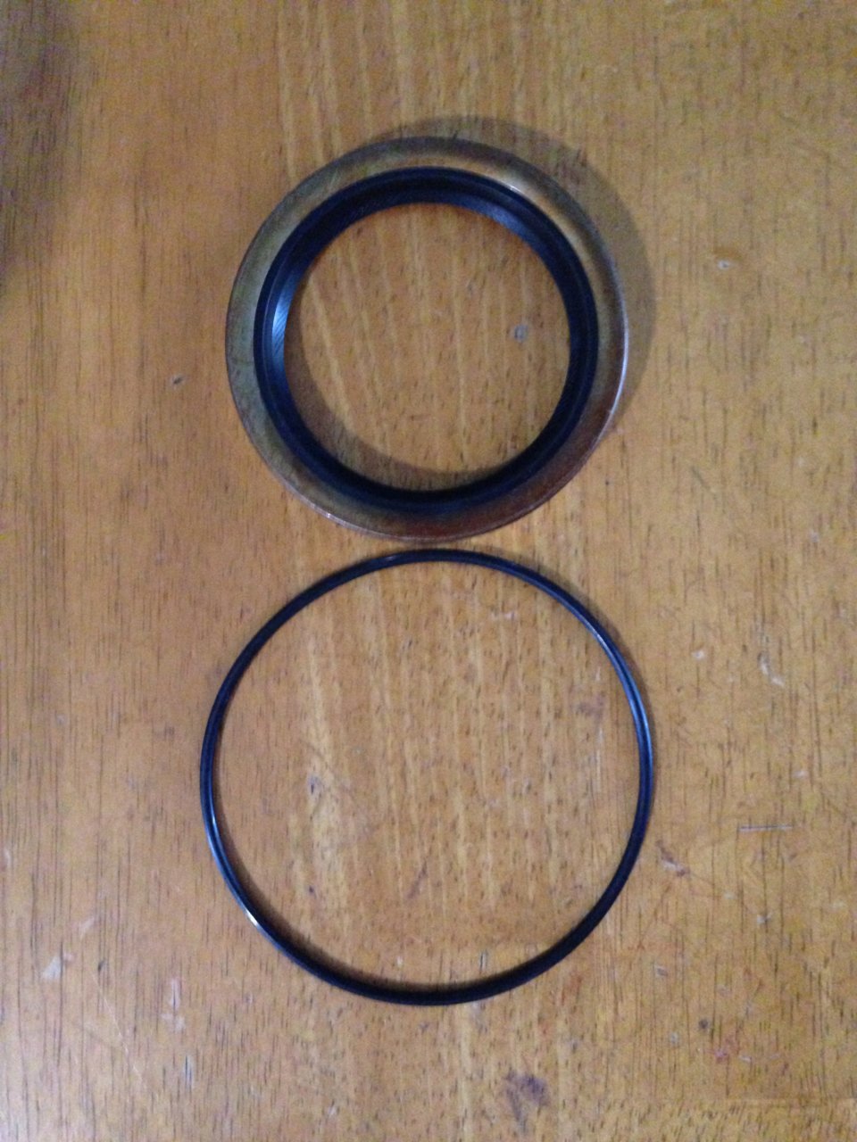

    New Rear Hub/Bearing
    New Axle Tube Seal and ORing.
    Yay!! A truck!
    Started getting the rear brakes back together. Called it a night when I got to having to hook the parking brake back up. It's still covered in grease.
    Also need a wheel cylinder. Had picked up a couple from Oreilly's but returned them. Zero trust/faith in the "Brake Best" brand. So I returned them and will pick up something a little more quality.
    Might also sell my rims. Someone is interested. I hate the rims. I want steelies.

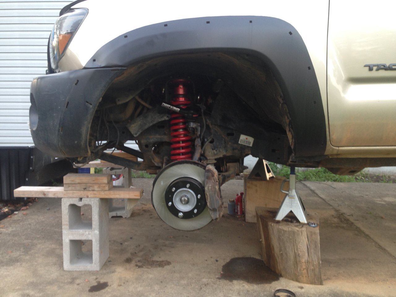

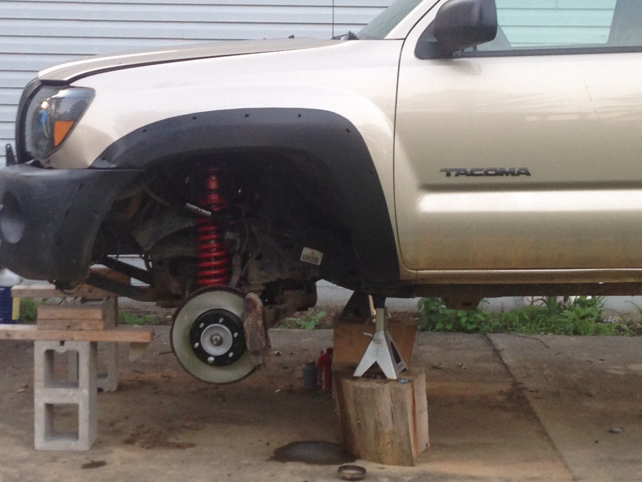

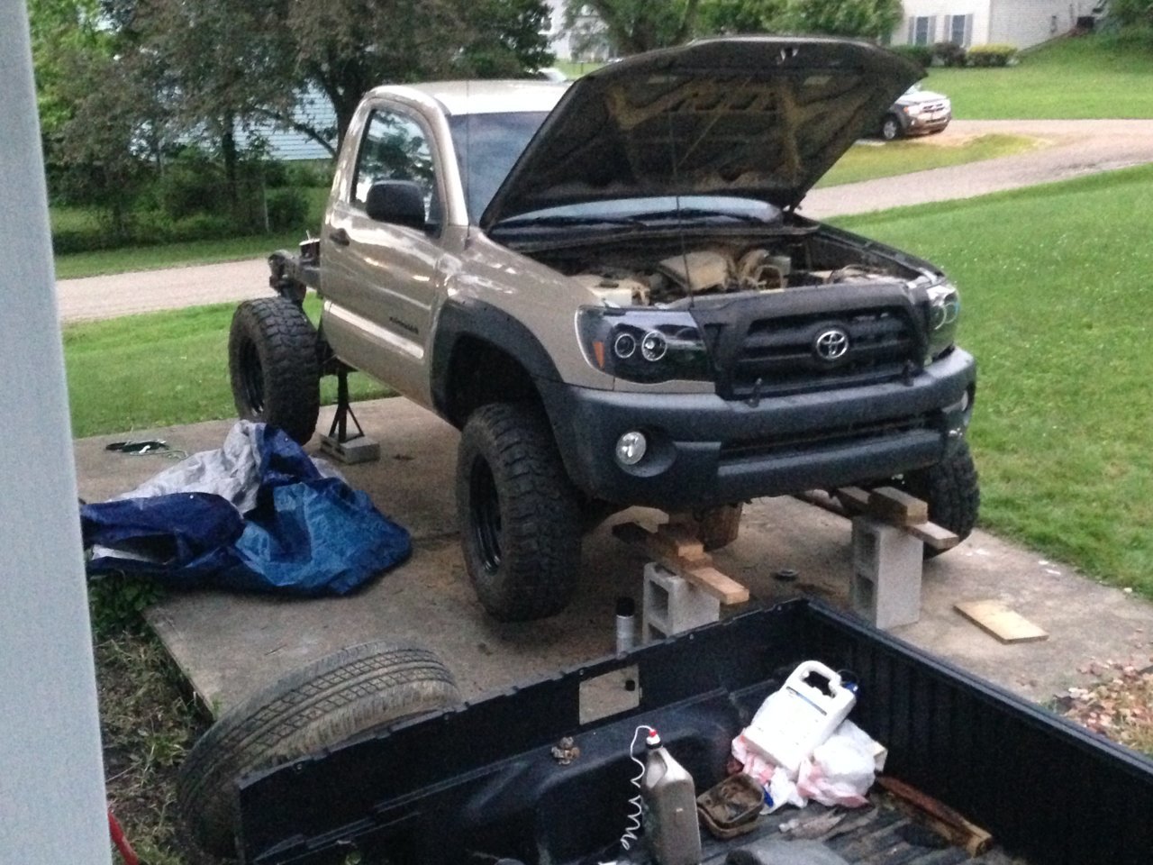

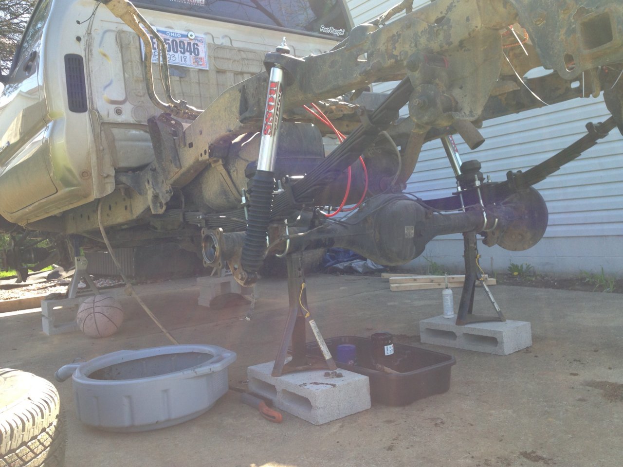

    Driver rear brakes back together, mostly. Drums and a wheel cylinder left. Tighten a few bolts up, do the passenger side. Brake fluid flush as well obviously.
    Do a rear diff drain and fill too. Have had the fluid sitting around for a bit.

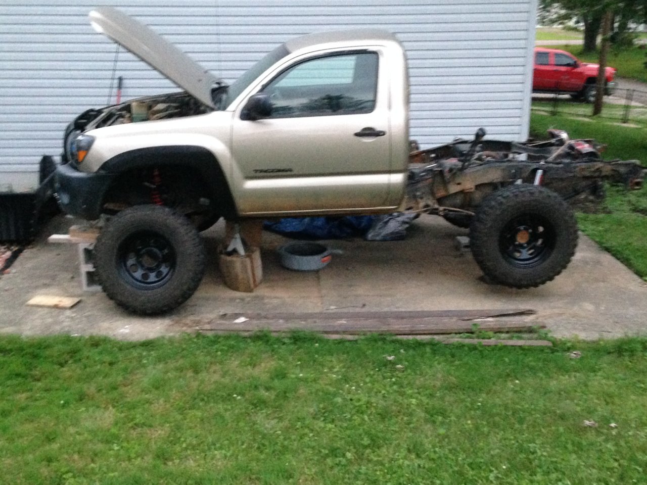

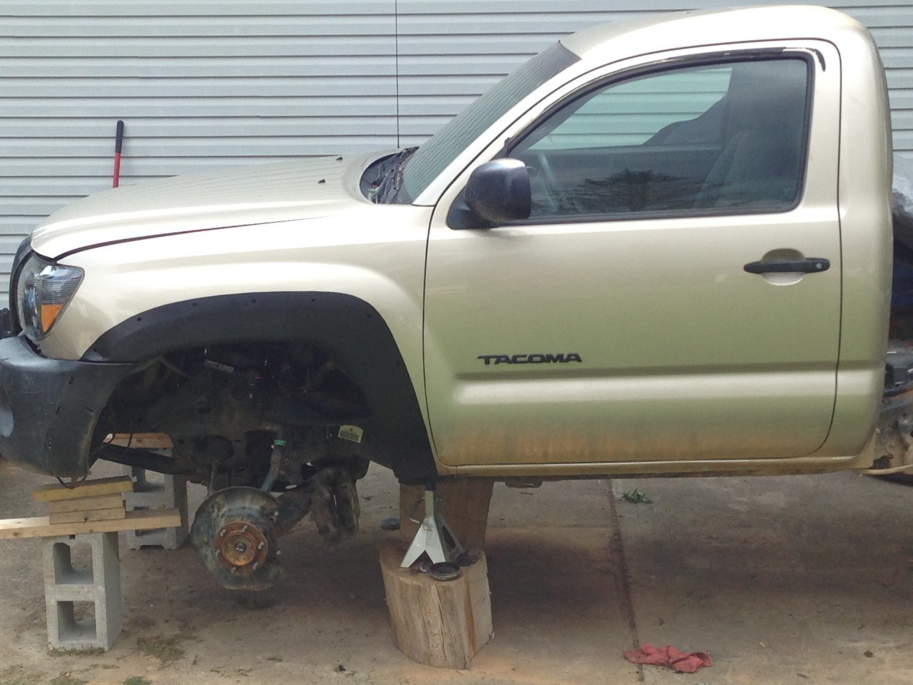

    Swapped over to quartered up tree trunk bases from the cinders since there was some crying. Truck sat fine for plenty long on em, weight was distributed in the middle of the cinders, its a single cab truck, but whatever.
    Liked the look of the flares. Didnt want to tear them off wheeling. Going to derp back over where they were. Do the badges too while I am at it.

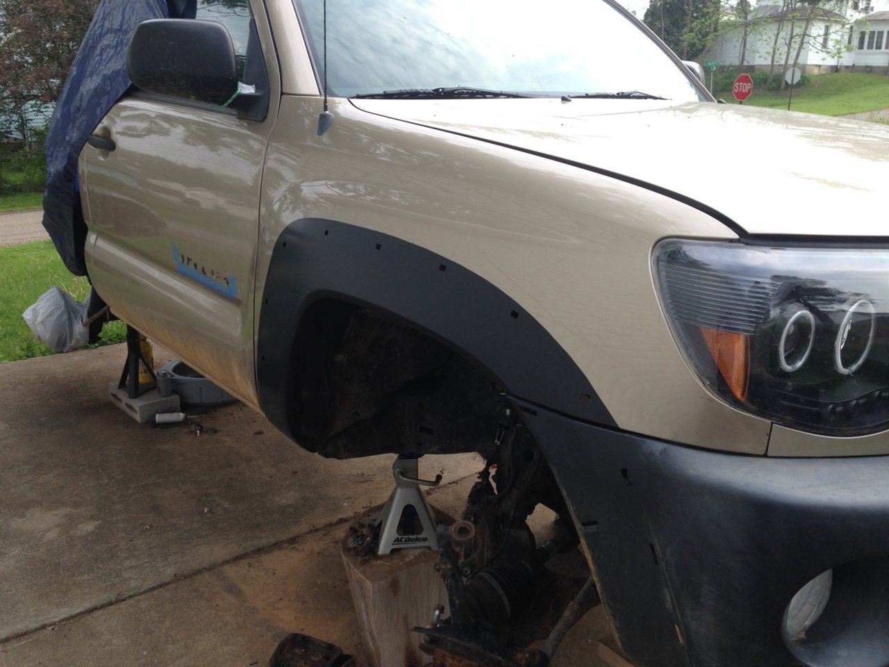

    Outlined the flare areas on the cab and then derp'd them.

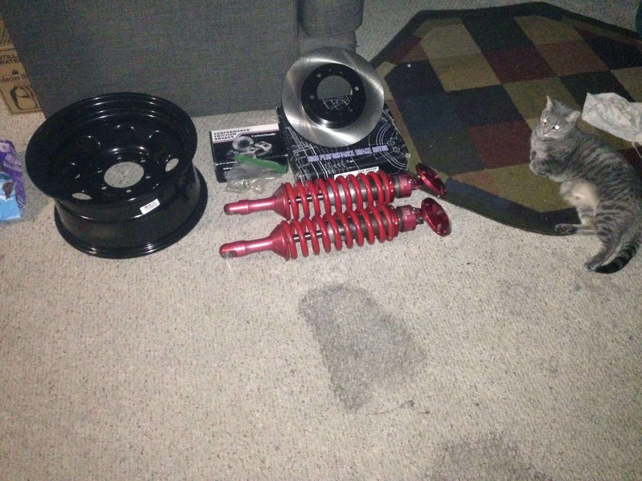

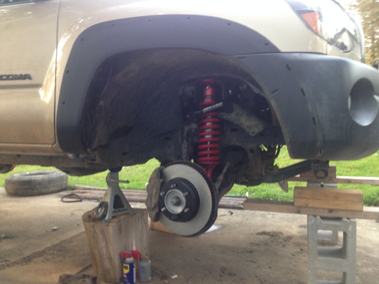

    While I like the look of the painted over flare area, The 'derp appears to not be the best choice for such artistic endeavors. The edge lines peel to easily. Give it another go with bed/herculiner spray.
    Coilovers got shipped this morning and should arrive Monday/Tuesday. Be cutting it close on getting them rebuilt and back to me by next Saturday. That flat rate box had super quick shipping.

    -Got the passenger brake shoes/hardware changed out. Need to hook the springs on, but done other than that.
    -Drained the old diff fluid out. Letting it drain, want to spray it out with brake cleaner tomorrow. Then fill it up.
    -Removed annoying rattling heat shield.

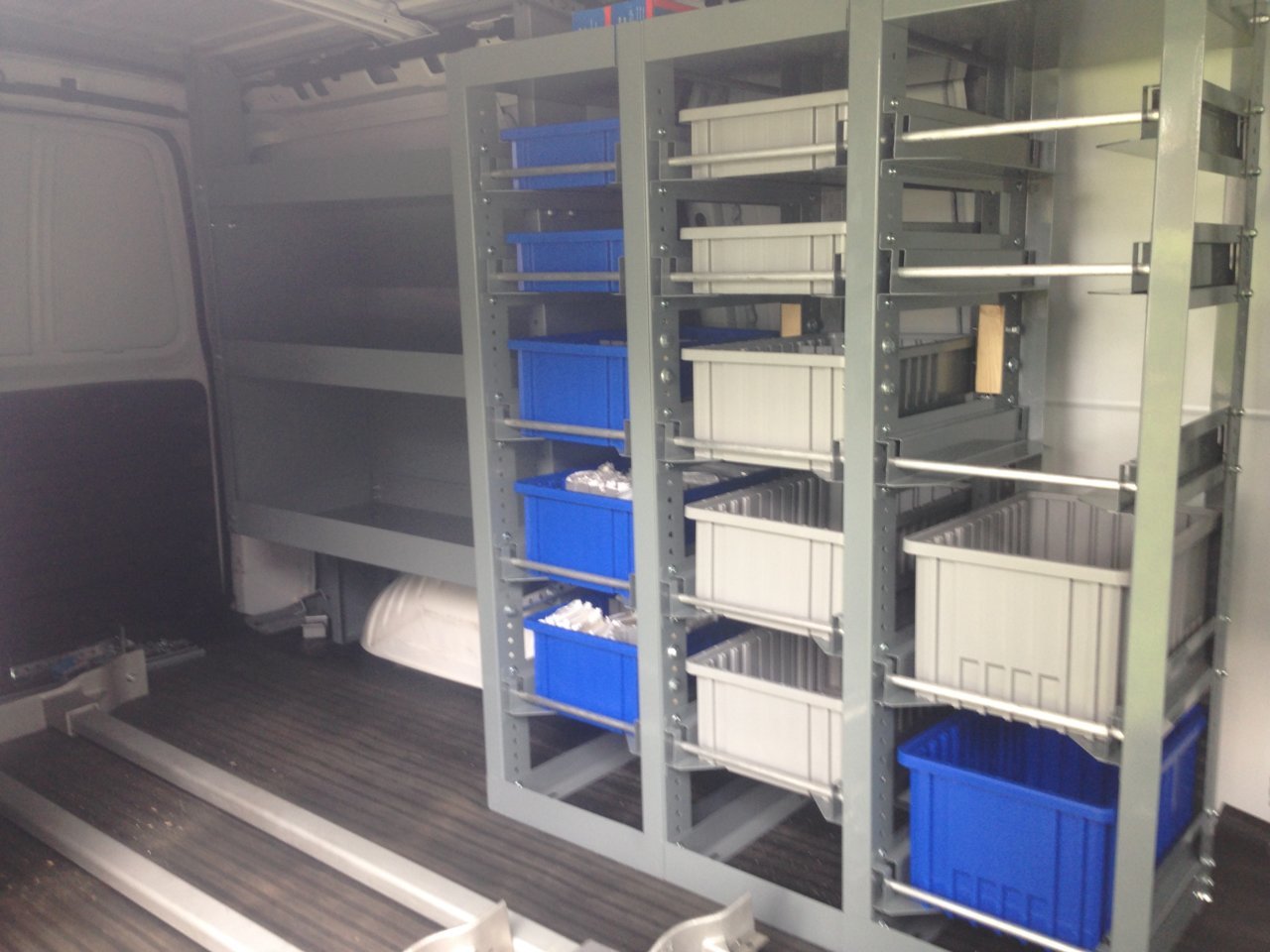

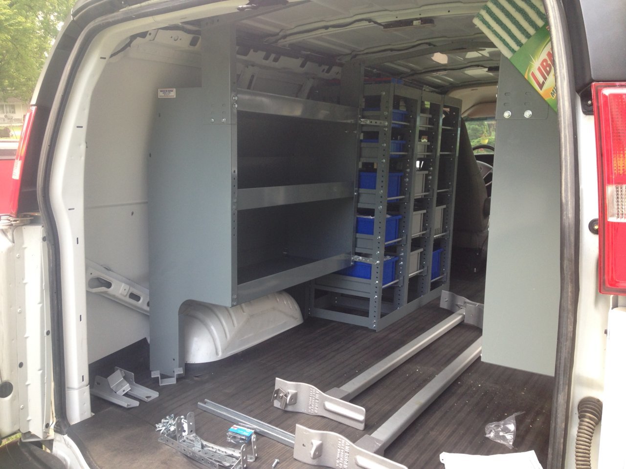

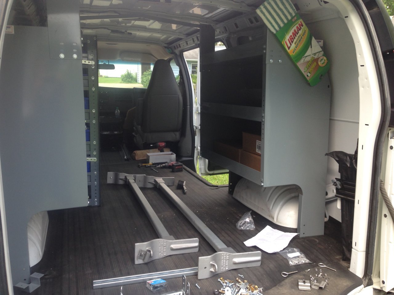

    A chebby work van build.
    Boss bought me a new work van. I installed all the shelving units this weekend.

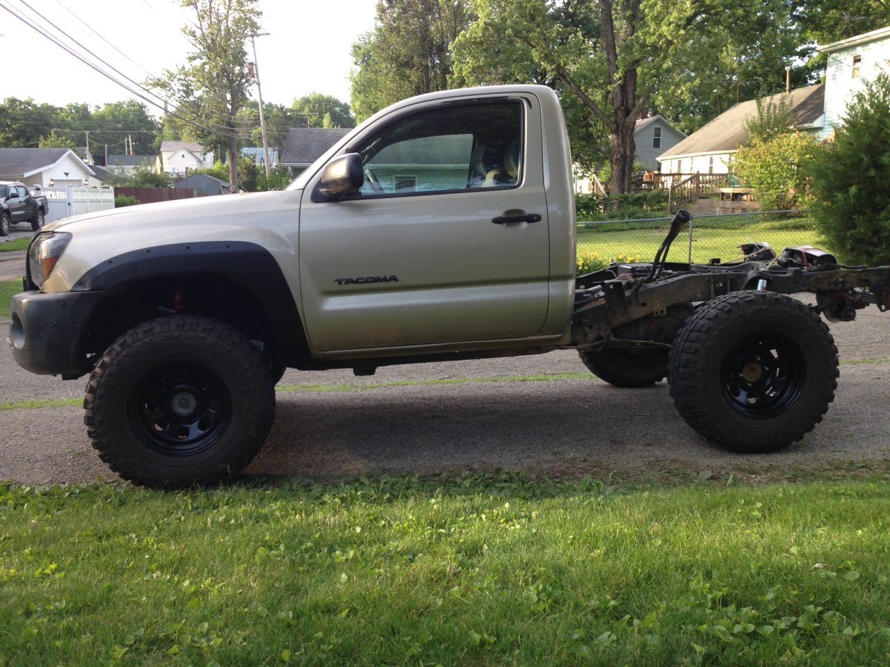

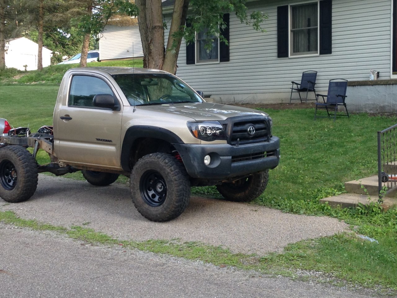

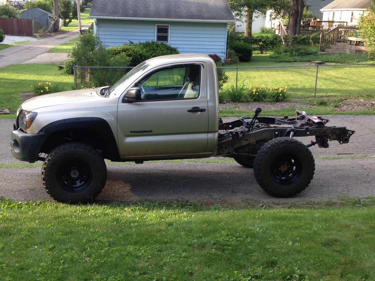

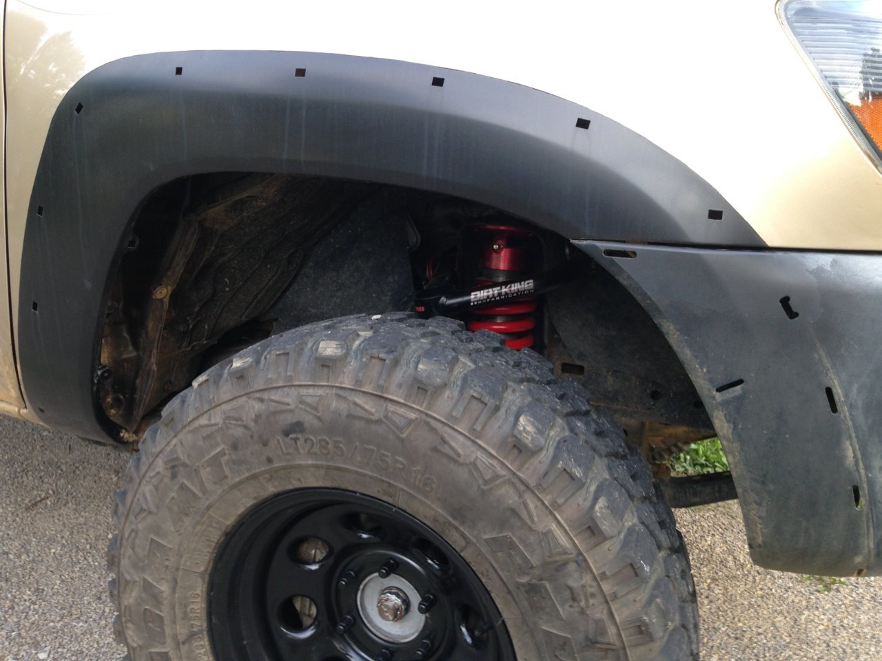

    It. Is. Done.
    Rubber meets the road again!
    First attempt to back down the hill, started up, had no brake pedal. Wifey helped me bleed em out, air still trapped in the RR line.
    Got a pedal, did some back n forth to make sure, then down I went.
    First trip simply around the immediate block, came back, especially to check the rims/calipers. 2nd trip went for 15 minutes or so. Got up around 55 at highest speed. Rechecked lugs when I got back.
    So far it all looks good. Going to drive it to work for the week is the plan, give the Green Truck a break.
