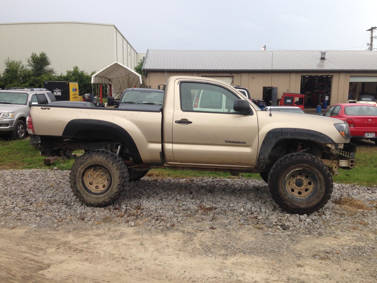

    Rear flare derp to match the front flare derp!! Yes, mud still from Rush. :D

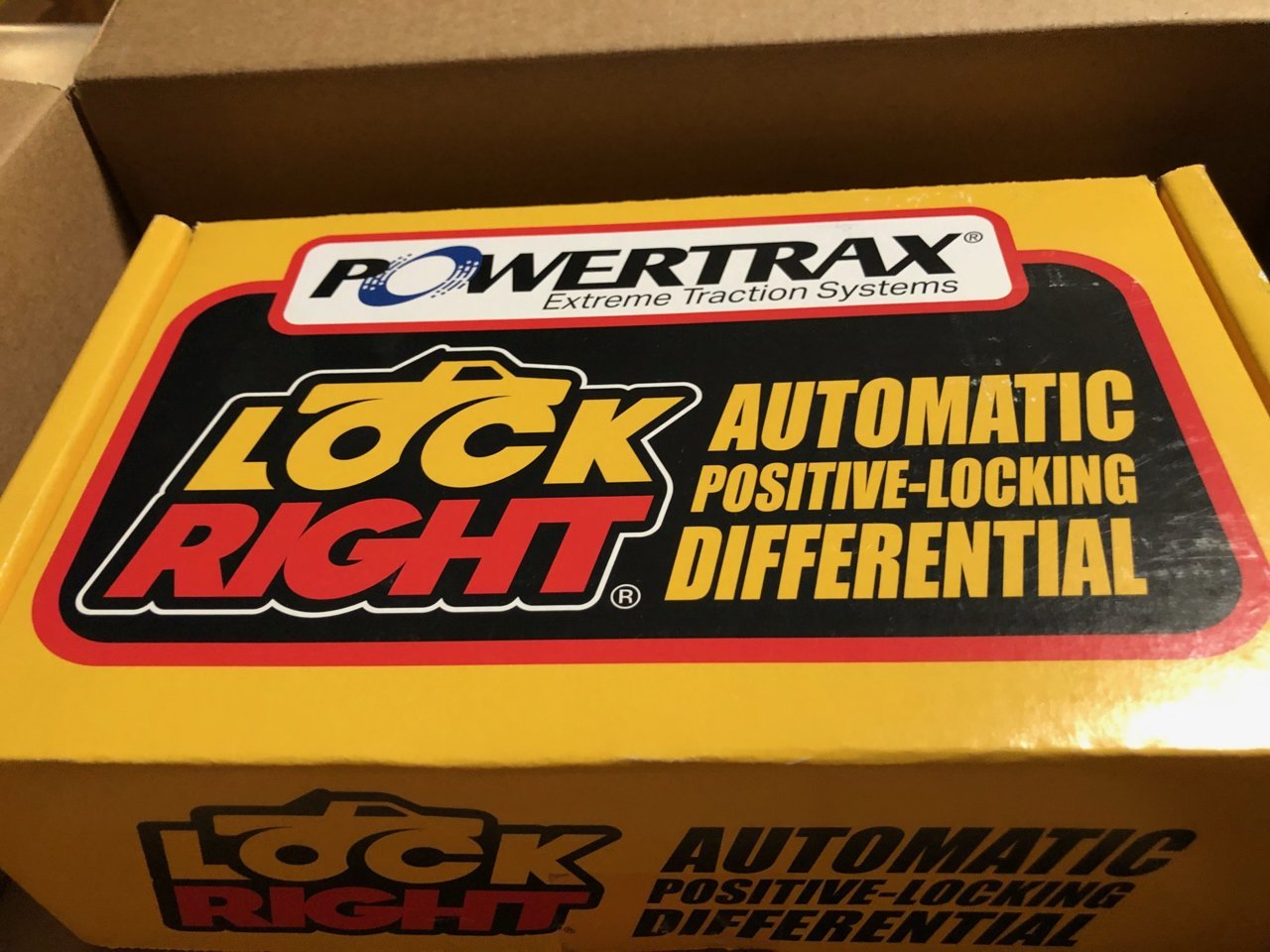

    @rngr
    It's coming. Today. I get to join the club!!!

    Where did you buy it from?
  10. Sep 19, 2018 at 9:30 AM
    #530
    2TRunner
    2TRunner [OP] Snoop Dad
    Jul 30, 2010
    #40980
    4,226
    My House Usually
    Amazon. It was 393.00 everywhere. Amazon had free shipping and was here stupid fast. Ordered it Sunday around 1pm. Was delivered by 11am Tuesday morning. Cant beat that!!!
