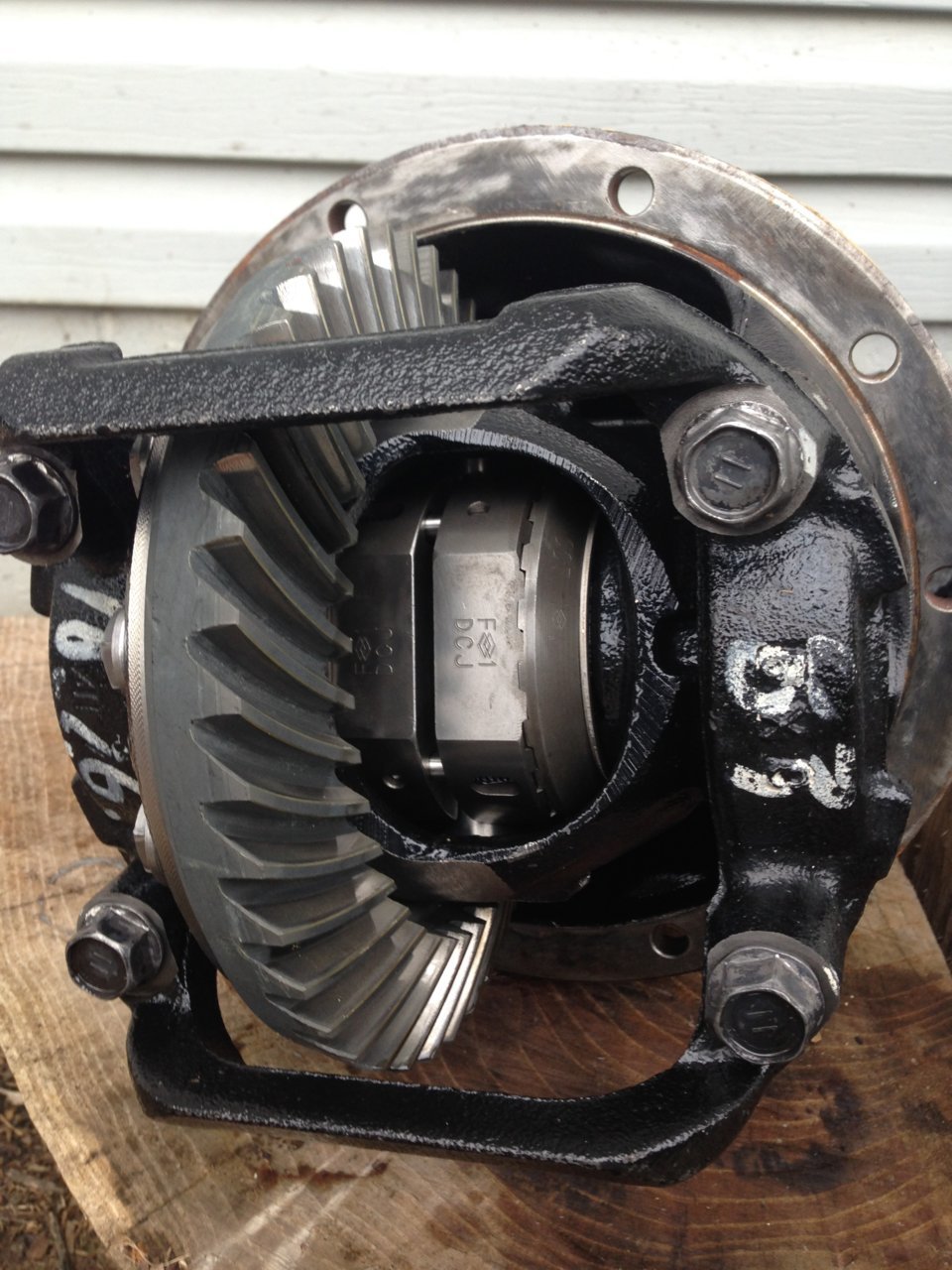

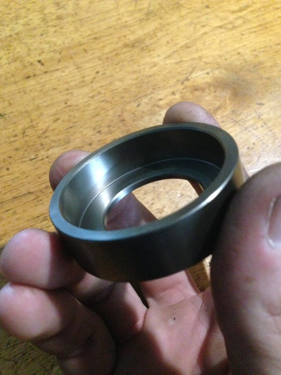

    Playing around with the Lock Right/Install instructions. Pic in the booklet may as well be a black square, so TW it is! This "spacer" thingy, I have it installed/positioned correctly, correct?

    Pretty sure that's correct. @Knoxdavid34 asked me the same thing a few weeks ago installing his

    That's how I put mine in and it's working fine. Also Justin told me to use a diff oil made for an lsd diff but didnt listen. Instead put a quart of Lucas in the diff to thicken the oil. I honestly dont even hear it click unless I'm really listening for it with the windows down. Even then, it's a very faint click.

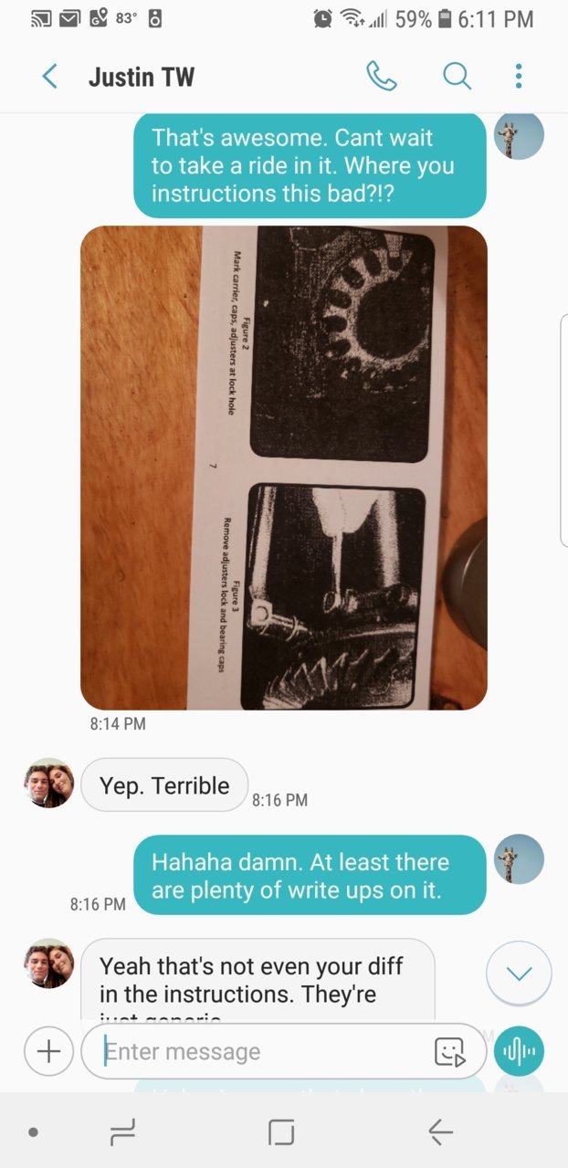

    Appreciate the replies and assist fellas! For $400 you'd think they could provide an actual colored picture in the instructions. It is 2018 after all.

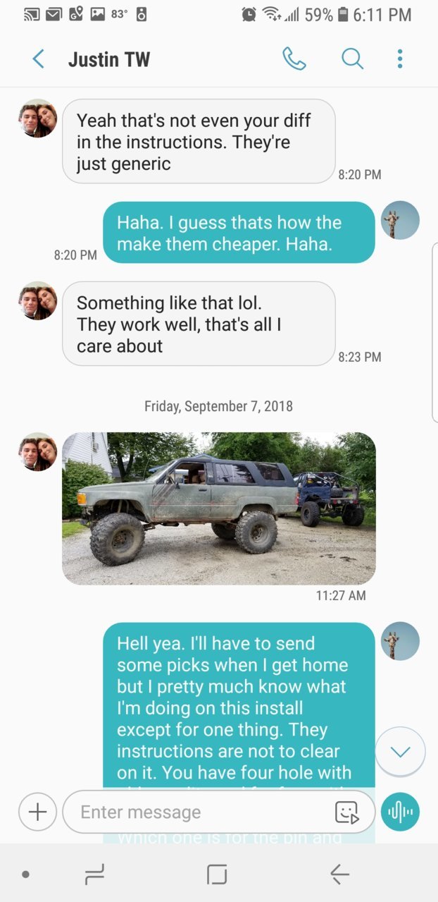

    Me and @JustinogoScreenshot_20180921-181132_Messages.jpg Screenshot_20180921-181142_Messages.jpg just had this conversation.

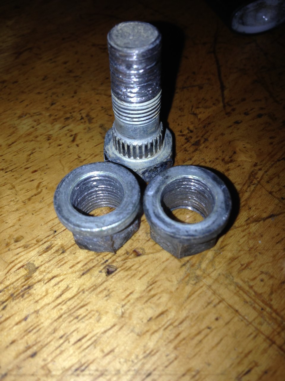

    Ran into a couple snags. Broke 2 brake line bolts off, still have one per side though. Also, in a crappier topic, 2 transfer case flange to driveshaft studs were stripped out and are jacked. One stud was actually loose, as I found out when I put some wrenches on it.
