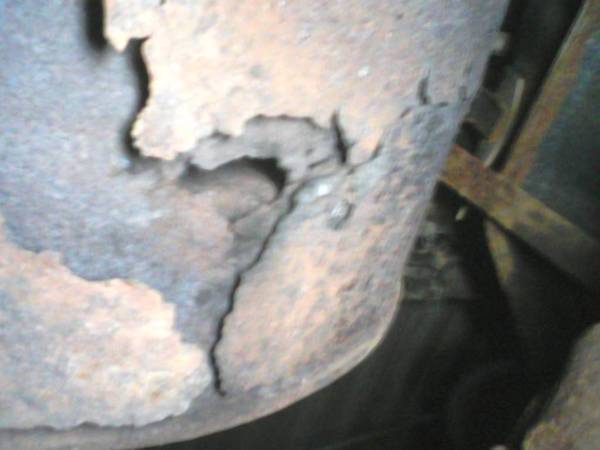

    So I got in my truck this week after not driving it for a few days (wife was driving it) and it sounded funny. Look underneath and found hole in muffler (see pic). Salt kills...
    So I need a new muffler. I was thinking of just replacing from the cat back. I do NOT have the money to spend on a cat back performance exhaust and really am not looking for a exhaust for the sound, so basically want to get a quality replacement that will bolt right in.
    I could use some suggestions on something that is well made and priced right. I have heard of Walker exhaust but that is all I know. Suggestions would be appreciated.
    I did some searching and everyone has posted about replacements for the sounds...flowmaster, magnaflow, etc, but really just want something that is cost effective and as quality made as possible so it will stand up to the salt.
    Thanks

    I had a very similar situation w/ my last truck (97xtracab) Ended up just bringing it to my local muffler guy and had him bend some stainless pipe from the cat back and weld on a magnaflow muffler. it ran me just over $300.
    If thats too much for ya, and your piping is solid, just weld on a new muffler

    I don't think you can go wrong with a Magnaflow. Based on how much you have to replace, it would likely cost you anywhere between $100 - 350.

    Keep in mind, aluminized replacement mufflers/systems have a life expecantcy of 2-3 years in salty areas. Balance that with the cost/labor of a stainless replacement and how long you plan on keeping the truck.

    I found a guy parting out his totaled tacoma. He is willing to sell me the exhaust piping and muffler from the cat back for $50. Anyone ever do this themselves? Should I be able to take apart right behind the cat and bolt the replacement right on (its OEM)? If his in good condition, I am thinking about doing this.
    If his is not in good condition, then I will look into Magnoflow and or something stainless and NOT aluminum due to salt. Any other recommendations for quality stainless replacement (not concerned about the sound)? Thanks.

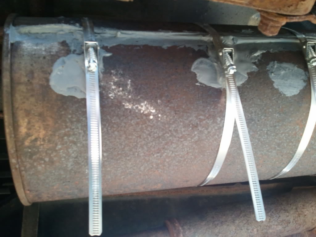

    I just bought a 2000 extended cab and I have the same issue. Pipes all look ok but the muffler is splitting down the side. Has anyone here replaced the single piece pipe from the cat back? Can you get the new pipe on with the truck sitting on the ground?

    Well I Realized that my muffler is splitting at the seam. The pipes and everything else are fine. So I used some Permatex muffler goop and some hose clamps to fabricate a repair. It's been 3 days now and it's holding ok. Eventually I'll fix it properly.
