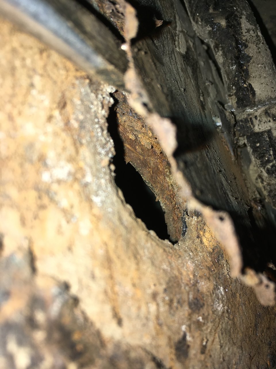

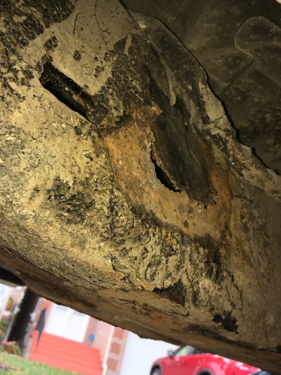

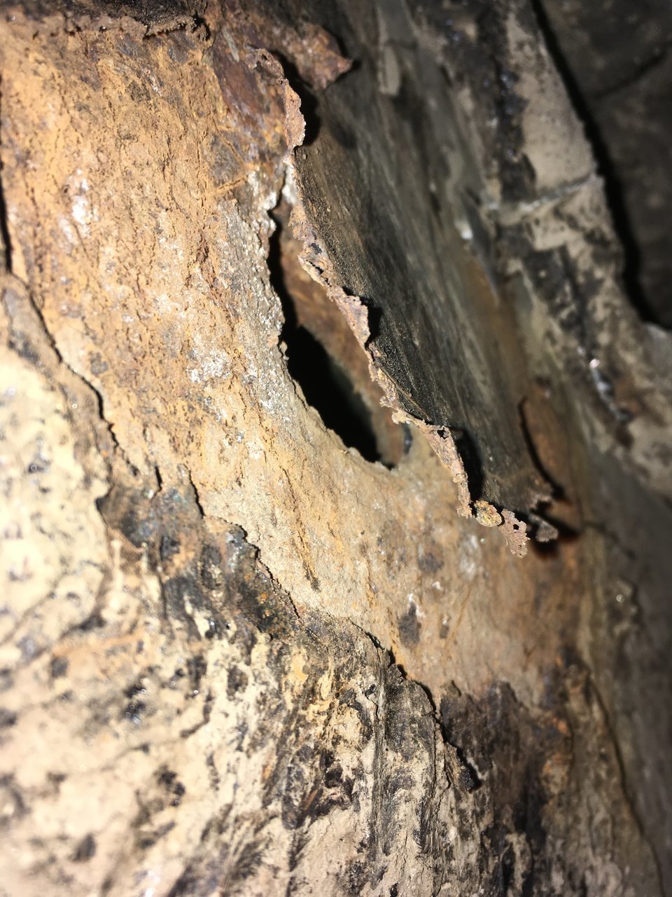

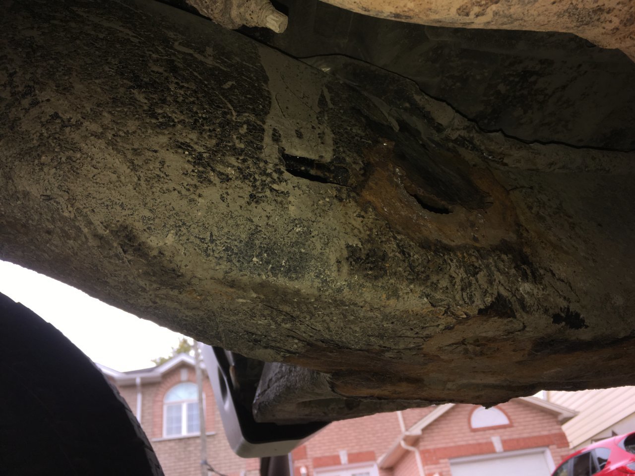

    Was scraping off some of the undercoating on my 2007 4x4 DCSB today to sand it down and apply POR15 rust preventative. I was prepping the truck for a full rust proof next week.
    While I was running a flathead screwdriver along the frame to scrape off some of the old undercoat, the screwdriver hit a lip in the frame (which I thought was just undercoat peeling off), so I scraped it some more and noticed it was very rigid, and was actually metal. I wedged the screwdriver under the lip and noticed there was a big hole that has developed under the undercoat. The hole is right behind the cab mount on the passenger side by the front wheel. I cleaned everything up and took a few pics which I included below.
    My truck was inspected earlier this year but I can see how this would of been missed considering it was underneath the hard undercoat layer. I called the dealer and booked an inspection for Monday for them to check it out.
    Does this look like potential grounds for a frame replacement? I have no idea how that would even work considering I have a DB lift installed and no longer have my stock tires either.

  2. Nov 4, 2017 at 10:53 AM
    replica9000
    replica9000 Das ist no bueno
    Apr 6, 2008
    #5782
    16,424
    Lake Chargoggagoggmanchauggagoggchaubunagungamaugg
    2019 T4R ORP
    Have Toyota inspect it. You might qualify for a new frame.

    Inspection is monday.. one of my mechanic friends is saying they may not honor it since the truck has a drop bracket lift..
    Also said he thought the recall ended earlier this year. Im in Canada so I dont know the details
    Hole is around 25mm-30mm in diameter

  5. Nov 4, 2017 at 11:27 AM
    T4RFTMFW
    T4RFTMFW Well-Known Member
    Jul 23, 2014
    #134525
    69,757
    I don’t think any frame replacement has been declined due to lifts.
    Maybe if yours is failing right where the new crossmember was welded on? But doesn’t seem to be the case.

    A drop bracket lift requiring an aftermarket modification and CUTTING of the frame.... 100% grounds for denying a frame replacement. Sorry OP. Good luck, maybe you will find a sympathetic dealer.

    Cant see how the rust would be affected in any means by the cross member cut.
    Plus the original inspection I had earlier this year where they told me it was 'fine' was before I had the lift even put on. And I can guarantee you a hole that big did not form in 6 months during the summer. So this rust issue was present long before the lift was ever installed
    Sort of scenario where Toyota would have to prove the rust was caused by the drop bracket if they were going to deny me the replacement. And good luck with that considering the section that was cut out was far away from the hole and was properly sealed/cut professionally.

    No history of frame issues, sure. But tens of thousands of failed frames.. not making a difference IMO. Always a chance, I guess, but I’d be surprised.

    Get a new frame put on,the problem was caused by Toyota's cheap frames,not by anything the O.P did.

    The problem isn't that the frame cutting caused the rusting hole. The issue is that they will not modify the new frame for your DB Lift.
    They don't have to prove that the modification caused anything. You are confusing Aftermarket parts instead of OEM parts usage. They cannot install a stock frame with a DB Lift installed without cutting it and modifying the cross member. They are not required to and probably will not do this. I know I wouldn't.

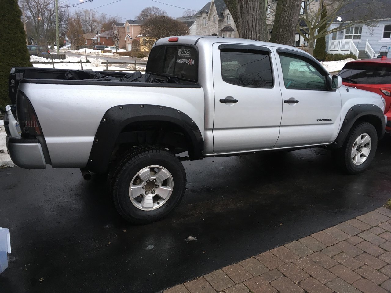

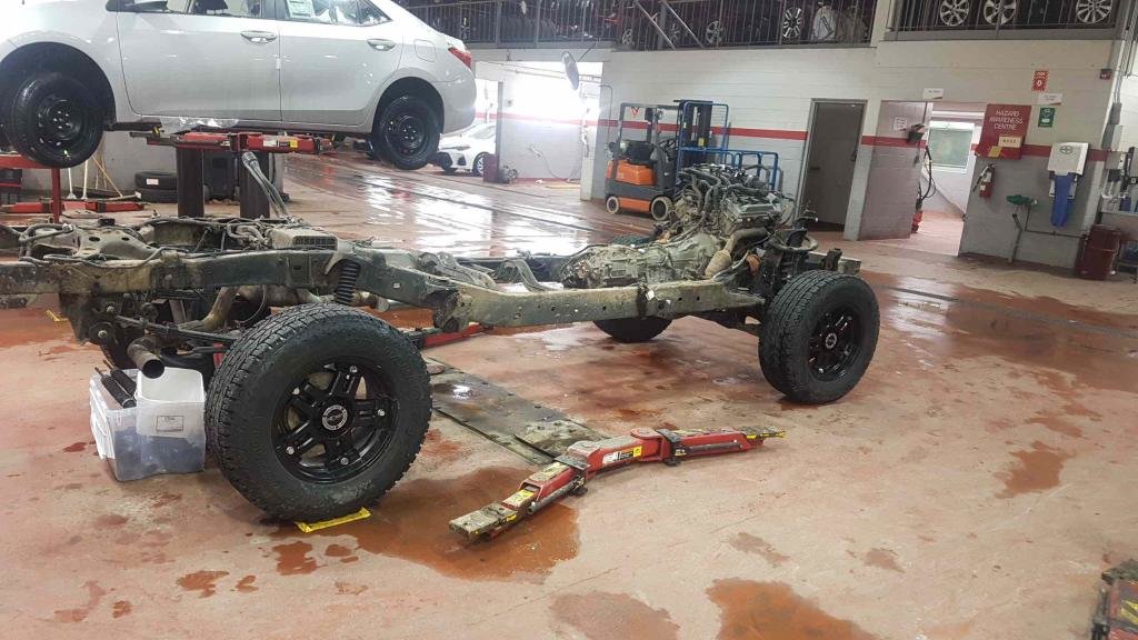

    Crazy and annoying experience after all was said and done.
    - Brought the truck in on a Monday for the dealer to start the frame replacement.
    - A few hours after bringing it in, I get a call that my E-Brake cable is seized, and they want $350 in parts, and $250 in labor to put a new one in.
    - A few hours after that, they've broken the outer tie-rods and steering shaft end when taking them out and want $90 to replace the parts
    - Dealer tells me that my BDS extended rear shocks wont work on the truck after they take out the 6" Lift, they want $400 to order me new rear shocks to replace the rear BDS shocks. I said no and ordered a set of Bilstein 5100s for the rear off of Amazon, and told them to leave the BDS Shocks and lift blocks in the rear because I would swap the shocks out myself when I got the truck back.
    - Fast forward to Thursday, I leave work early to go pick the truck up. I get the truck and it has a crazy high lift in the rear cause they left the rear blocks and shocks in like I asked.
    - I drive the truck off the lot and immediately notice how horrid the handling and alignment is. The steering wheel has no resistance in it at all and almost felt broken. When I turn to either direct the wheel keeps rolling and flops into 'lock' position with a big thud sound coming from under the truck.
    - I almost get in 2-3 accidents on the way home because my brakes barely work at all, I have maybe 20% of my normal braking power. I proceeded to drive 20km/h with my hazard lights on all the way home.
    - Friday morning I take off work and spend the morning removing the rear shocks and rear lift blocks off the truck, hoping it would solve the poor handling and braking power issues.

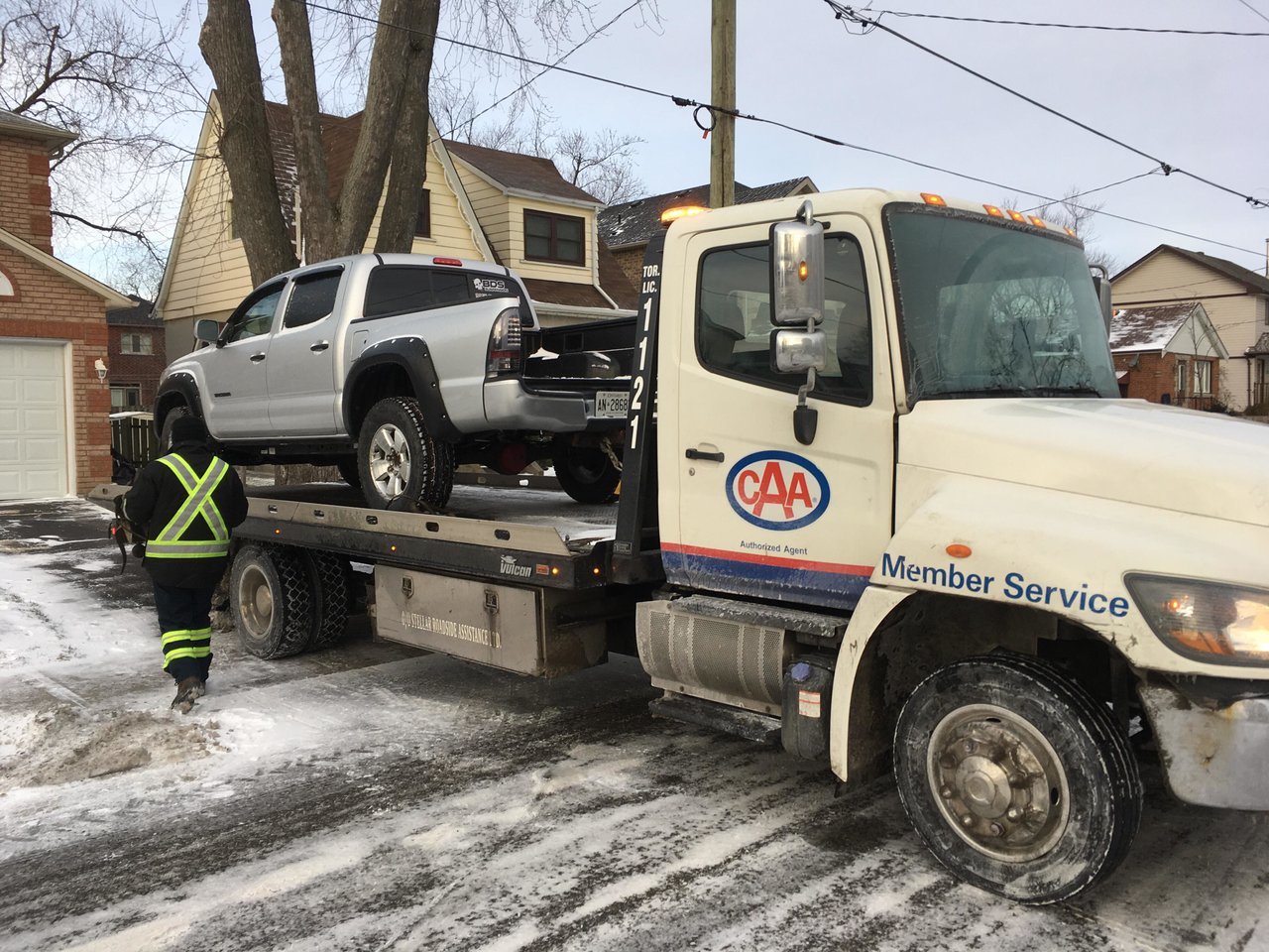

    - I take it for a test drive and still no improvement. I called the dealer and booked an appointment to bring it back the next day. I scheduled a tow truck to come to my house in the morning so I didnt have to drive the truck with no brakes.
    - Saturday morning, Tow truck comes and asks me to back up onto the tow truck platform. I turn the key and the engine just clicks, now truck wont start...
    - Tow truck winches me onto bed and takes me to the dealer. They tell me they dont have time to work on it today and give me a rental for the weekend.
    - Monday morning, I get a call and am told they dont know whats wrong with the brakes but will keep looking. I am told that I was missing the front diff mount bushings and as a result my diff was flopping/bouncing around every time I turned. They told me $380 to order the parts. They also tell me that my starter is blown and want $600 to replace it.
    - I go through the box of old parts they gave back to me that came off my truck. And low and behold, they gave me back the damn front diff bushings and never installed them. I drop them off and they put them back in for me at no cost.
    - Tuesday night I return to pick up the truck. Brakes are fixed, new alignment, bushings reinstalled. Truck seems to be driving normally again. My friend who works at the dealer told me there is a brake proportioning valve or something on the master cylinder that was all screwed up and had to be reset.
    Ive had the truck for about 1-2weeks now and havent had an issues since. Brand new frame on it and it rides really nice. Dont think ill be putting the drop-bracket lift back on in the near future..
