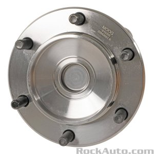

    I see what's going on. The OEM PreRunner hub has a metal dust cap over the hole. Some aftermarket hubs like this Moog are made the same way:

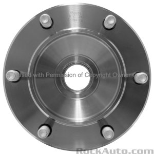

    Some aftermarket hubs (like this FVP WH95004) lack the dust cap:
    You can try punching out the dust cap from your old hub and re-using them. Or go to your nearest auto parts store and find a plastic cap that'll fit in the hole.

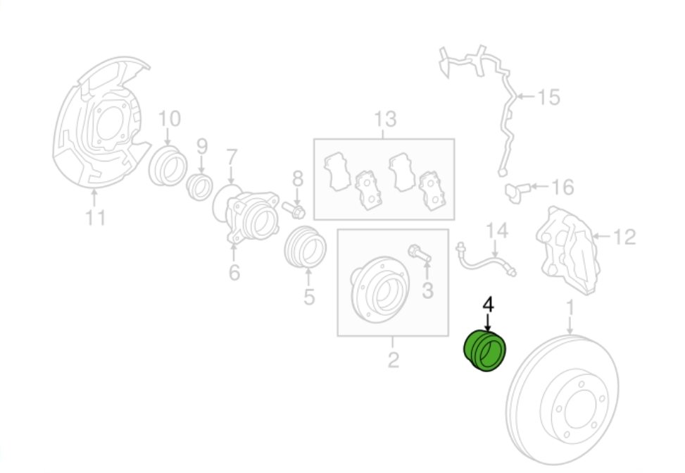

    Another solution is to get the "grease cap" used on 4WD trucks, P/N 43514-28010. This fits in the larger lip of the wheel hub register: https://toyotaparts.mcgeorgetoyota....-bearing-dust-cap-left-right-front-4351428010

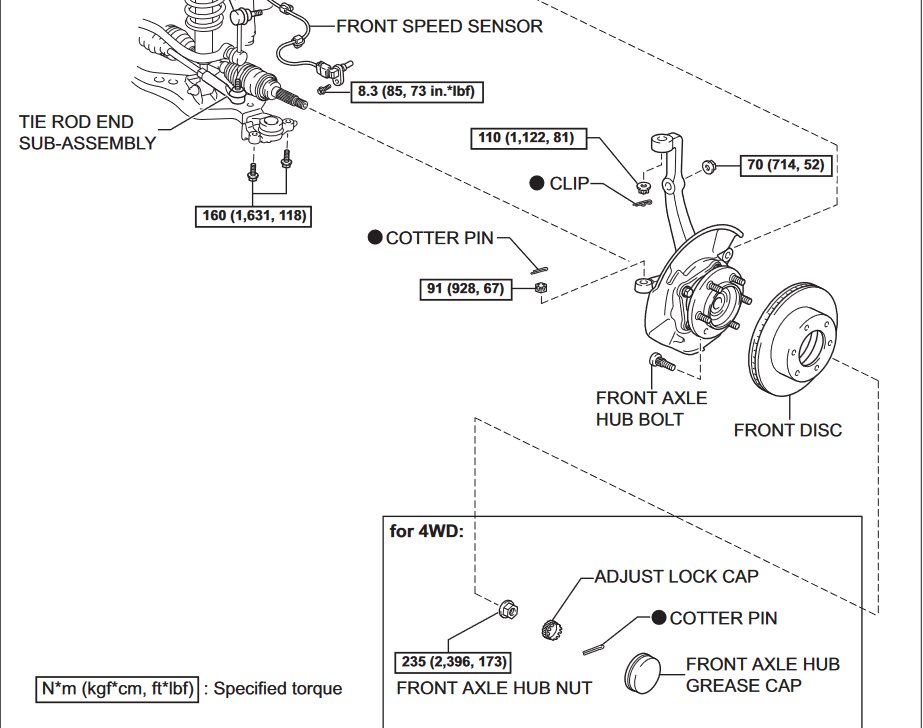

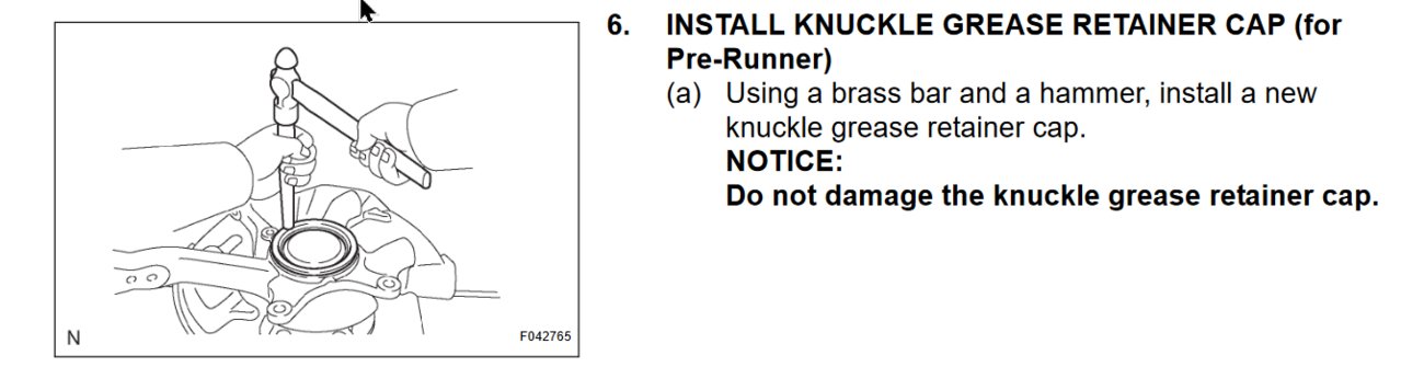

    SC
    2012 Prerunner SR5

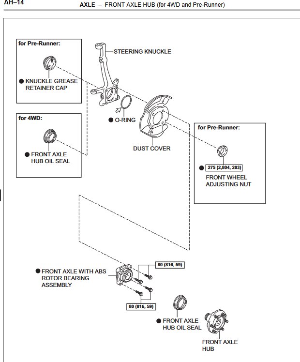

    I'm obviously confused by the questions.
    The Grease Retaining Cap is pressed into the Steering Knuckle, not the hub.
    The 4 wheel drive has a seal in the place of this grease retaining cap on the steering knuckle.
    Then the hub (4 WD OR PreRunner Not interchangeable) is installed into the Steering Knuckle.

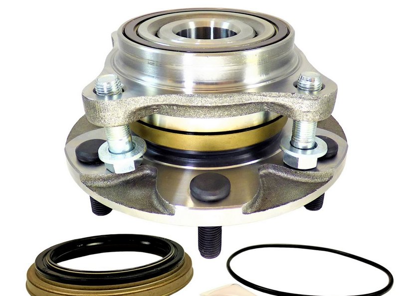

    4 Wheel Drive
    Steves104x4 likes this.
  14. Sep 4, 2023 at 7:45 PM
    Jimmyh
    Jimmyh Well-Known Member
    May 16, 2012
    #78991
    14,203
    SC
    2012 Prerunner SR5

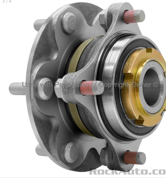

    Backside of the PreRunner Front Hub Assembly.
    4 Wheel Drive Hub Assembly.
    The Prerunner Hub has a Threaded portion coming out the rear for the spanner nut to screw onto to retain the bearing assembly.
    The 4 WD Hub has Splines inside for the axle shaft where the PreRunner Hub does not have splines.
    Superdave1.0 likes this.

    I'm confused on whether OP has a 2wd or 4wd hub assembly.
  16. Sep 4, 2023 at 9:07 PM
    #16
    Taco 422
    Taco 422 [OP] Well-Known Member
    Feb 24, 2020
    #320258
    954
    USA
    Gen 2 AC v6 TRD SR5 Prerunner
    I have the pre runner hub assembly as stated in post number eight.
  17. Sep 4, 2023 at 9:16 PM
    #17
    Strictlytoyz
    Strictlytoyz Well-Known Member
    Jul 23, 2015
    #160147
    2,785
    Charles
    HA\/\/AII
    07 Shitbox
    So what holes do you have in your hub/wheel bearing assembly that needs covering? The outer hub surface should be fully covered and the inner should be covered by a grease cap on your spindle (as shown above in @Jimmyh post of the parts breakdown) assuming you still have 2wd spindles.
    Here's the outer surface of a typical 2wd hub assembly.

    You want part# 90339-33003
