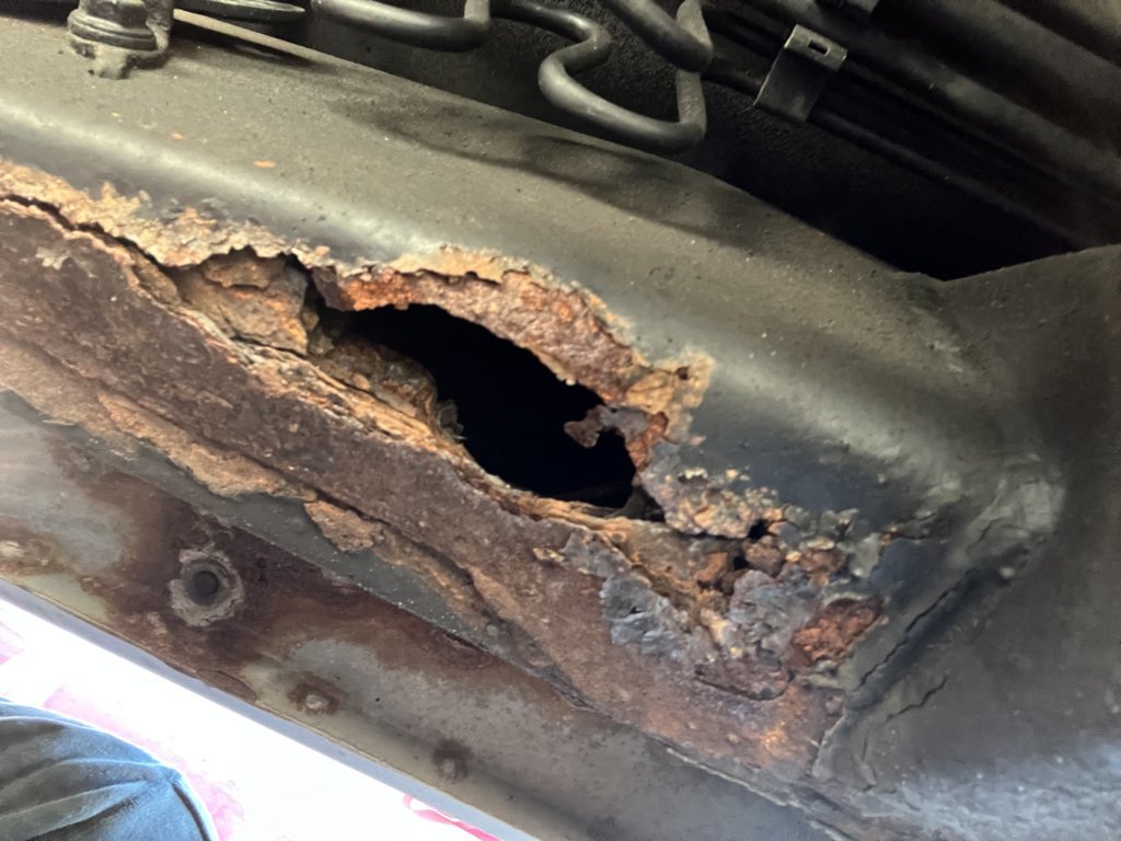

    Have a 2010 trd sport 4x4 w 99,965 mi. Found a large rust hole in the frame (drivers side/below driver seat) today. Wondering if anyone else has had any success with saving it, or is it a lost cause. This truck has seen many cold nothern winters with salty roads. Any insight is appreciated.

    Looks like it was coated with a rubberized undercoating like Ziebart? Lost cause because this isn't the only spot on the frame with severe rust - the cancer has already spread.

    You have major frame rust damage. Based on that picture you are going to find a lot more rust damage. The integrity of the frame is compromised and that truck is dangerous to drive. I’d have it checked out by someone who knows what they are doing and go from there.

    Walk away A hammer will find more.
    Ahh, it's yours. Yes it's possible to repair but you'll need to go over the frame with a fine tooth comb first.
