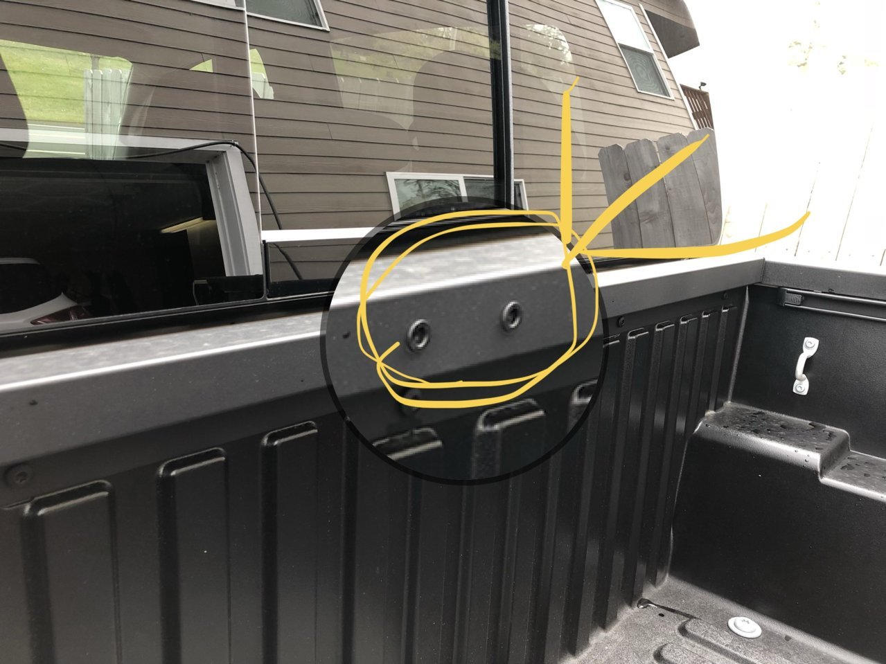

    Does anyone know what these are for and what size would these be?

    Subbed for size. I want to fill mine with screws. I think it looks unfinished without.

    They're for attaching the factory tonneau cover. Thread size is M6 x 1.0.
