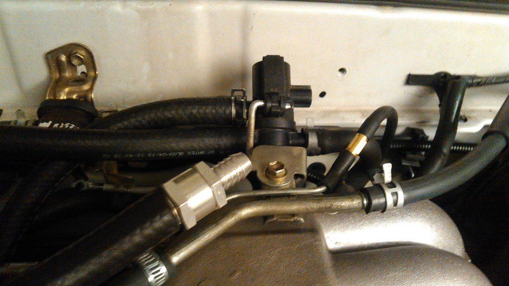

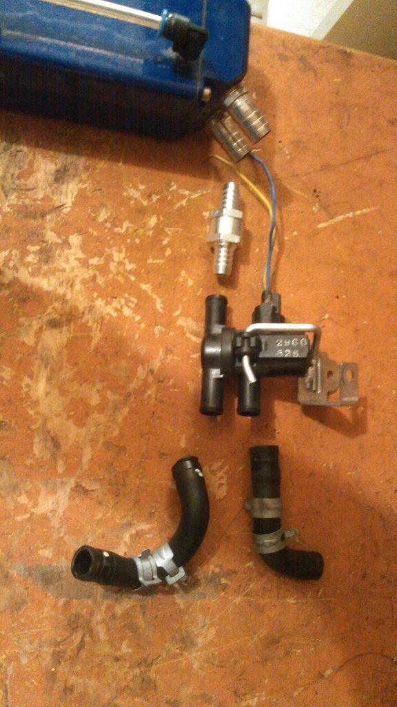

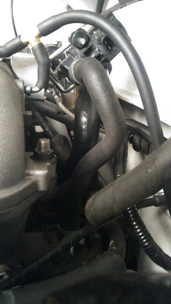

    My initial setup with the breathers was just to get the thing running and shakeout the mechanical side. Here's my breather setup plans/progress:
    In order to allow the valve cover breather to take in metered air under vacuum (to keep fuel trims happy), but not see positive pressure under boost, there needs to be some sort of valve. I found a PCV solenoid from some Yamaha motorcycle for $12 shipped on eBay to try out.
    From testing, the port on the bottom right shuts when the solenoid is powered. This line will go to the intake right after the MAF.
    The other lines are interchangeable and will go to the valve cover breather and the coalescing filter (see below).
    Mounted:
    Line from valve cover breather
    So under vacuum, the solenoid will be open, and check valve sucked shut, so metered air can move into the crankcase. As soon as boost hits, I'll have the Arduino kick the valve shut, at which point the vapors won't be able to get into the intake and make a mess, but will push open the check valve and go into this Racor coalescing filter. Works way better than all the expensive aftermarket air oil separators.

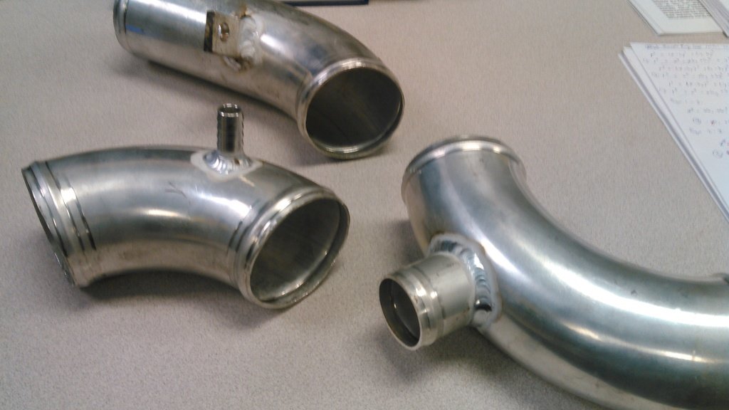

    Mods to IC pipes: The BOV works better when it's closer to the compressor, so I move the BOV to the hot side charge pipe. A fitting for the aforementioned post MAF breather is also shown, along with a support tab to keep the piping from flopping. I also rolled beads in all the pipes.
