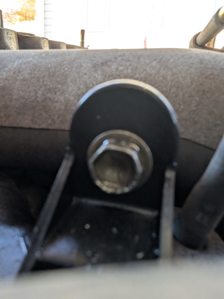

    Got the top half off. There is a bolt on the back that will not come off. Blasted it with PB. Nothing. The head is slipping on a 10mm socket and wrench.
    Am I screwed??

    I mean how would I even do that and then get the severed bolt out?
    Worst design I've ever seen.
    A 10mm wrench seems to hold it but if I wrench hard, I get nothing.

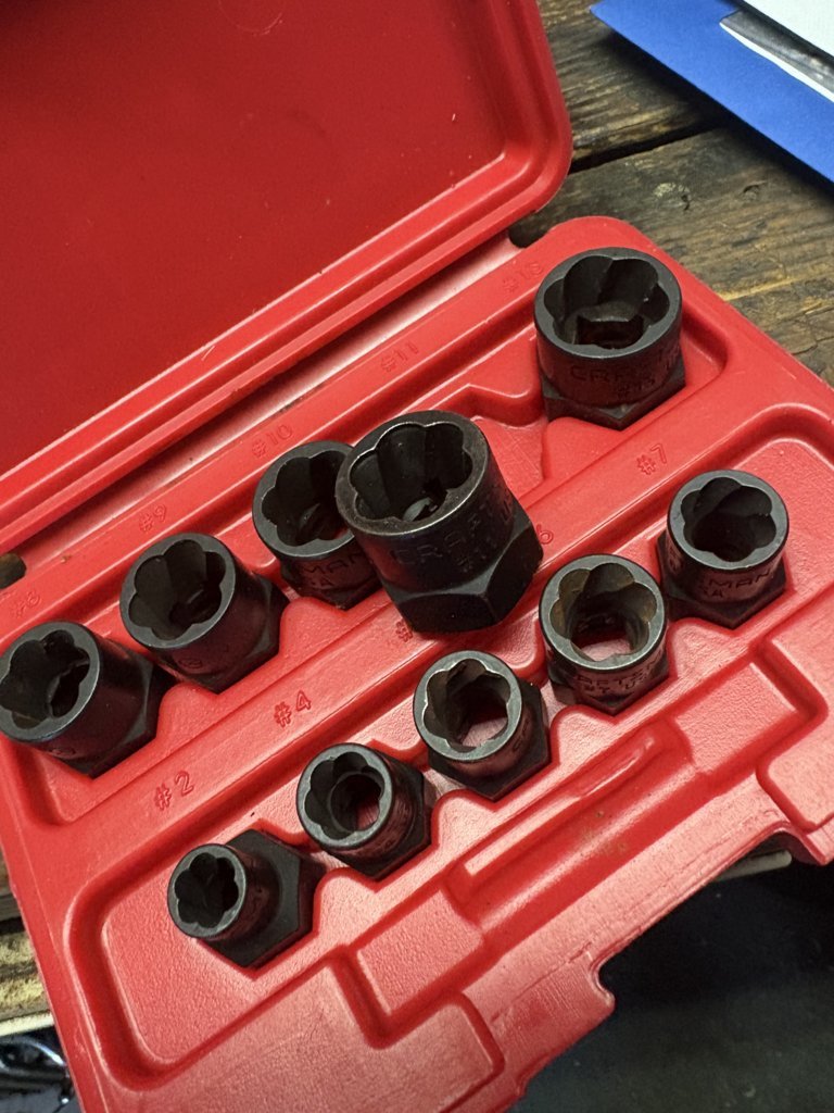

    Bc you are going have tons of room up top
    Should be piece of cake
    Use something like this
    Not too expensive at HF or Amazon
  5. Jan 29, 2025 at 2:47 PM

    A good set rocks.............
    Heating it with a induction heater first works even better.

    I'd try a vice grip.
    If that bracket is plastic, I'd honestly just break it off and find a way to secure it later.
    Penetrating fluid doesnt loosen fasteners, it just makes it easier once things start to move.

    Good news re: that plastic bracket. I melted the f' out of it when trying to use a heat gun on the bolt.
    I am going to buy that rock set from HF tomorrow.
