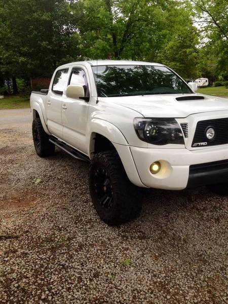

    I ordered it off ebay when I bought the truck. I have never seen another one like it since. Stull enterprises or industries (something along those lines) is where it came from. It was chrome but I painted it black. I actually have two. The first was damaged during shipping. I had the other one powder coated and still have yet to put it on. I will probably end up selling this one that is on the truck now.

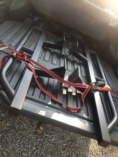

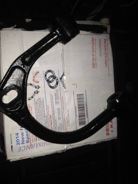

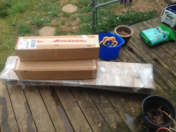

    :woot:Well I have almost everything now, just waiting for brake lines :thumbsup:
    Shackle flip:
    [​IMG]\
    Light Racing UCA's:
    Full OME kit with Dakar leafs:

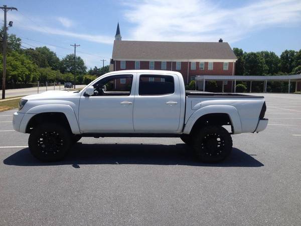

    So I have the lift installed. I didn't take any before numbers because my springs and such were so shot, the numbers wouldn't mean anything.
    Before:
    After:
    I read a ton on here before I did the install, I believe that made it that much easier. When I started to tear apart the rear end it seems as if I had done it before somewhere. I didn't take as many photos as I wanted too while installing but I did get a few. This is just before the point of no return when I cut out the factory shackle hanger.

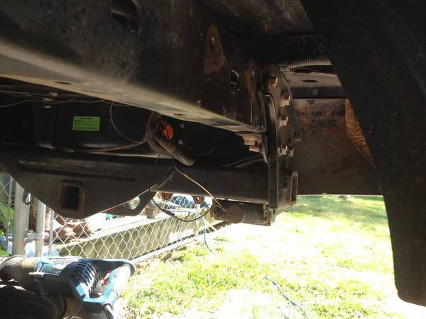

    Here is one with the hanger removed:
    The rivets were not bad to get out. I cut the two on the side of the frame off with a sawzall. Then, since i wasn't going to use them any more, cut the hanger itself just before the curve for the bottom of the frame. After that, the lower rivets were removed with an angle grinder. once they were gone, they were center punched and drilled through. I drilled the center of each one out 4 times starting with 1/8", 1/4",3/8",1/2" (i think that was it).

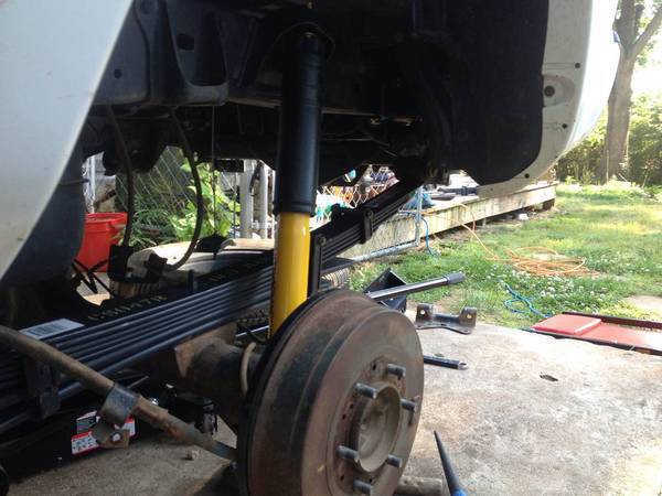

    Rear end being put back together:
    Getting the front end of the rear spring into the hanger wasn't that bad. I read where some had issues getting them in. I used a rubber mallet on the back of the spring and then used a spud wrench to line up the bushing sleeve with the hanger holes.
    Pic with both sides done showing the shackle flip:
    The truck drives MUCH better now. Especially off the start, and going through the gears. No more axle wrap issues from the worn out springs.

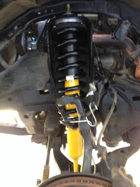

    This is mid install of the front:
    I don't have any pics of the LR UCA's going in or installed. The bolt for the UCA that needs to come out was probably the hardest part of the whole install. I managed to get it out without cutting, and even reinstalled it from the front side. A hammer and long narrow punch are a big help in getting that bolt out. I also did not reinstall the factory sway bar.
    I ran out of time for the brake lines, so I still have a little work to do yet, but here is how it sits now:

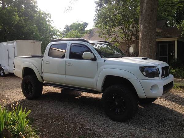

    I picked up a roof rack from sutton (thanks buddy). It has a little rake to it but I think overall it came out great.

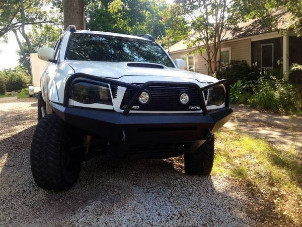

    [​IMG]New plate bumper from SOS concepts.
