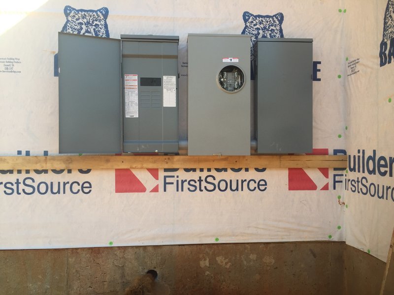

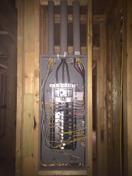

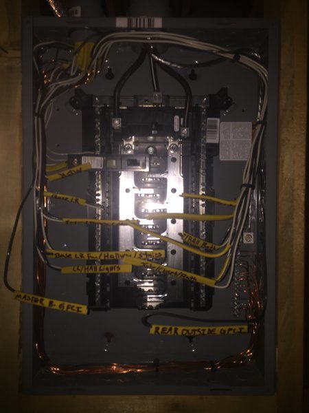

    @Cars0n`
    Hard to get any real good electrical pics.
    Switch box:
    100amp panel:
    200amp panel:
    I can crack open the service panels if you'd like, but I think you know what's in there.........more wires, just a good bit bigger.

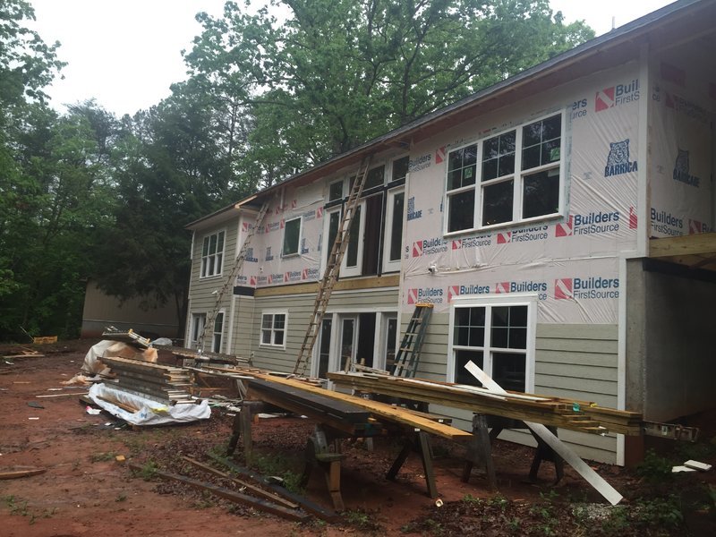

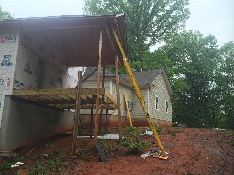

    image.jpg They hit a good bit of siding today:
    loginfailed likes this.

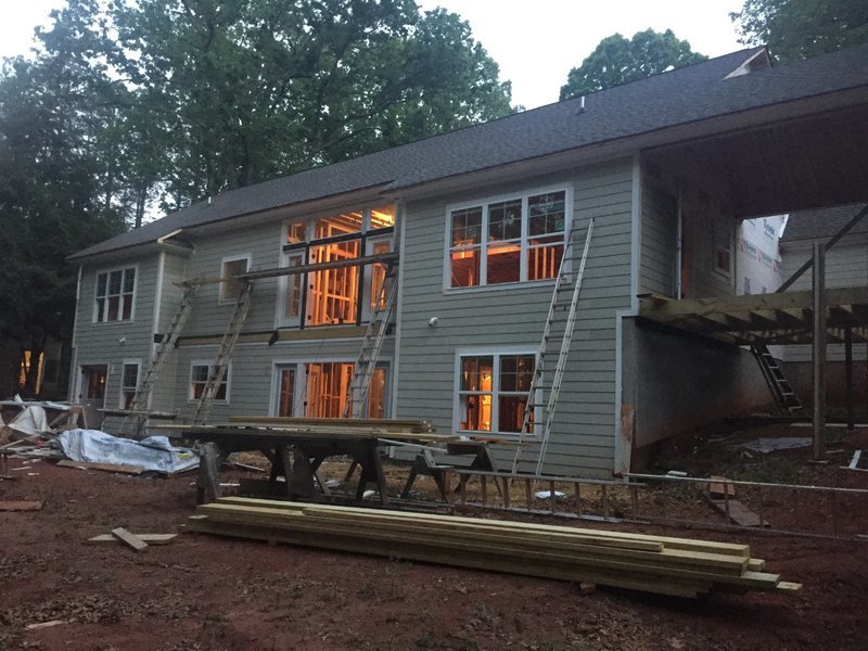

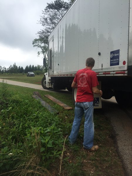

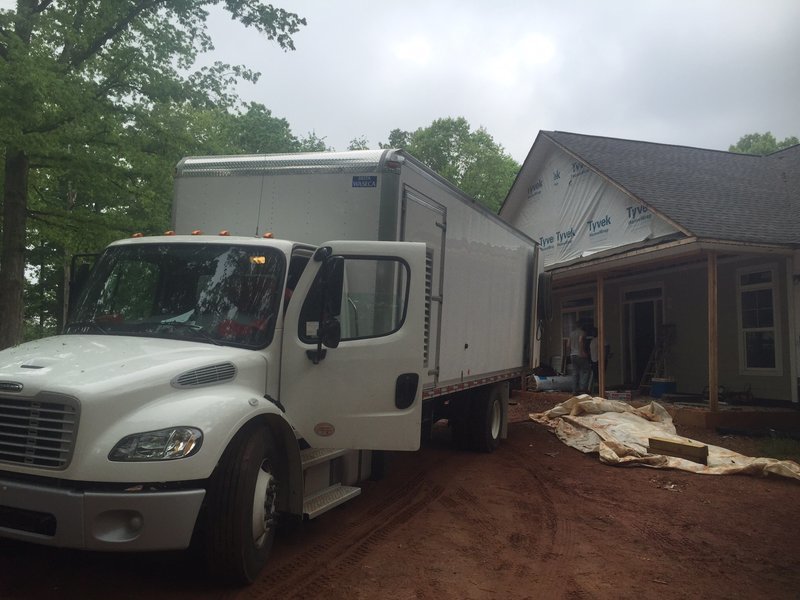

    Today was crazy.
    Siding guys cruised:
    image.jpg One side left, that they are almost done with.

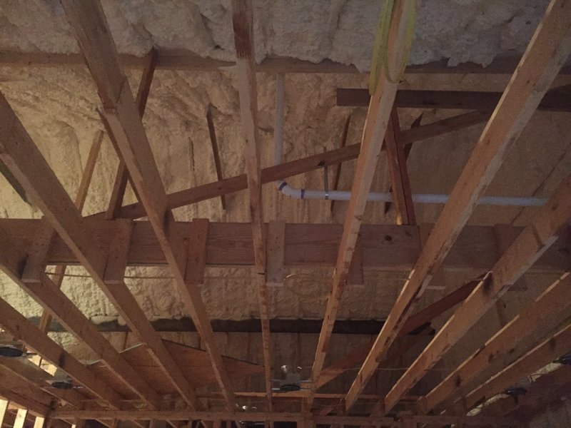

    Now for the fun part. Insulators didn't show up till around 10:30. I could hear them at the end of the driveway. About 20 minutes later a guy come up the drive and says, "we can't get the truck up the driveway, we'll prep the site and come back tomorrow with a smaller truck".
    That's when their bossman called me. He said "don't you have a bunch of 2x10's over there"? (He saw them on the walk down when he did the estimate).
    "Let's build a ramp and get that truck in there today".
    I loaded up the skid steer with some lumber and headed down to the road.
    The fuel tank for the truck was scraping the ground when they tried to get the truck in. We had to scotch up the front to get it over the hump.
    Success
    They left around 8:30, I just got home.
    This is going to be great. So glad I did the foam.

    Looks like 1lb foam yeah ?

    Not sure what you mean by 1lb.
    The product is Classic Max foam, open cell Icynene.
