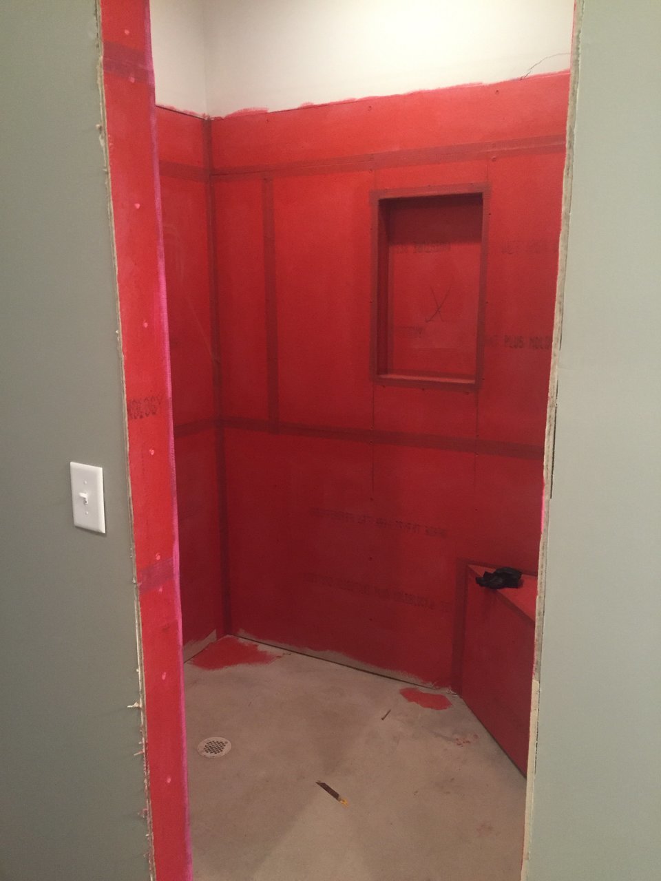

  4. Dec 9, 2017 at 4:59 PM
    #324
    holyfield19
    holyfield19 [OP] GO TIGERS!
    Jan 13, 2011
    #49179
    4,037
    Bob
    South Carolina
    06 DC TRD Sport 4X4
    Busted CV boots and lots of squeaks.

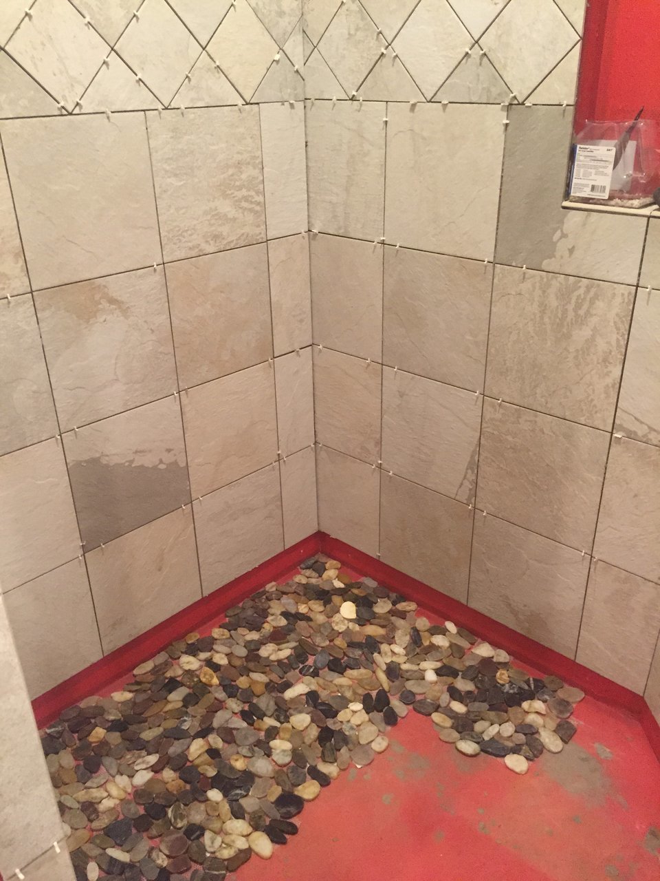

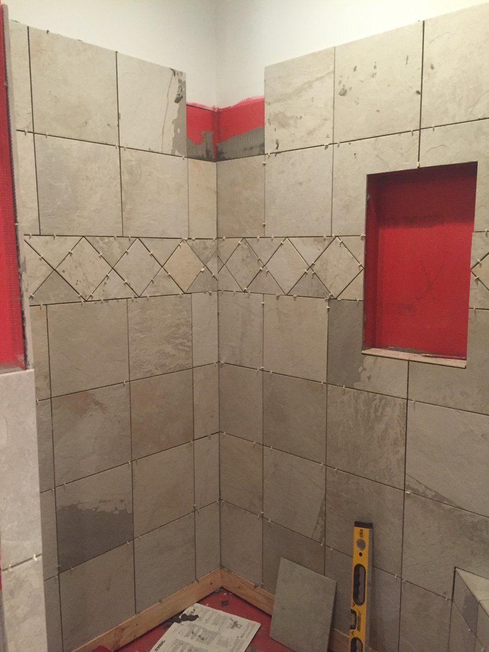

    First coat of Redgard on the shower.
    My plan is to put a second coat on the walls, and set the tile, leaving out the bottom course.
    Then, coat the floor with the Redgard (2x), set floor tiles and fill in the bottom course on the wall.

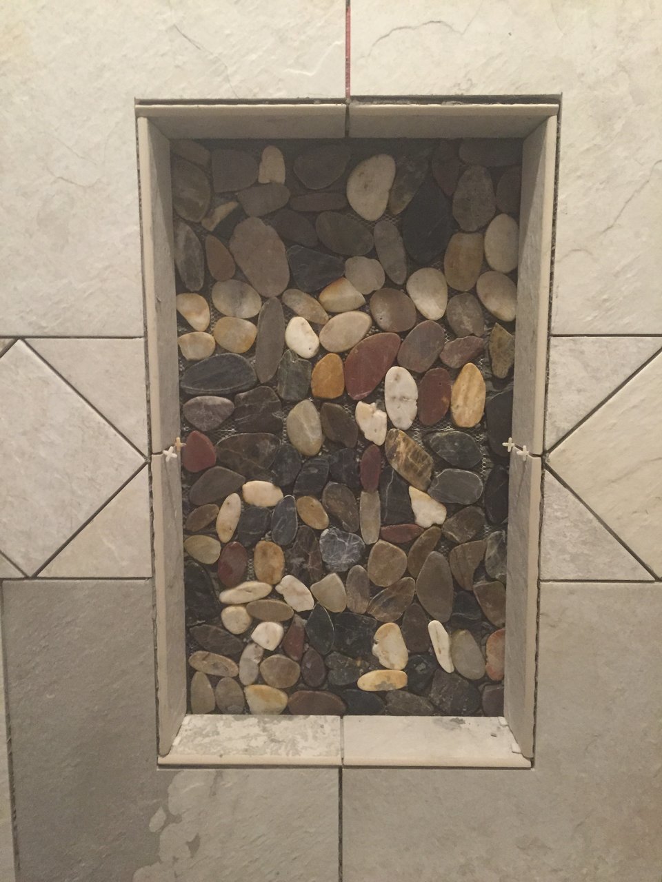

    Just laid a few sheets of the stone out to see how it's going to look. The back of the niche will be stone as well. I'm going to call the guy who did my granite, and see if he has something I could use for a shelf inside of it.
    One more day I should have the shower finished. Not sure why, but this is one job I have been sweating. It sure is a bunch of work.

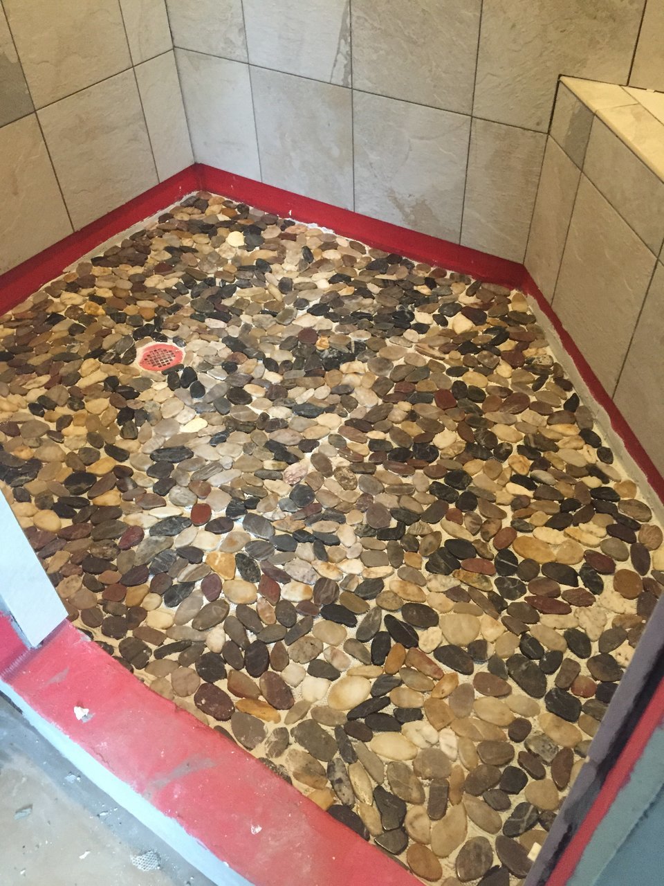

    Grout the floor tomorrow, finish the walls Saturday, grout the walls Sunday.
    I really miss this type of work. I have been out of it for the last 8 years. When I stop and look around at what I'm doing on my own home, I feel as if I'm wasting my given abilities. Take that for what it is. I just really miss doing this stuff for a living.

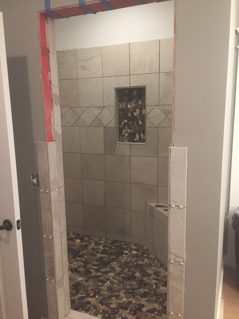

    I really wanted to finish this today, but I ran out of bull nose tile. Maybe tomorrow.
    Toyko Joe, Acerwin and scottalot like this.

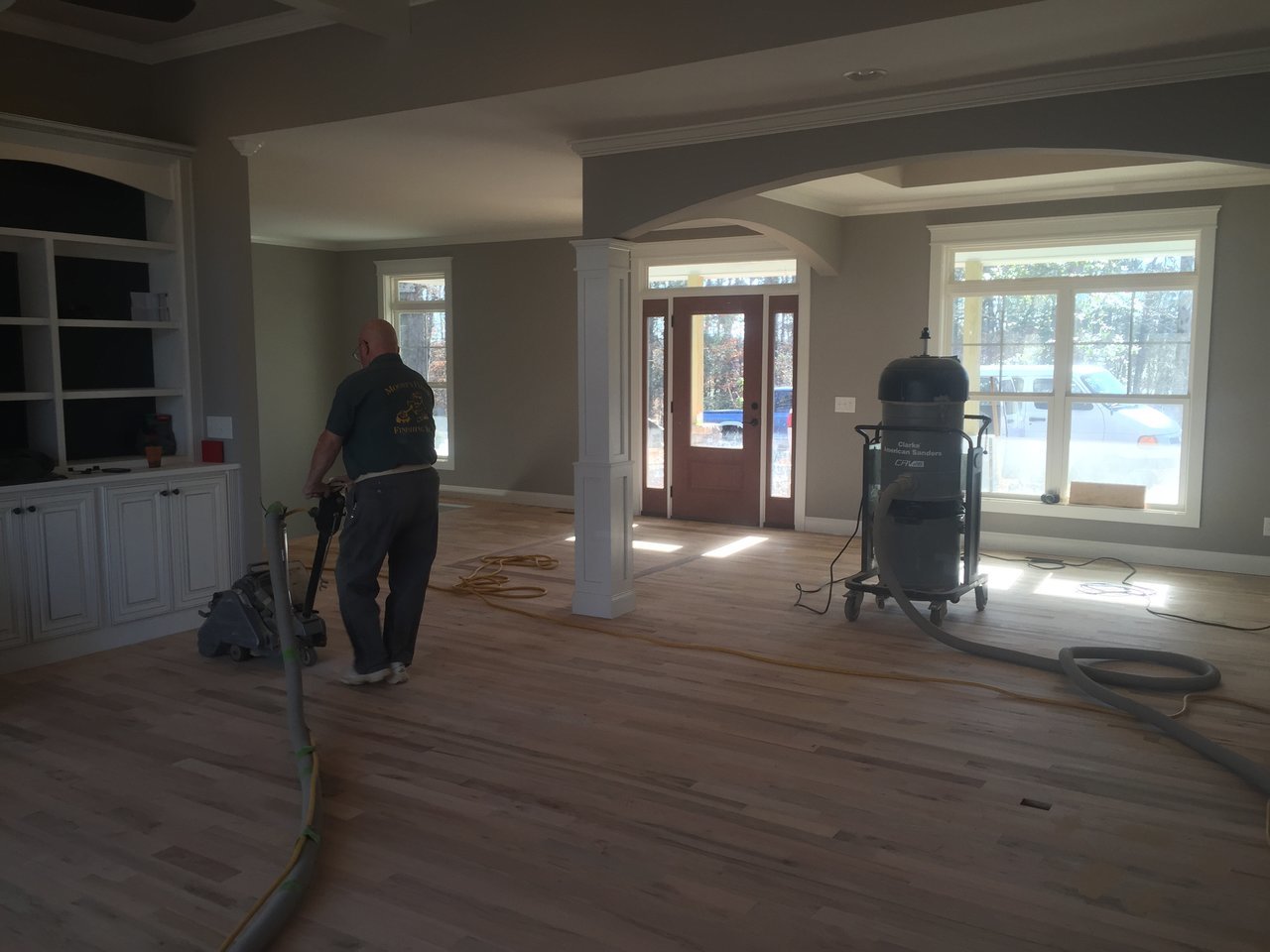

    Floors are getting sanded this weekend. We are starting tomorrow morning.
    A friend of my father in law is going to let me use his dustless sanding equipment. We got everything set up inside the house this evening, ready to tomorrow.
    This is a huge step towards being done by the end of the month. Hopefully if we get it done in about two and a half days I will have time to form up the driveway this weekend as well. It is supposed to warm up a little next week. Hopefully I can pour some concrete.

    15 hours straight for me yesterday (only took a break to stand up and stretch my back out). We got the whole floor sanded, edged and scraped. Now for the buff and vacuum and 1st coat. Jack was able to help me yesterday, and stayed later than I had expected. Way ahead of the schedule for now. Still need to send my wife to go pick up the finish. Going with a satin waterbase from Bona.

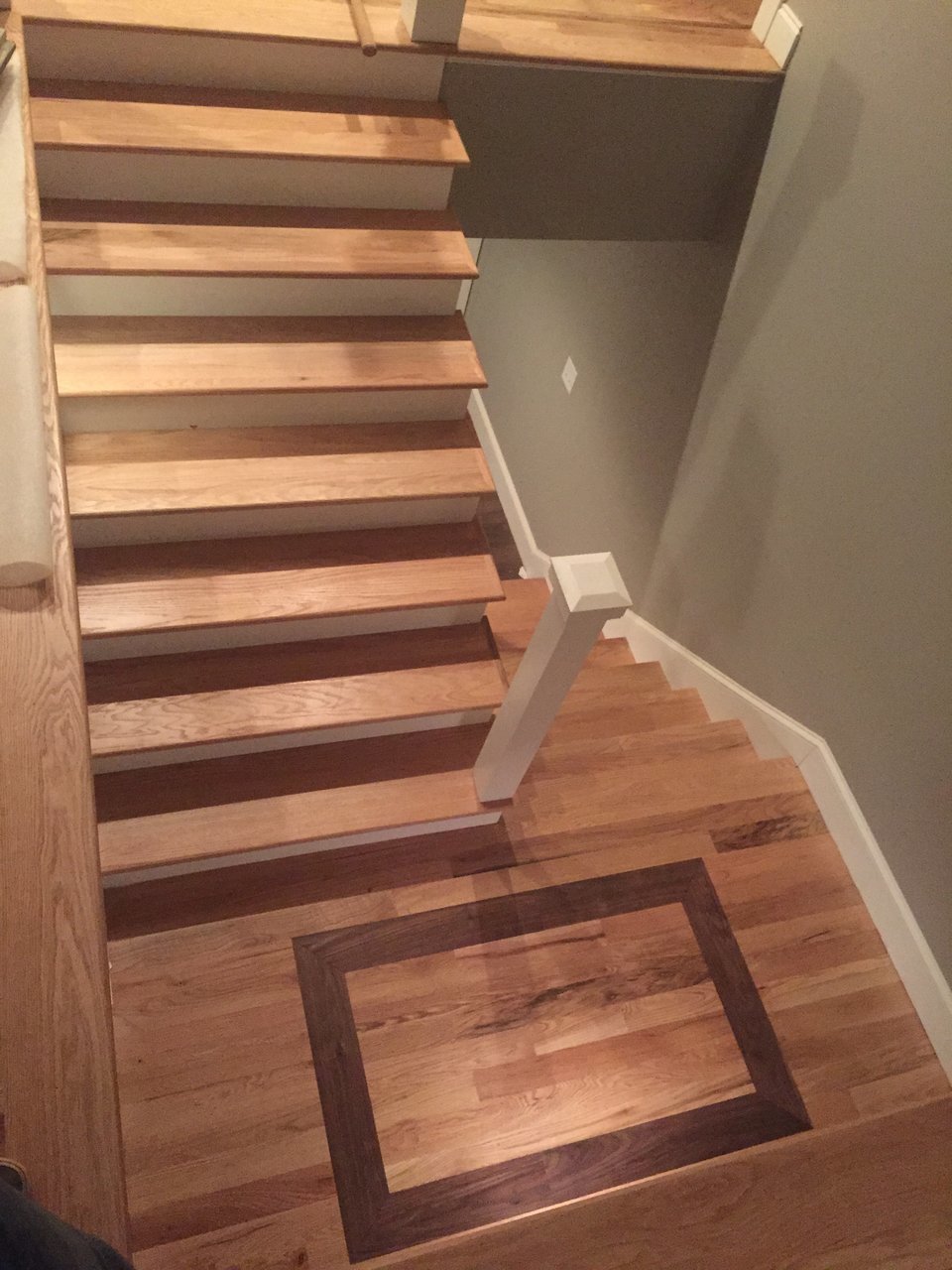

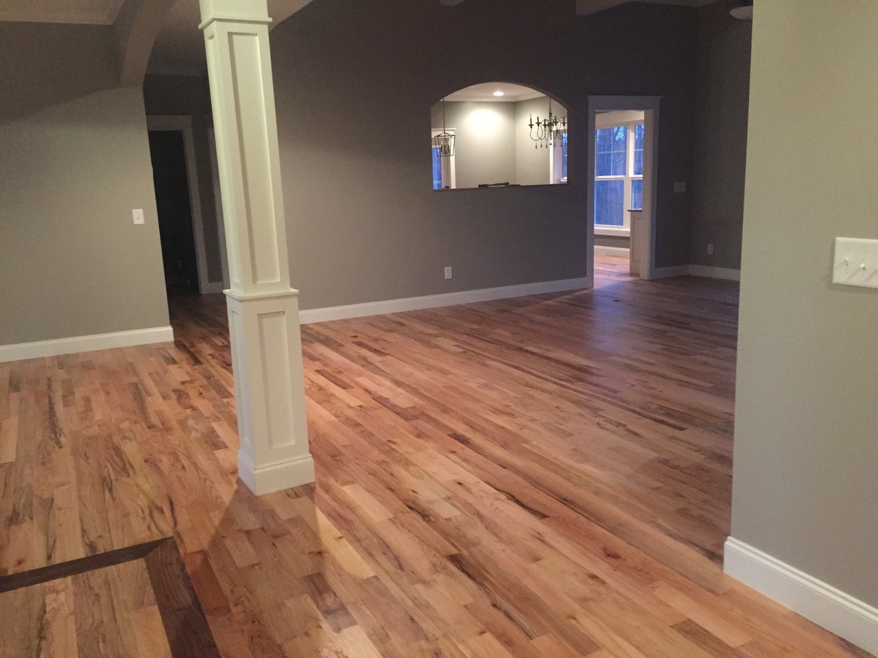

  12. Jan 5, 2018 at 4:43 PM
    #332
    holyfield19
    Jan 13, 2011
    #49179
    4,037
    Bob
    South Carolina
    06 DC TRD Sport 4X4

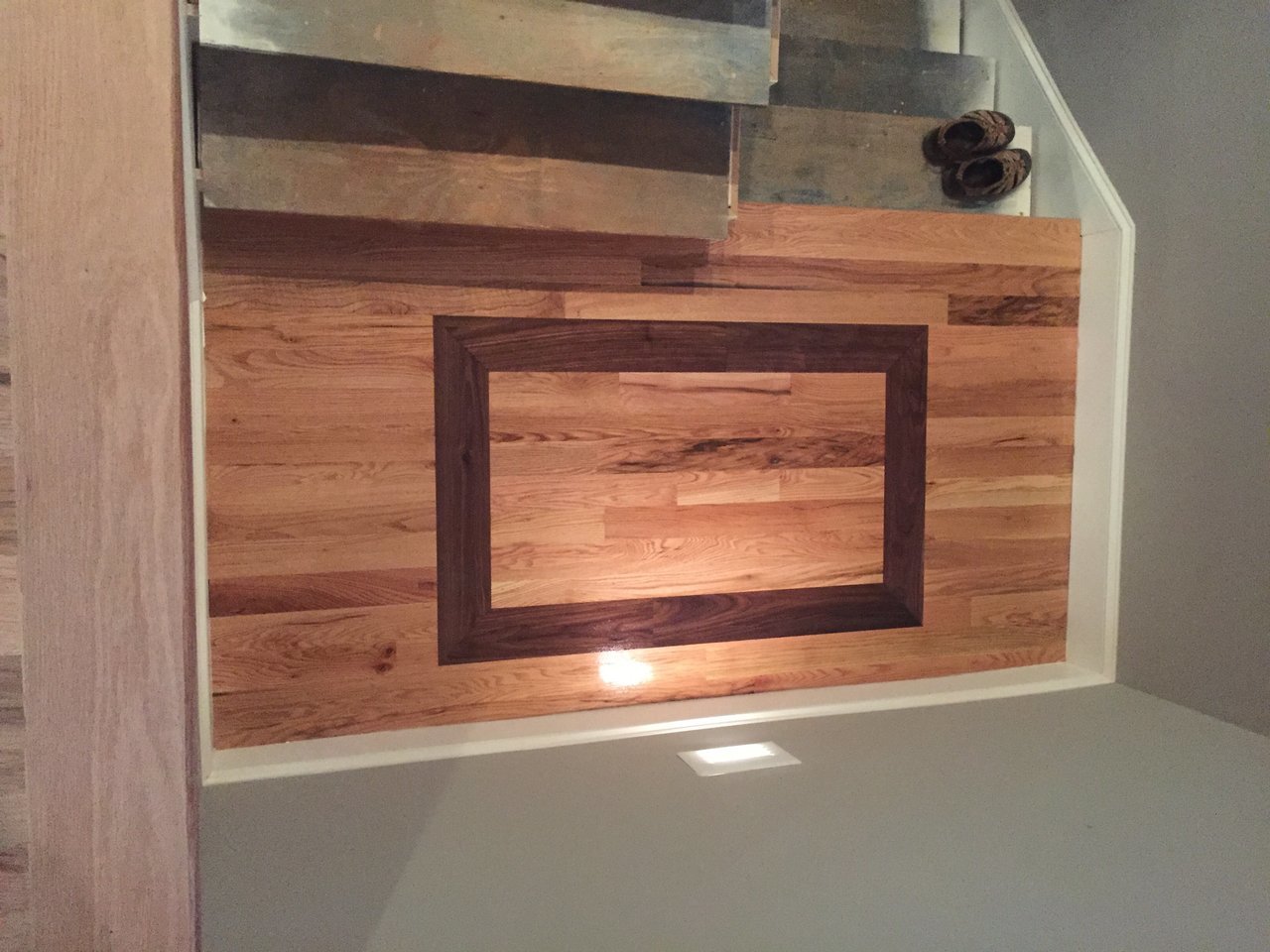

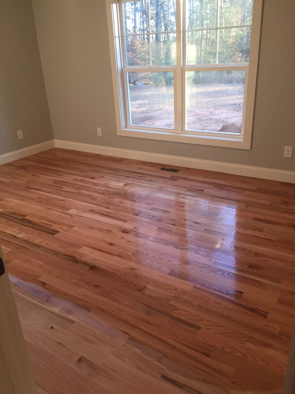

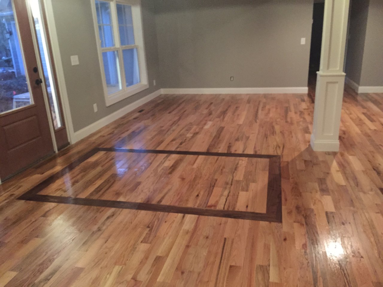

    1st coat is on :woot::yay:.
    Ran a buffer all day. Started with an 80 grit then proceeded to 120, 180, and finally a 220. Yes, the entire floor, 4 times. The. The real fun part.....vacuuming.
    2nd coat tomorrow, then I will finish up some other things I still need to do inside, and when that is done, I will do a 3rd coat.
    The Walnut inlays popped out great. I love it. I don't like glossy floors (think they look like high school gyms) so I used a satin finish. Very happy. The Bona water base is a 2 part system. It is tricky to mix up, but soooooo much faster than polyurethane to lay down, and it won't "Amber" over time.

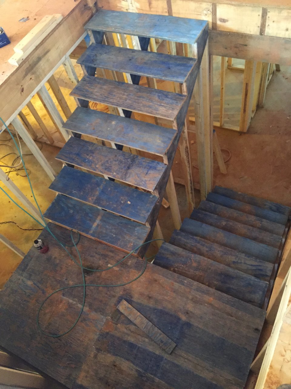

  16. Jan 12, 2018 at 6:33 PM
    #336
    holyfield19
    Jan 13, 2011
    #49179
    4,037
    Bob
    South Carolina
    06 DC TRD Sport 4X4

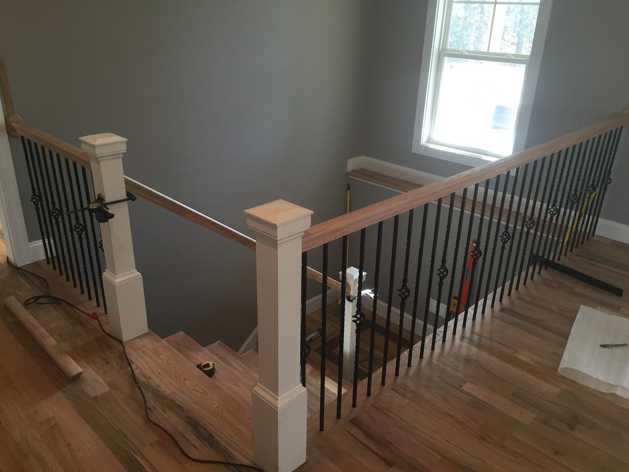

    Stairs are in. Hooray.

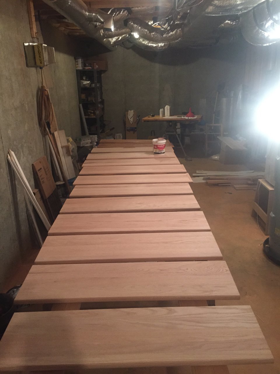

    Acerwin and Toyko Joe like this.

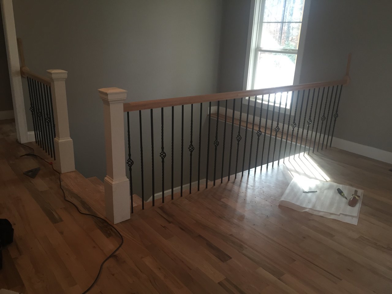

  18. Jan 14, 2018 at 3:47 PM
    #338
    holyfield19
    Jan 13, 2011
    #49179
    4,037
    Bob
    South Carolina
    06 DC TRD Sport 4X4

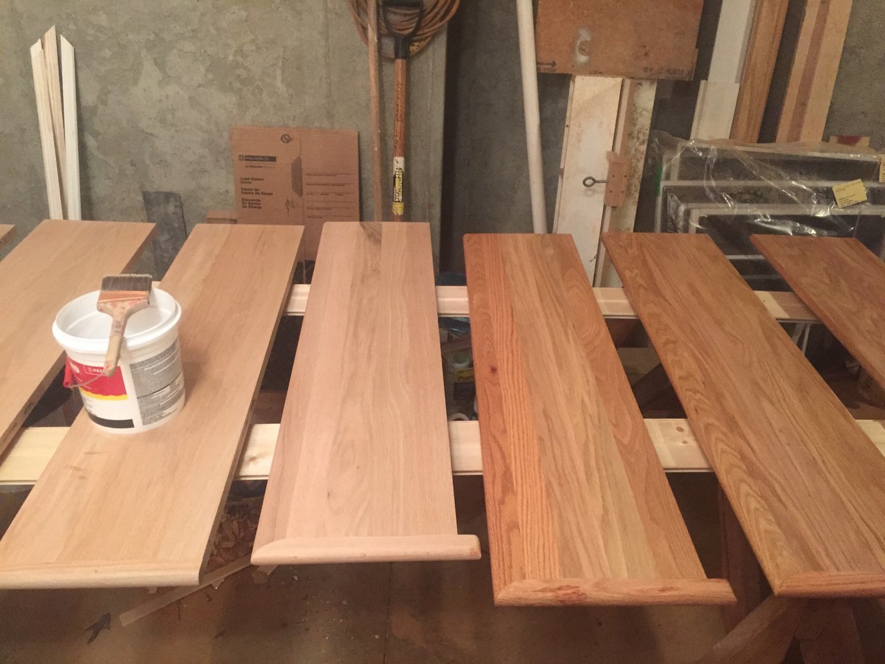

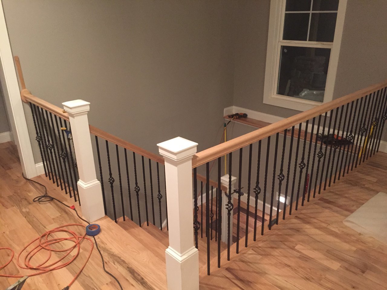

    That was a fun day. Now to take it all back down and sand/finish the rails.
    Acerwin and NC15TRD like this.

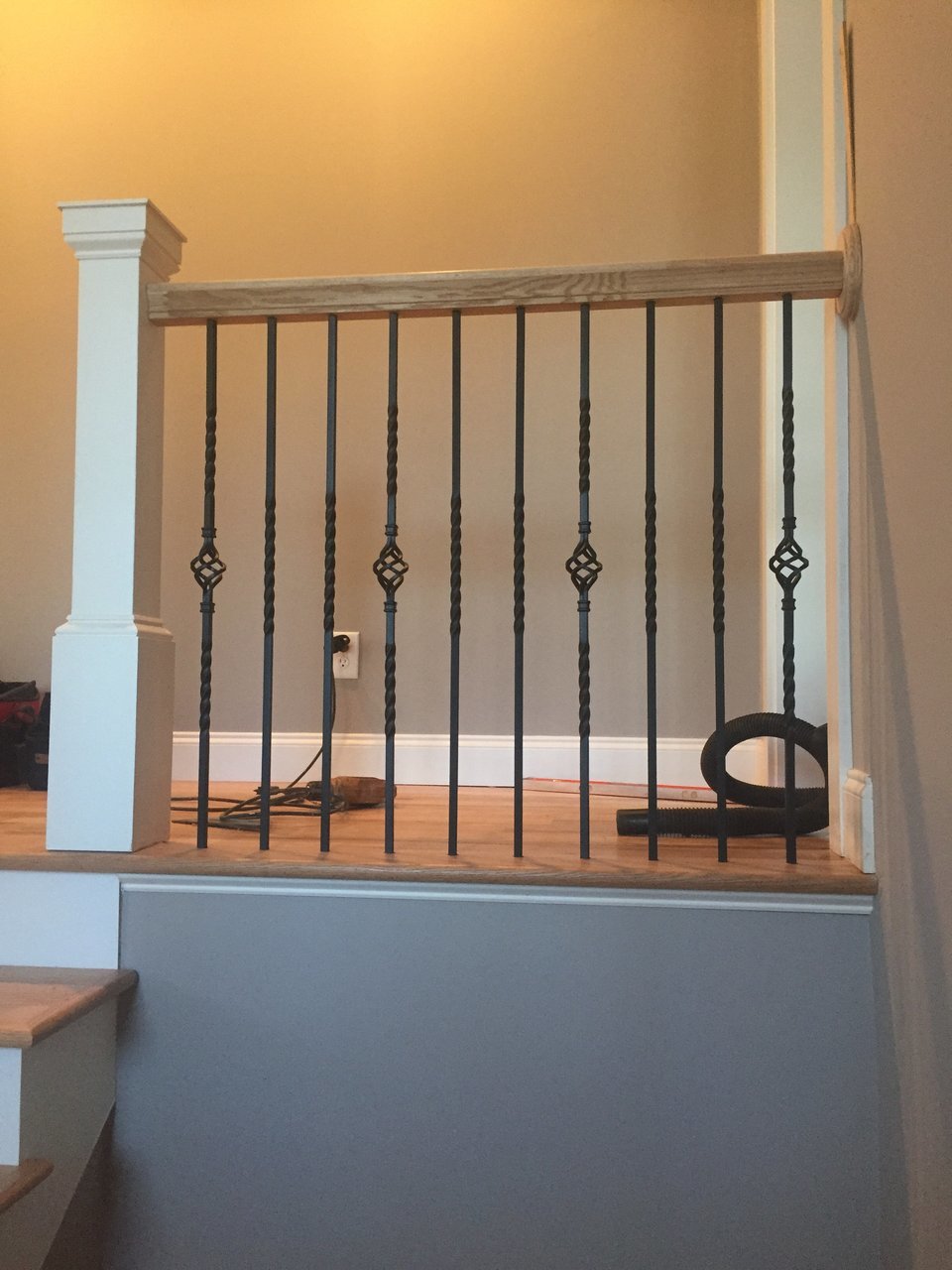

  20. Jan 14, 2018 at 6:56 PM
    #340
    OZ-T
    OZ-T I hate my neighbour
    Dec 15, 2009
    #27584
    50,578
    Peter North
    British Columbia
    Bezdan railing components ?
