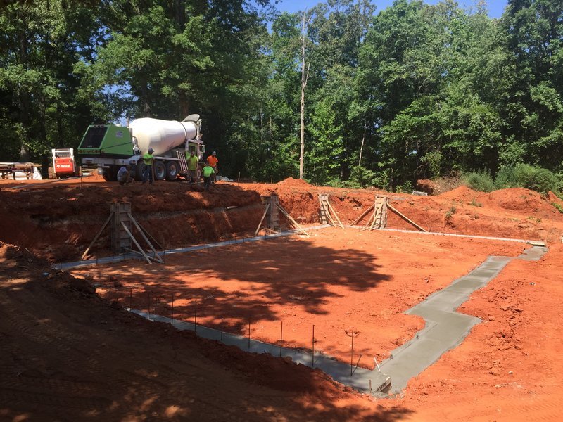

    Holy crap I'm worn out today. Tons of excitement, between finishing the siding on the building and watering down the footers, I'm whooped. It was 95* here today. Ready for a drink.

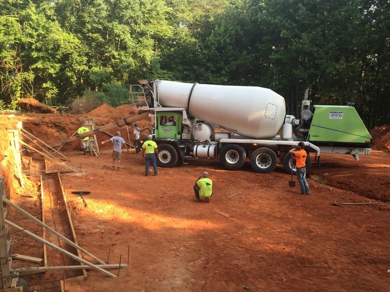

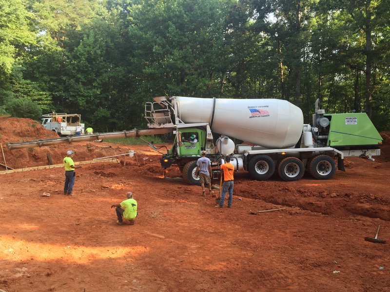

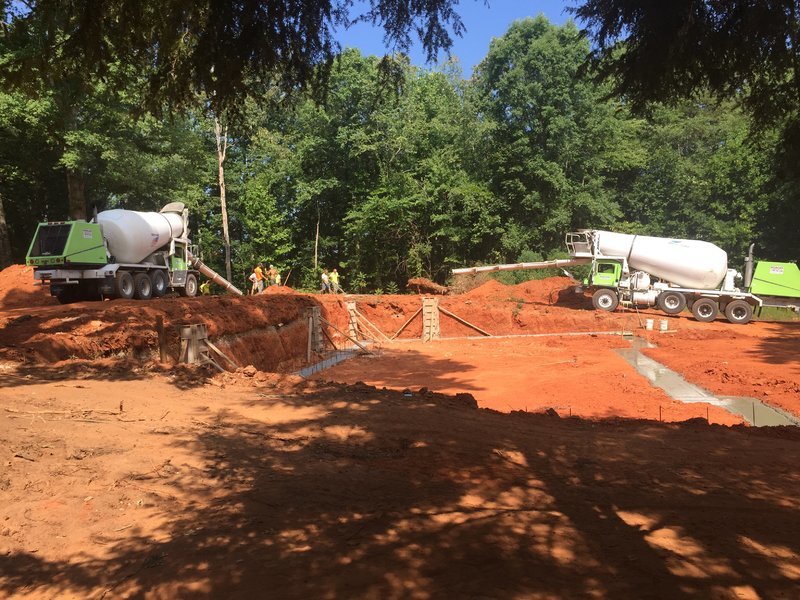

    At one point they were running two trucks at a time.

    Those backwards facing cement trucks always trip me out.

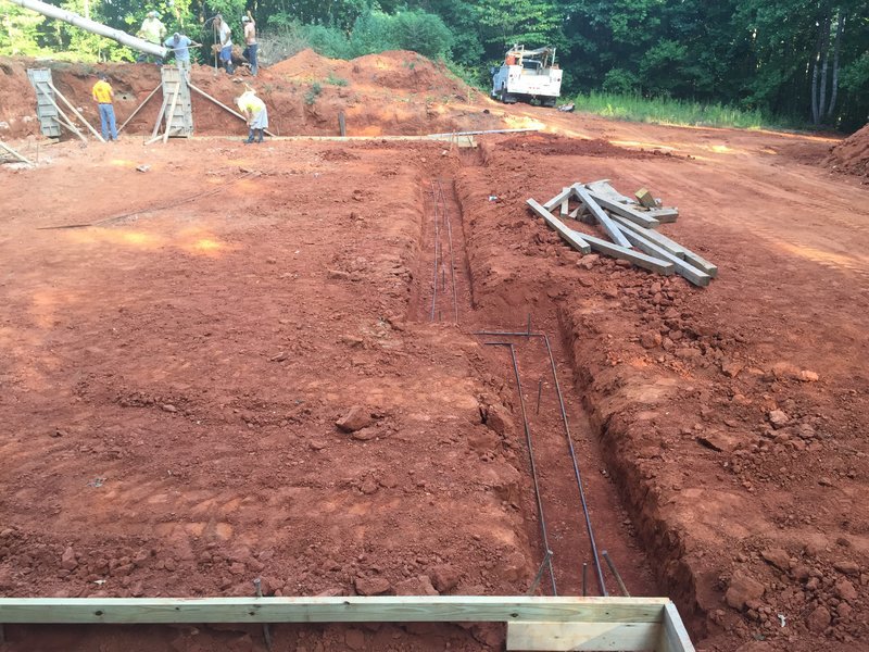

    @OZ-T
    Here is the rebar. If installed prior to inspection, it needs to be grounded 8' and also a lead tied to the main panel. Amongst other things, too much of a head ache to deal with if not required. So they put it in after :thumbsup:
