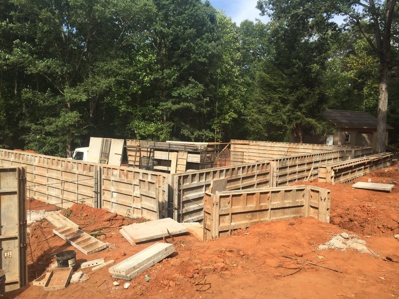

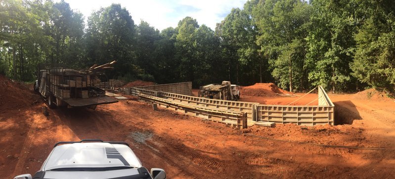

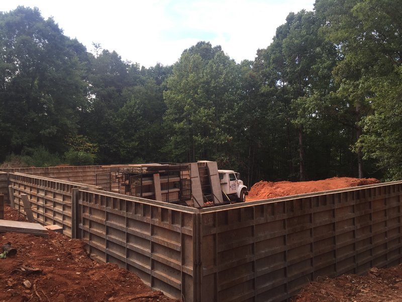

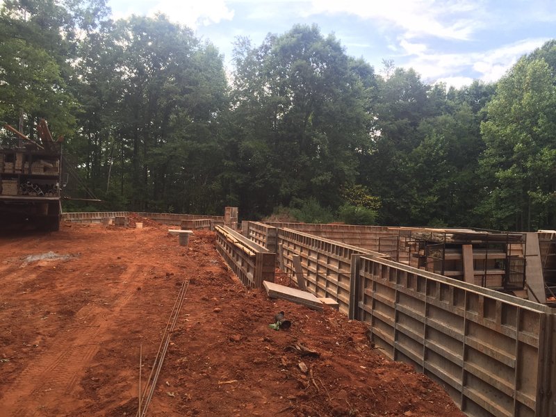

    image.jpg Started to form walls yesterday. They should finish up today and be ready to pour tomorrow, and remove forms Friday.

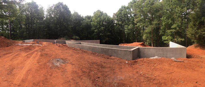

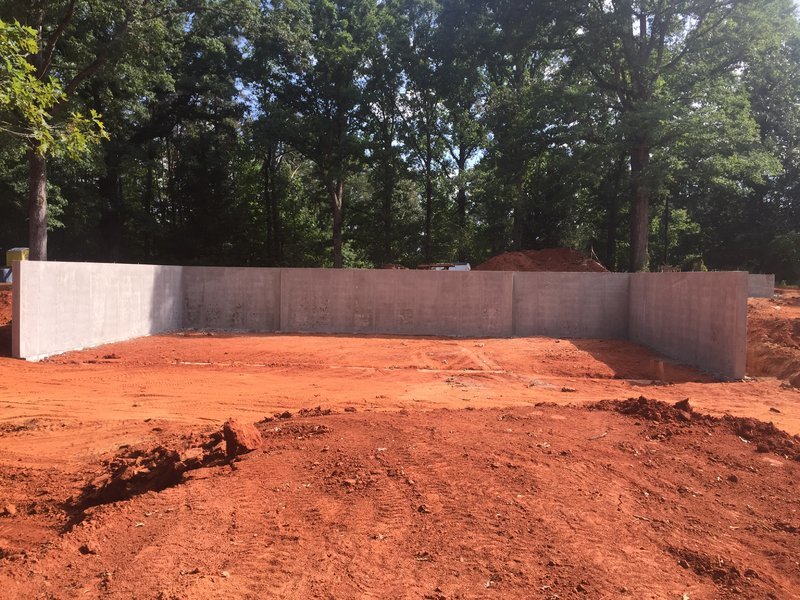

    They stripped the forms today. Walls look good, not as smooth as I would have liked but that is not really a big deal. There are ways around that to make it nice on the inside, and it may help with a textured look on the outside. I will need to add a few anchor bolts in some places, and from a rough measurement, it is about 1/2 to 1" off here and there lengthwise. I am going to put a water level on it to check for levelness across the tops. Still have to check it for square and see how it comes out. The garage is dead on.
    9' walls for the basement.

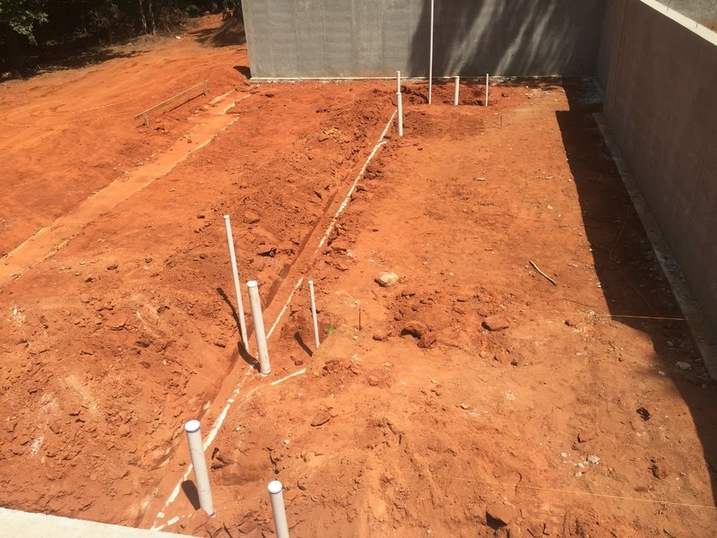

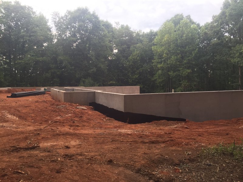

    Been doing some work. Plumbing under slab is ready, and waterproofing is almost complete. Getting stone delivered tomorrow to finish that.

    Passed the plumbing, foundation and waterproofing inspections this morning :thumbsup:.
    Going back this afternoon to start backfilling everything. Might have a basement slab by this weekend.

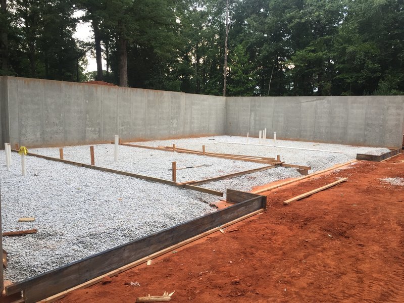

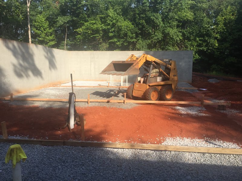

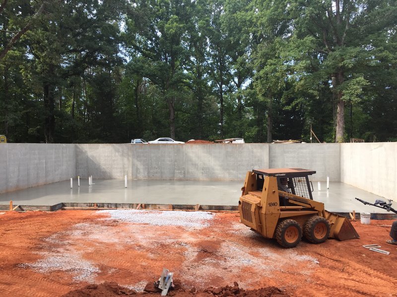

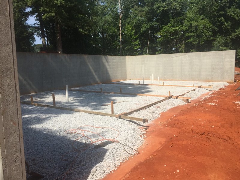

    Been a little while since I've made an update. I have been very busy. Spreading and screeding stone into the foundation:image.jpg image.jpg

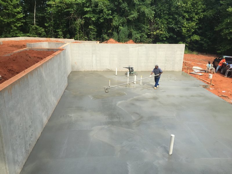

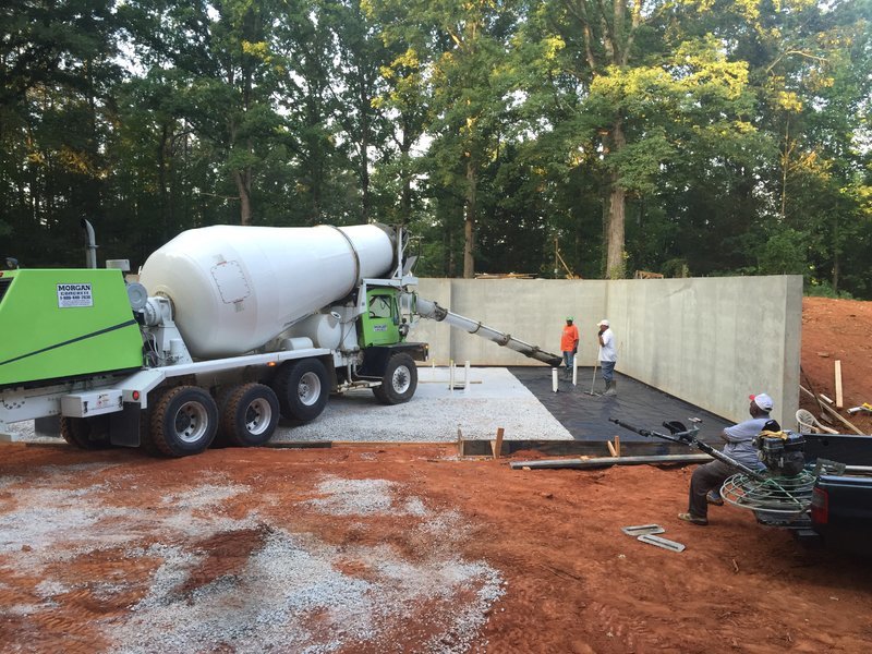

    I formed up the back wall for the slab with 2x10's and made a removable middle section for the concrete truck to pull into. I was very lucky, not one pump truck has been used on this job site. They were even able to pour the walls out of the truck. image.jpg image.jpg image.jpg image.jpg
