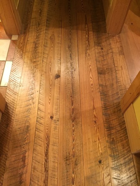

    I was also lucky enough to have an old tobacco barn so I stole the heartpine floor planks, 3s planed them, and lightly sanded the tops, followed with water poly. Has held up well to boots and mud very well.

    Same here, been a finish carpenter/tile/etc since the nineties. Doing a ground up resto on a bathroom with full tile shower now. Here's a couple shots of the barn floor. Went through three sets of planer blades on these planks. Dewalt 13" planer was howling! Left the original kerf marks where I could. No stain. Satin water poly.
    Ritchie, Boerseun, SC2SC and 2 others like this.

    That looks great. The saw marks add a lot of character. In the house I live in now, I laid 3 1/4" red oak crap. It is knotted up, worm holed, cull pile junk.......it looks awesome (well it did when I first put it down.....kids toys and dogs).

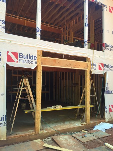

    I just had to cut the header out for the main basement exterior door. It was 2" too small and I didn't realize it until last night. PIA but not too bad to do.
    Almost finished. After this I am moving the exterior door in the garage (that should be fun).

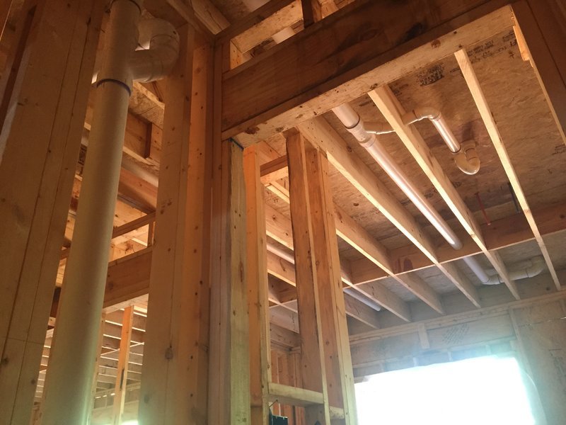

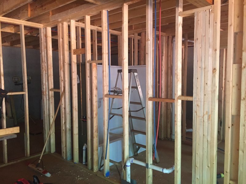

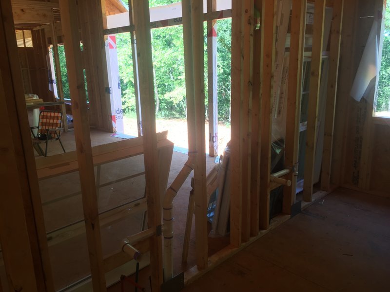

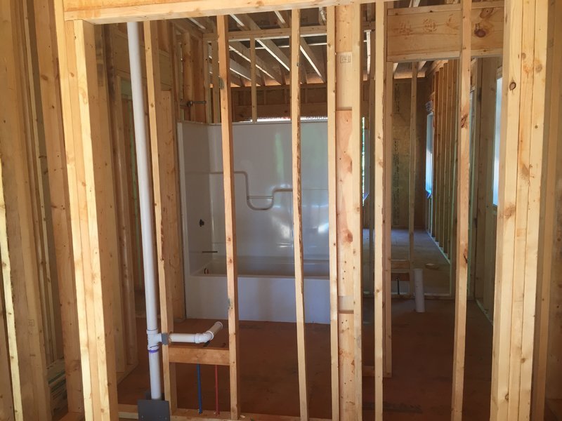

    I know there is money in it, but dang I don't like plumbing. The waste is done (minus vent out the roof), supply is 40% complete. I ran out of Pex and need to get more. 1 million different kinds of fittings make plumbing a major PITA. If you don't have one certain thing it will ruin your day. image.jpg image.jpg image.jpg image.jpg image.jpg

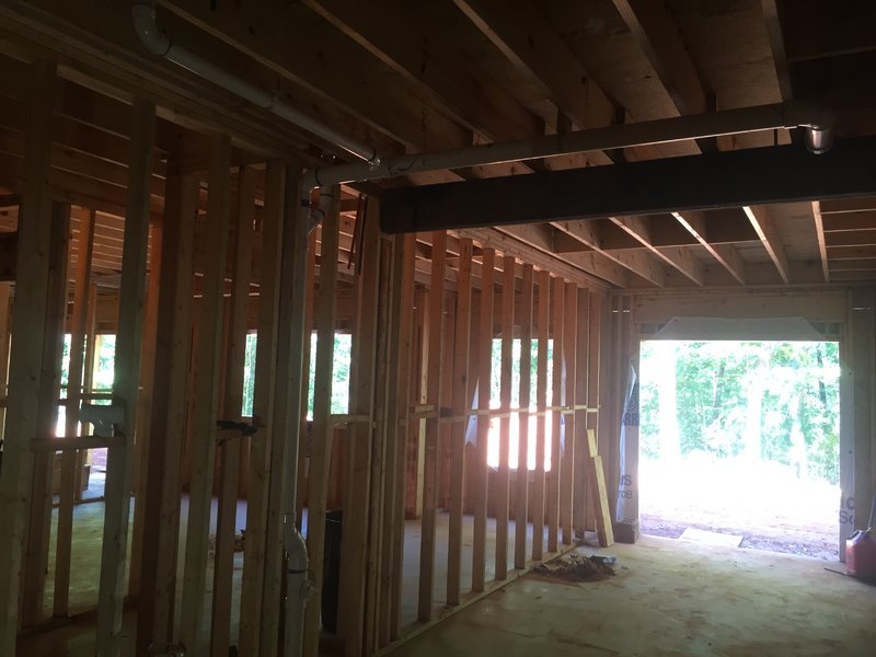

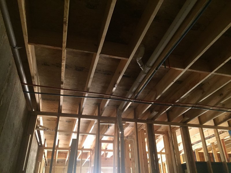

    Another major PITA is the fact that the ceilings in the basement are finished. I have to tuck everything up into the 2x10 floor joists. I tried to get my wife to let us put in a drop ceiling and she said no. We will see. The HVAC will be another headache in that area as well.
    Chipping away, doing what I can.
