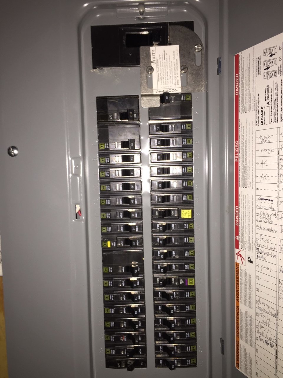

    Here's my solution. My home is about 1400sf all electric. I bought a new GP17500E Generac portable. Total output on 2 feeders, 80A/240VAC continuous. I ran the 50A/240VAC generator feed directly to my main panel and installed a MANUAL transfer switch in the panel (simple lockout slide bar). I ran the 30A/240VAC feed from the generator to a Reliance CRS-302 manual transfer switch at my heat pump (replaces the required unit disconnect), and allowed me to easily switch the heat pump on/off or back and forth between the two feeders in the winter, when I may need extra capacity for electric heat. I also installed 2 voltage/current digital meters at the main panel, mounting them in a 2-gang plastic electrical box and a cut-to-fit plastic blank cover.
    https://www.amazon.com/gp/product/B00DVH64HW/ref=ppx_yo_dt_b_search_asin_title?ie=UTF8&psc=1
    The meters display real time L1 and L2 voltage/current of the genny's 50A connected load. This allowed me to balance the load between L1 and L2 by swapping breakers between legs until it's as even as I can get... very important to balance the genny output. Plus I can control any overload by switching breakers on/off as necessary, but in 10 years I haven't needed to, and it runs the entire house. I was prepared to install a soft starter on the heat pump if needed, but the 30A. genny circuit handles my startup LRA (locked rotor amps) of about 60A. easily, and saved me about $250.:thumbsup:
    The genny lives in an existing stick built 8'X12' outbuilding, with a 12" shuttered wall exhaust fan, which provides complete air changes every 50 seconds. It pulls in air from the roof ridge vent, keeps the genny cool even in the hot summer, keeps the noise enclosed and 40' away from the house, and no modifications to the genny exhaust. Gas tank holds 15 gal., burns 1 gal./hr. 99% of outages around here last 1-4hrs. I have backup stabilized gas that I rotate, stored in a separate building.
    I also installed a beep type sounder (sounds like a smoke detector) and a switch connected to the utility line at the main breaker. I turn it on when power goes out. When it beeps, power is restored, I turn it off, turn on the mian breaker, shut down the genny. It's intrinsically safe, no fuse needed.
    This is a simple setup, meeting all NEC requirements and has no "automatic" devices to rely on. I don't need any load control panels, cellphone monitoring, auto-startup, giant propane submarine in the yard (and delivery delays during/after a storm) etc.
    Suits my self-sufficient demeaner perfect, and all for around 3k, not including the existing outbuilding. :thumbsup:
