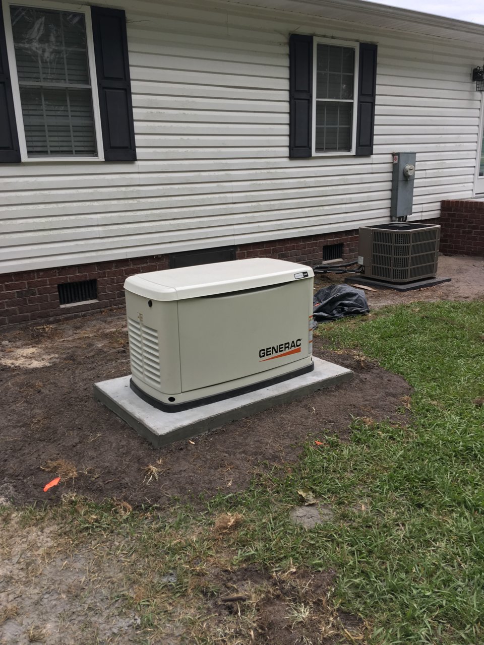

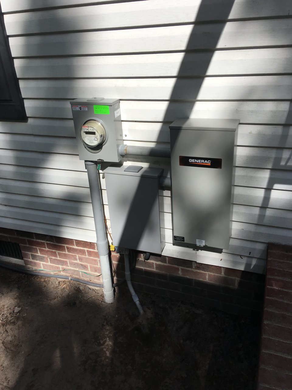

    Update! Generator is installed and online. I did end up saving a lot of money, but man...what a headache! The only thing that I ended up doing myself was actually picking the generator up from Lowe’s and mounting it on the concrete pad. Everything else was done by licensed contractors with the proper permits, and inspections. My lowest bid was around $10,350 for a turn key job, and I had already purchased the propane tank, and had it filled.
    So I ended up with the 22kw sitting on a 3’x5’ concrete pad, automatic transfer switch (with the option of manual transfer of it fails), used 320 gallon propane tank that I own, and is full of lp, tank hook up, regulators, and gas install, electrical hook up, including having to change out my meter box because it was a combo unit, and no way to legally install the transfer switch. Total bill $8,140.00. In the first picture you can see my combo meter in the background. Second picture is what the panel looks like now, minus the generator main feed in (it wasn’t finished when I took the picture.8952218C-BD58-4771-9B4B-1EFBA65945BD.jpg375D7383-FF57-4783-99AD-AC2575AF543F.jpg

    Very nice! How about a pick of the innerds?
    The unit looks exactly like mine. Of course there could be any engine in there.

    I can get some tomorrow afternoon. It’s dark :30 here now. Anything you’re interested in? The generator set, or the transfer switch? The engine is 1kcc generac v twin, air cooled. Same engine as the 16 & 20 kw I think.

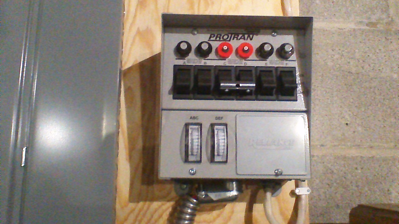

    WIN_20190624_234220.jpg For people that don't have the coin for a automatic setup, or already have a generator ,they make a panel that installs next to your breaker box. You size the panel by need and generator output. Decide what you need to run(how many circuit breakers need to be on) and buy the panel accordingly. The panel has double throw circuit breakers that switch between utility , off or generator power. There is a two foot flexible conduit that attaches to your breaker panel, that holds two wires for every circuit. You take the wire off the breaker and attach it to one wire ,then put the other wire on the breaker. You then run a wire from the panel to a receptacle outside that you plug your generator into.
    I have a small generator ,6000 watts. My panel has 6 double throw breakers. I use one for kitchen, one for freezers, one for garage ( door opener ),one for furnace, and two for water pump.
    In the 25 years I've lived here, the longest I've been out of power is four hours , but it was 3 degrees outside for those 4 hours.
