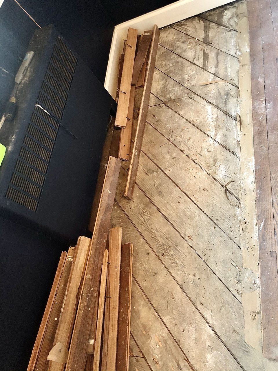

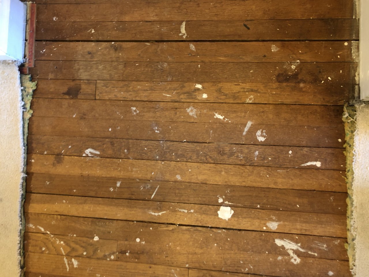

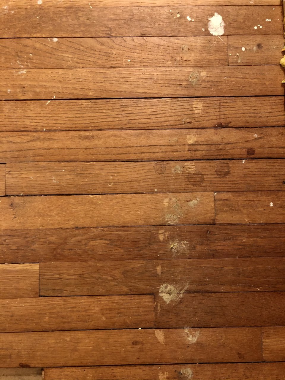

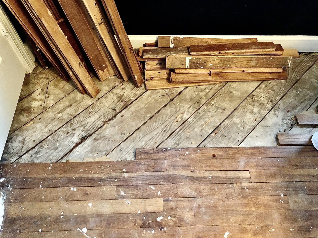

    Here's what it looks like under there.....
    And yes, that old hardwood was a mess. Could've been refinished, but that really wouldn't accomplish anything I was going after. It wasnt an option.

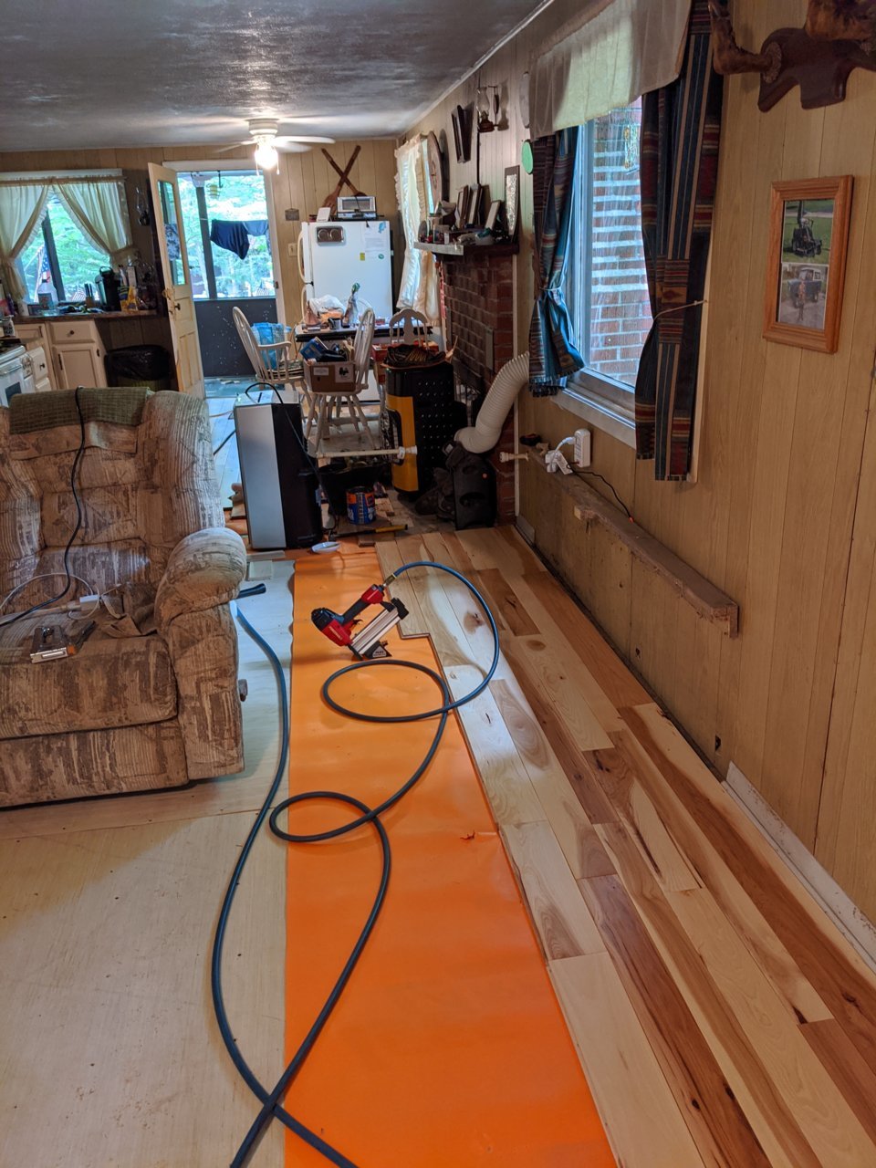

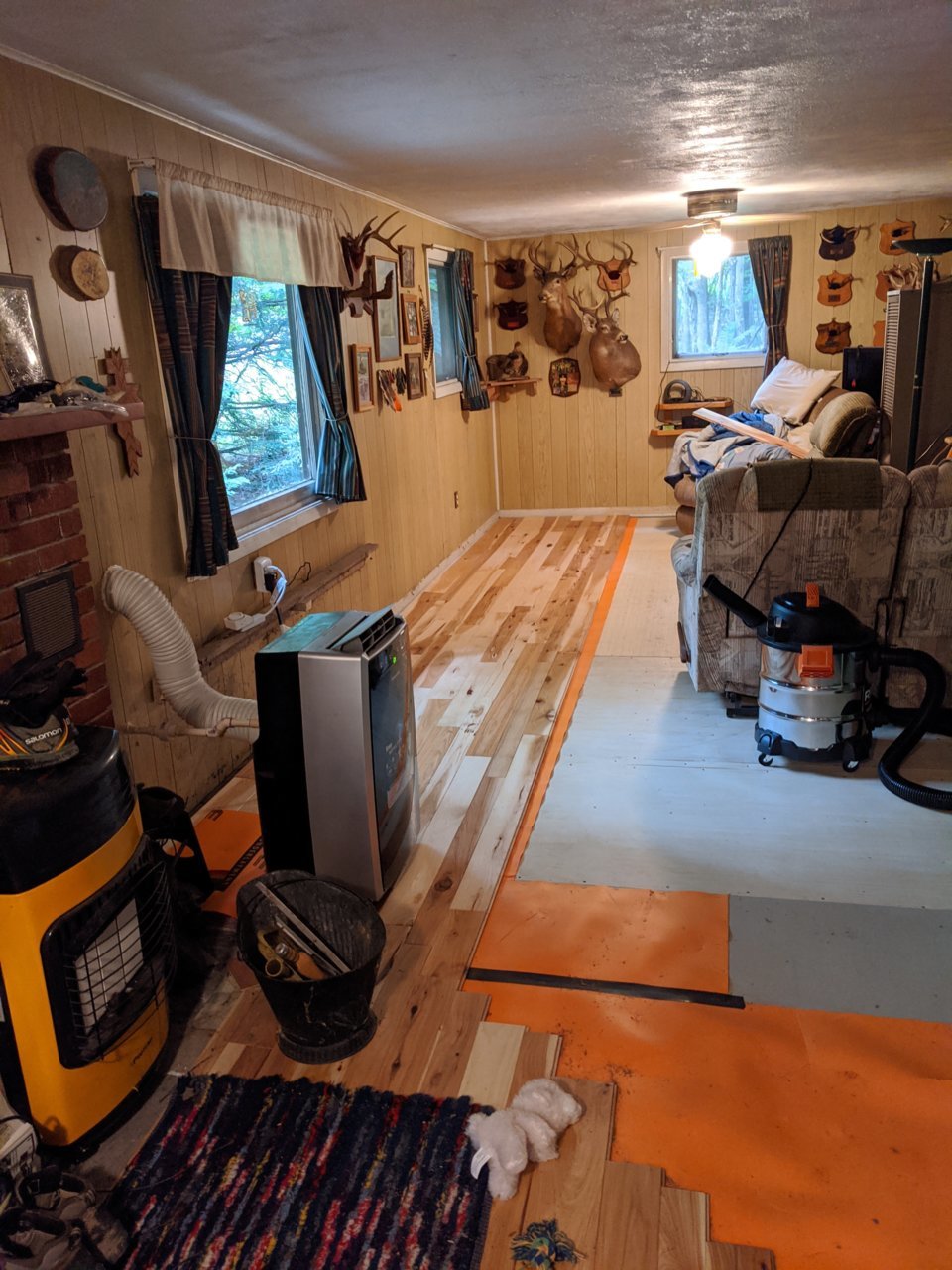

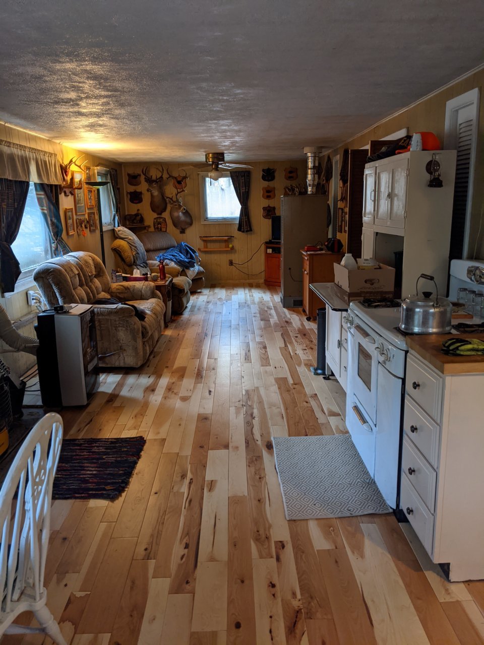

    IMG_20200815_115053.jpg MVIMG_20200815_151710.jpg PXL_20201024_153238273.jpg The order I would do it (just finished hardwood flooring @ my cabin this summer) is: 3/4" plywood, sound barrier (insulation?), then hardwood.

    More and more people are using wood like vinyl flooring for the last layer, tough as hell, easy to take care of and in some cases water proof.
    Chris(NJ)[OP] likes this.

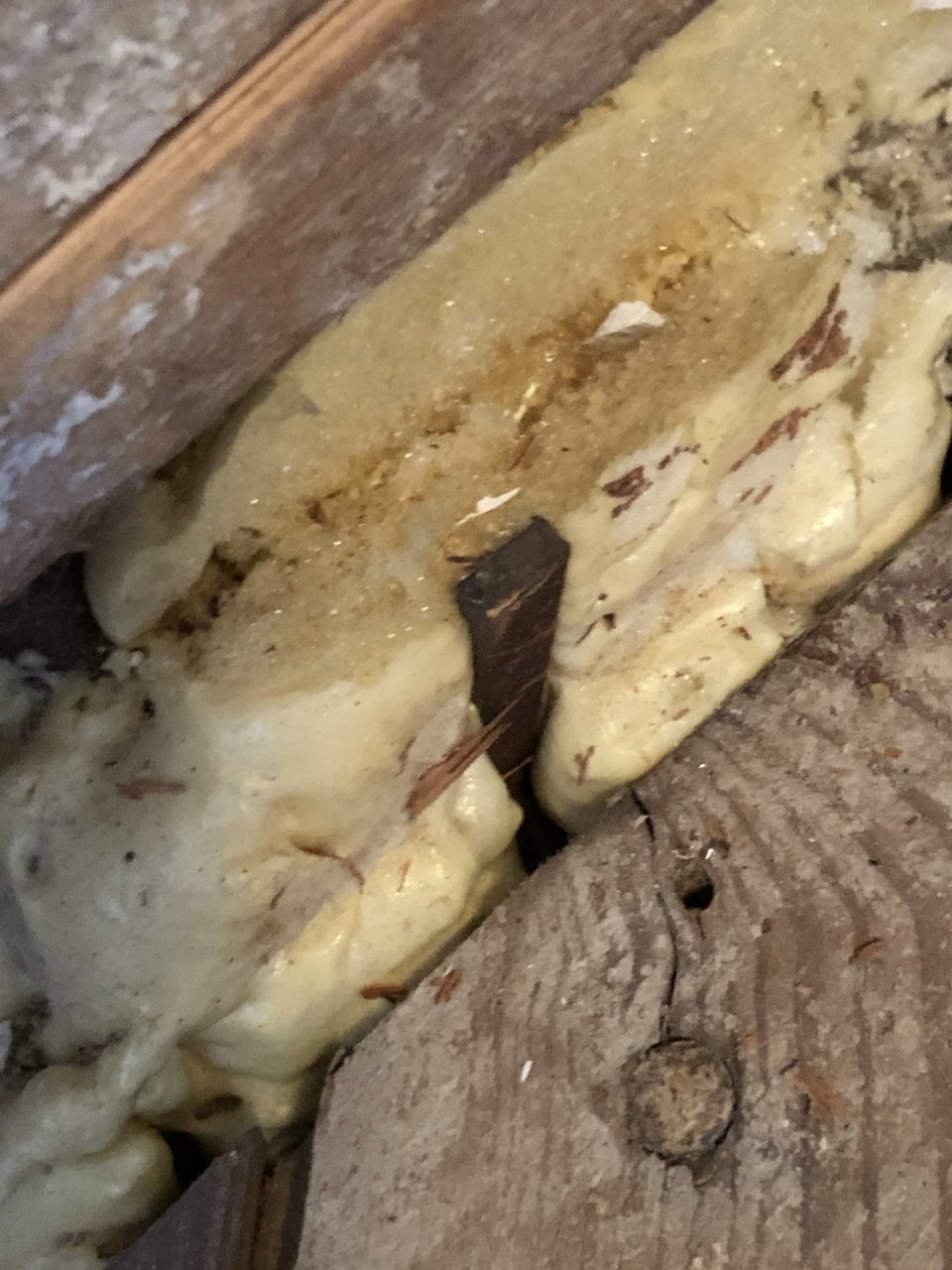

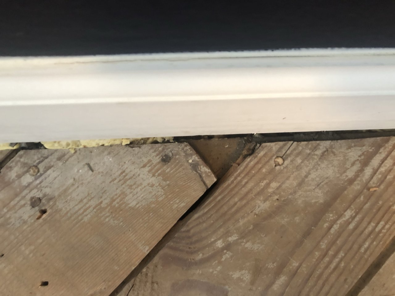

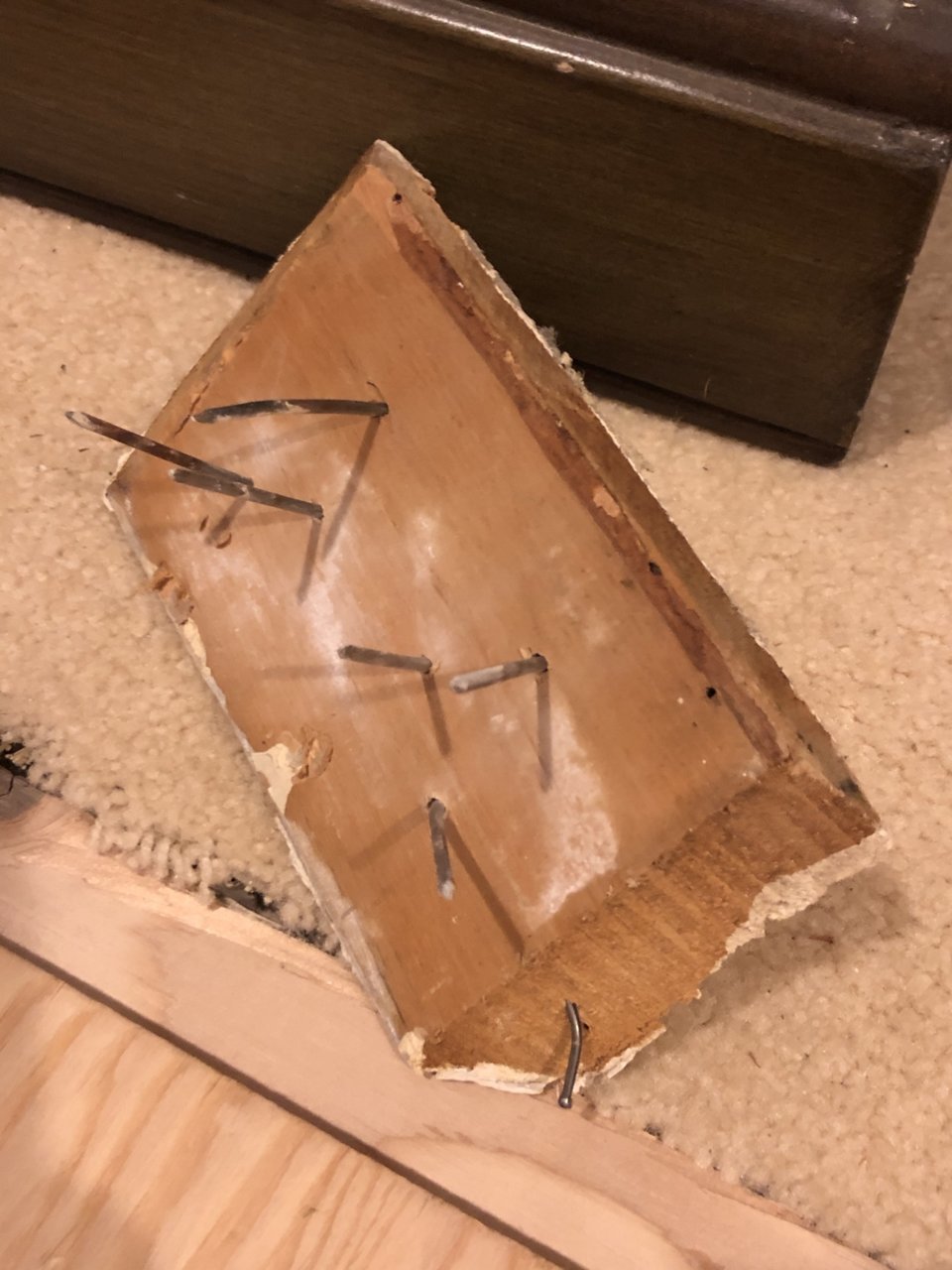

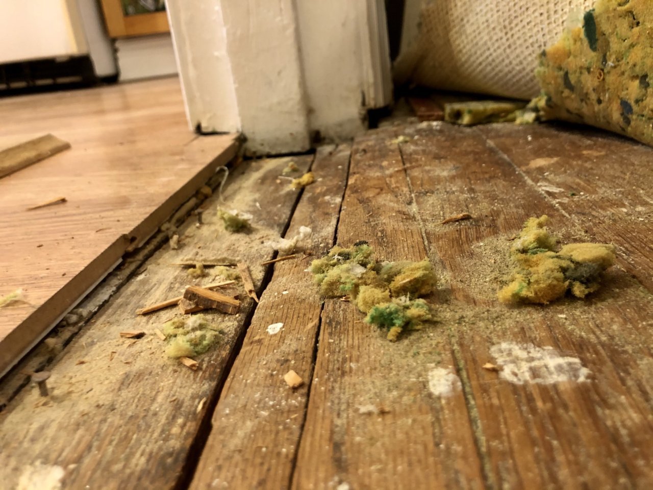

    So here's what's happened over the past 3 weeks. I've pulled up the carpet and hardwood in the bedroom and hallway. I ultimately opted to pull any loose nails and add an additional screw to the subfloor at each joist. New pine T&G ply over that. It's solid so far! But man, the old hardwood was trashed! Crazy gaps, deformations, paint dripped from who-knows-when.
    They missed plenty of nails along the walls lol
    And they certainly don't build 'em like they used to! 6 nails for a 5" piece of trim!!
    Wasn't always pretty once the carpet came up

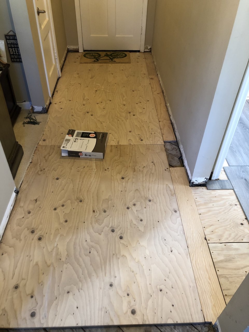

    Here's how the new ply is laying down so far. I don't think I snapped a pic of the bedroom floor for some reason
