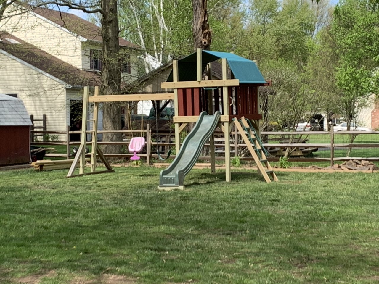

    My wife and I built this from scratch two weekends ago. We watched this YouTube DIY
    https://youtu.be/RcJ0jQiW-yI , bought the brackets on Amazon and got most of the other stuff from Home Depot. Waterproofed all the wood also. I was thinking 4-5 hrs, it took us 9hrs total. My short bed definitely did some lifting.
