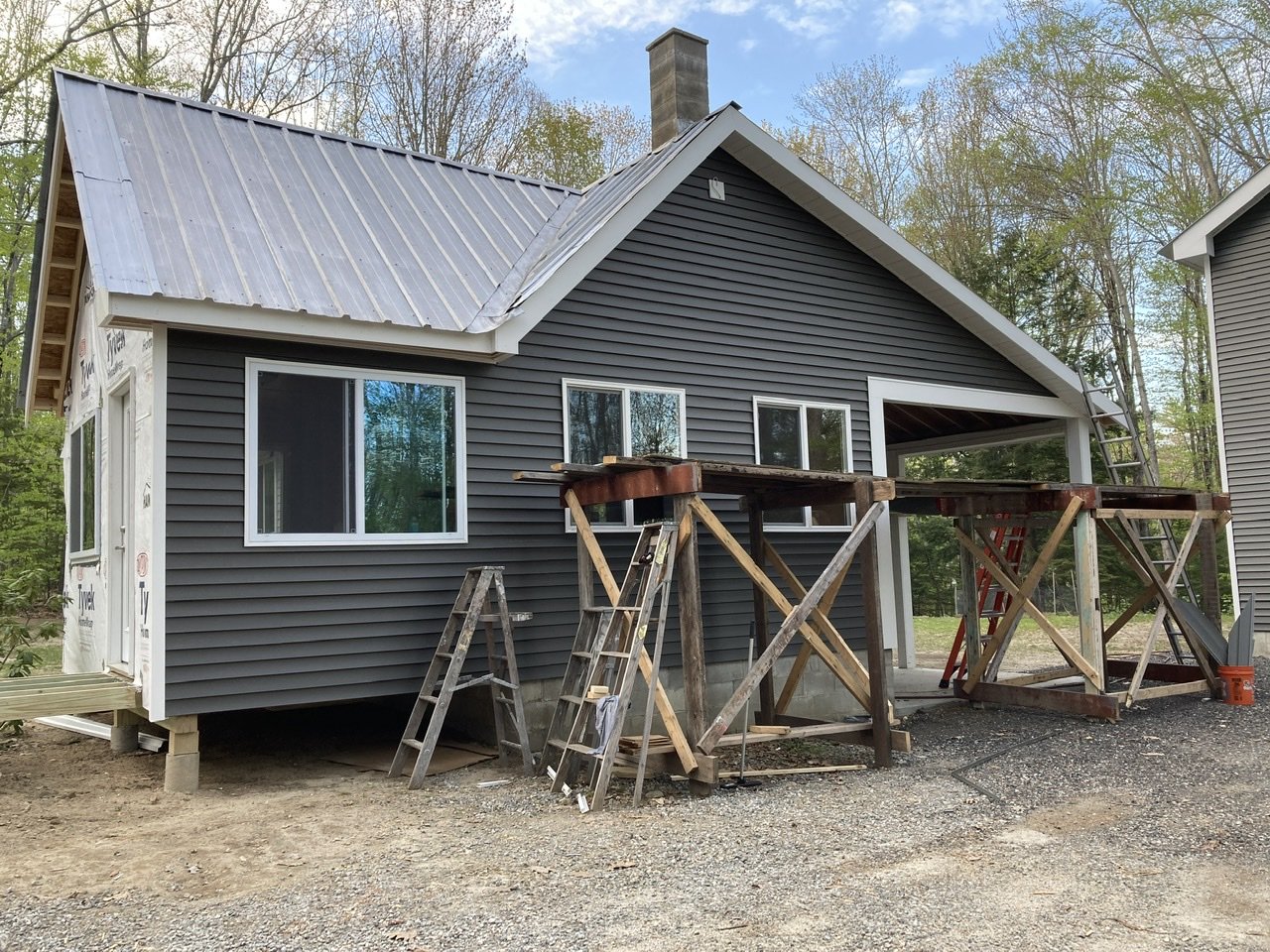

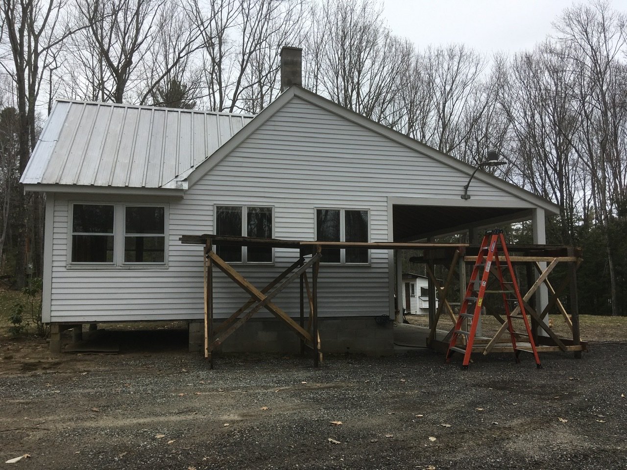

    Shouldve done this years ago. Stripping to studs, reinsulating, resheathing, new windows, new siding, etc etc

    Looks great,!

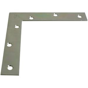

    The easiest but jankiest thing would be to get some corner mending braces and a bunch of silicone:

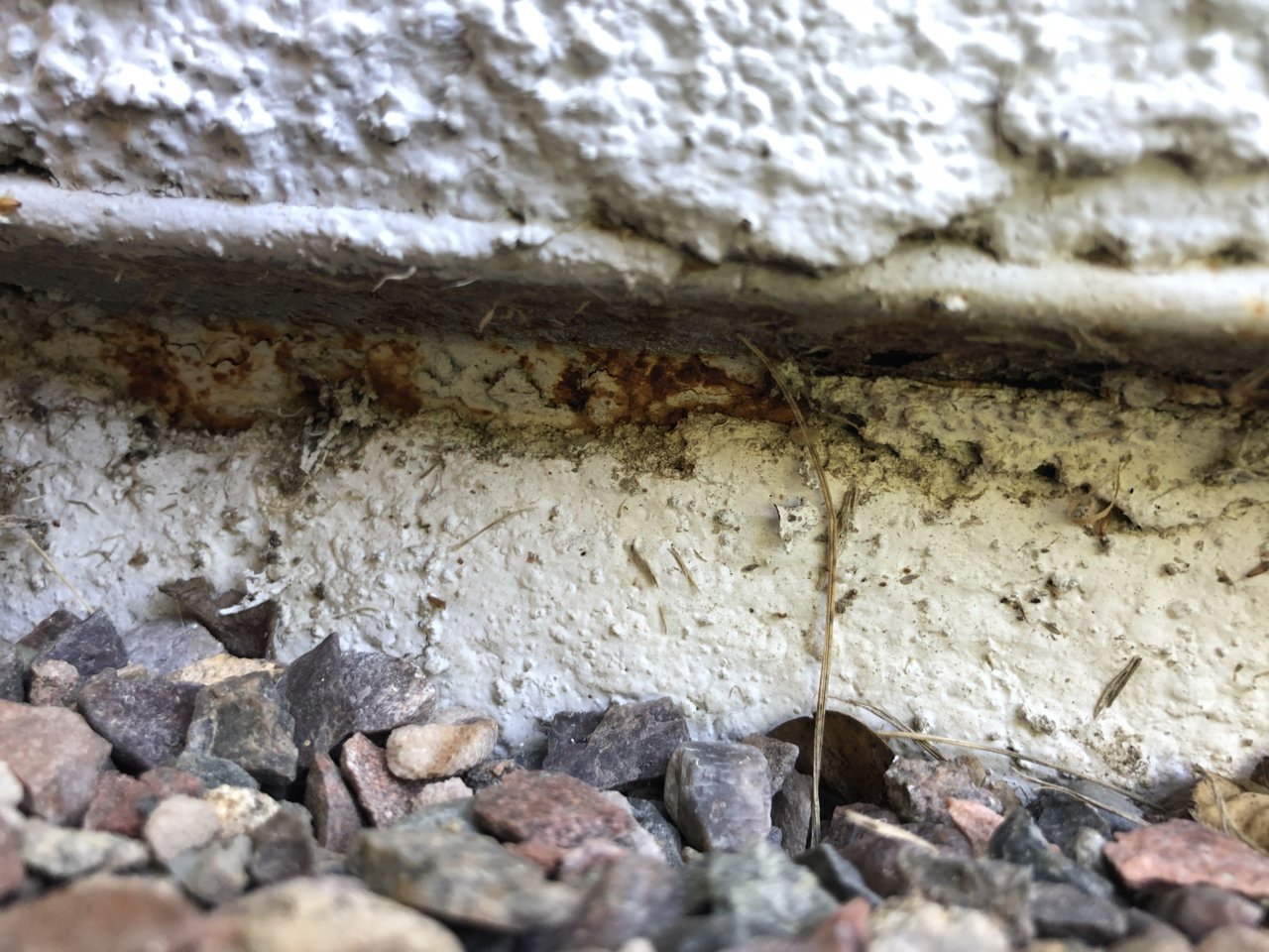

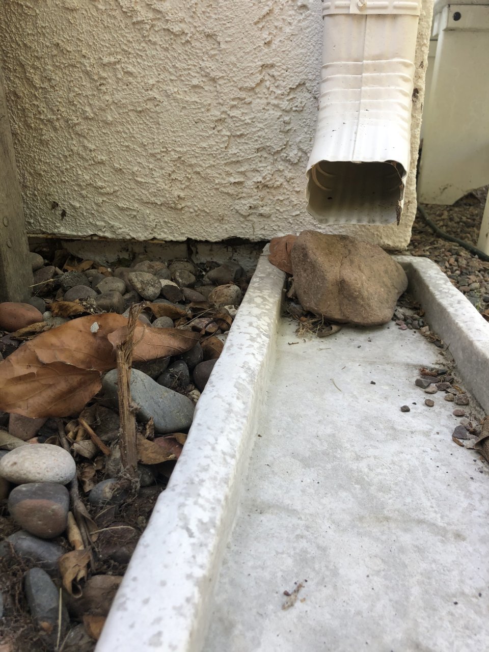

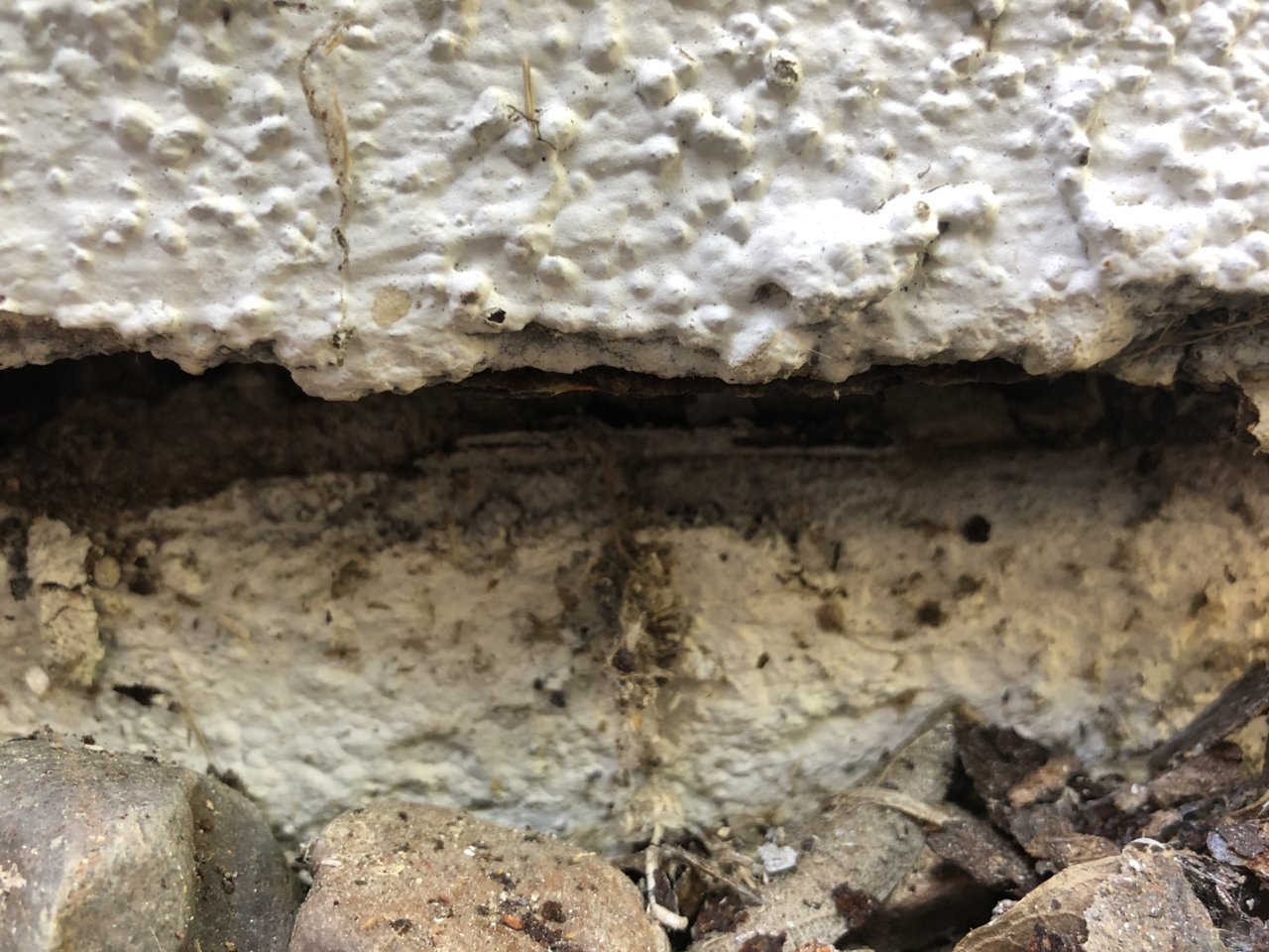

    I’m hoping someone here who knows more than me can help me out on this.
    Half of my house is stucco siding. Today when cleaning up I noticed some rusty metal sticking out behind my gutter.
    I guess there is a metal flashing that folds into the slab where the stucco ends and the slab starts. But that section has been rusted out due to the water coming off the drain and time. House was built in 1966 so I’m always fixing little stuff.
    I tried to take a few pictures. It’s only an area like 1ft that is rusted out. The bad stuff if pic one. The good stuff is pic 3.
    I think this is called stucco weep screed. Not sure.

    Yes, weep screed. Allows air circulation and downward moisture migration from behind the stucco. I bet that splash block was not there until more recently. You may be able to cut a short section of new screed and jam it up behind (not in front of) the old piece. Check on the other side of that wall (slab? crawl?) to see if there is any moisture/discoloring/mold now. If not, you coudl let it go until its time for your next house painting and then repair it correctly at that time.

    Thanks for the info. Glad I was on the right track. The house had water damage to bad drainage like 20 years ago apparently. But it wasn't major. They put pond rock all the way around the house to make sure that never happens again. I bought a moisture meter to check the moisture of the walls in the bedroom on the other side of this wall. Yeah. I wonder when the splash block was put in. I'm debating removing the splash block and just extending the gutter out further onto the rocks away from the house. The house is a slab so there is no way to get on the "other side" of it to see. I stuck my hand in there and it feels totally dry. I painted the house two years ago so I'd rather not do anything unless its necessary. Again, thanks for the help. Much appreciated.

    Cheers. Yes, gutter extensions highly recommended. In Socal, anything to dry out pretty readily as long as it has air exposure or is not on a coastal fogbank area.
