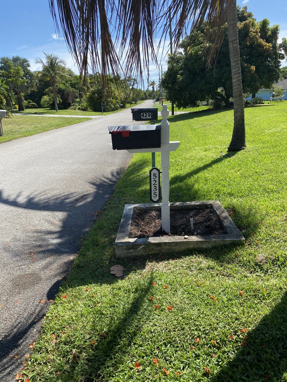

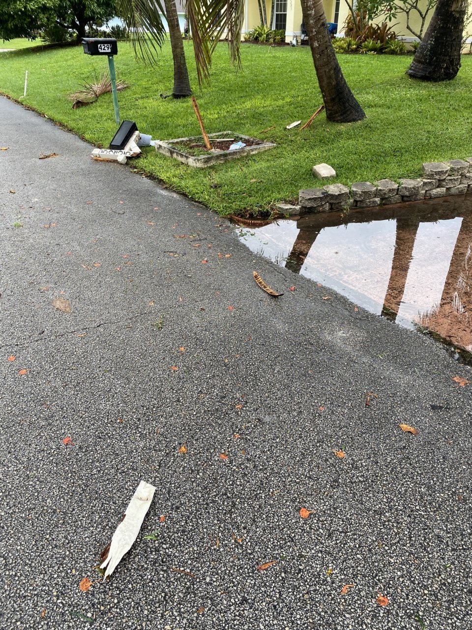

    My mailbox got blown up by lightning, so I had to put a new one in.
    Today’s project.

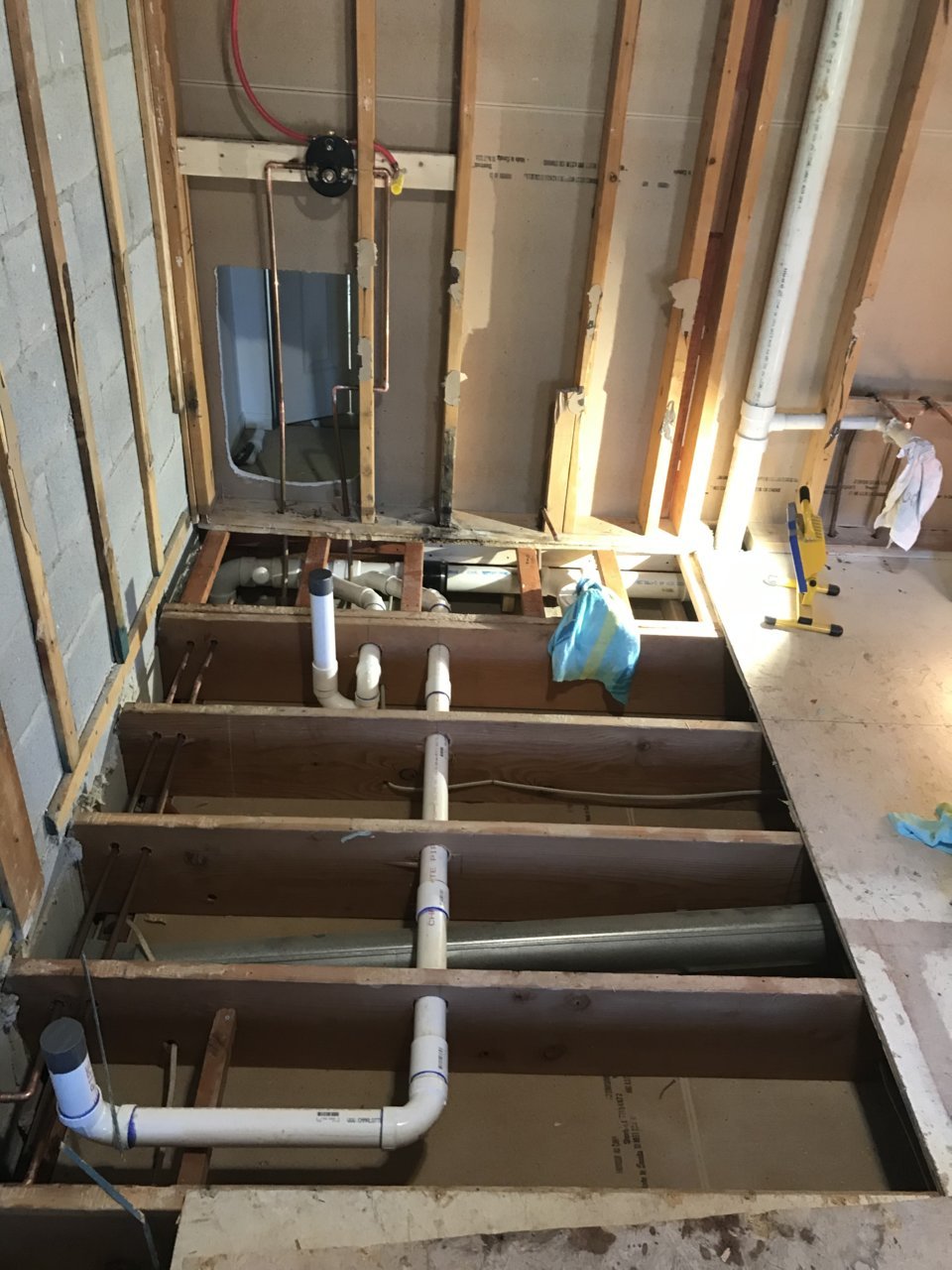

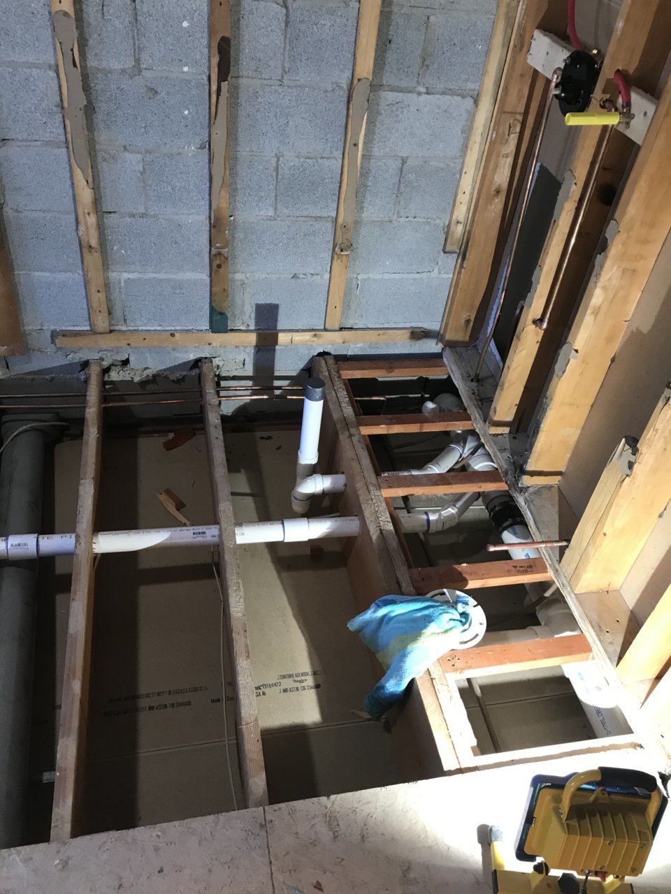

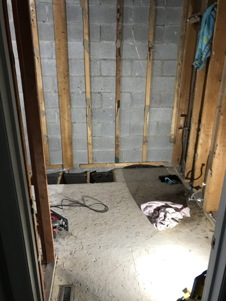

    I’m helping my son remodel his first house (main bathroom). Removed the one piece shower/tub, relocated a few walls, installed new plumbing for a stand alone tub and separate shower.
    It astounds me that the use of 2x3 studs for walls and OSB as sub floor is a legal and accepted practice!

    what is supporting the joists at the block wall ?

    The block. It’s a middle house unit in a town house complex. The joists run unit to unit with a ‘fire cut’. None of the interior walls are load bearing.

    Hard to see but where's the toilet vent? Are you wet venting it off the lav?

    The 4” PVC running vertically in this photo
