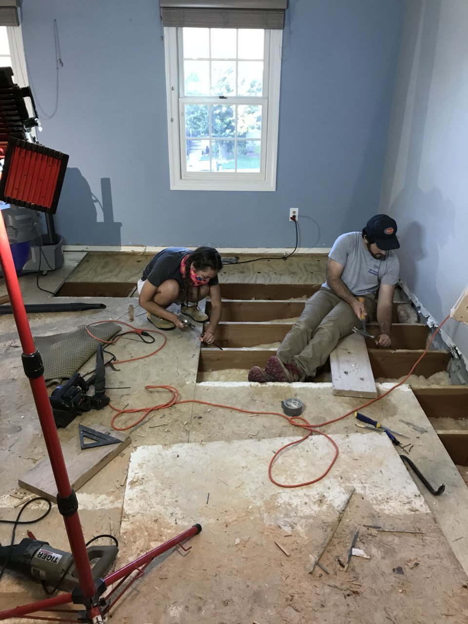

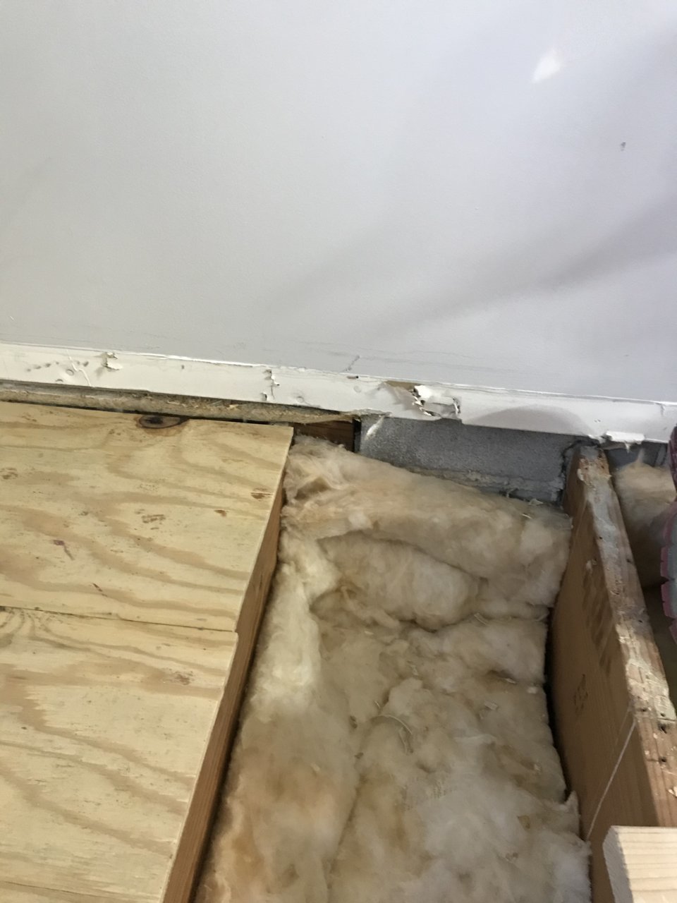

    Well, continuing my sons house renovation. On my first walk through I notice an elevation difference in the master bedroom floor of a half inch . Upon further investigation (removing the OSB subfloor) we discovered the joists set in the block wall were 1/2” higher than the 3 joists set on framing where the block wall (fire wall) ended. See photo. The only viable solution was to add 1/2” plywood to the 3 lower joists then lay 3/4” CDX atop that running to the higher joists.

    So that joist goes into the block wall? There's no ledger? That's some piss poor framing right there. Cement and doug fir don't like really get along that well for extended periods of time.

    Agreed! ‘Piss poor’ is putting it lightly. The kitchen soffit is directly beneath the floor, I noticed zero fire stop blocking in the soffit. I shot my tape measure down the wall of the soffit, all the way down...

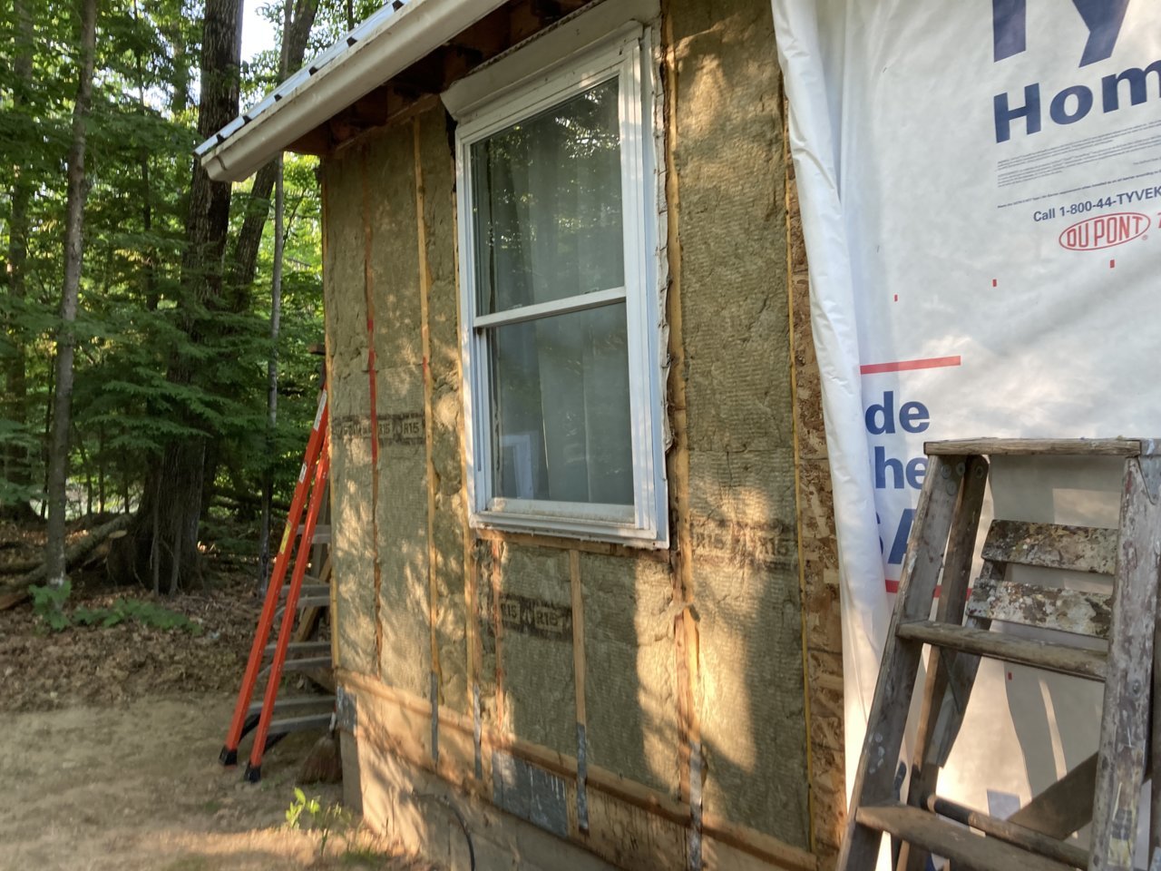

    Ripped the last section of sheathing off and reinsulated. Window replacement tomorrow, resheath, wrap, then can start siding. The inspector was diligent today and shit everywhere.. but she passed my roxul job:rofl:

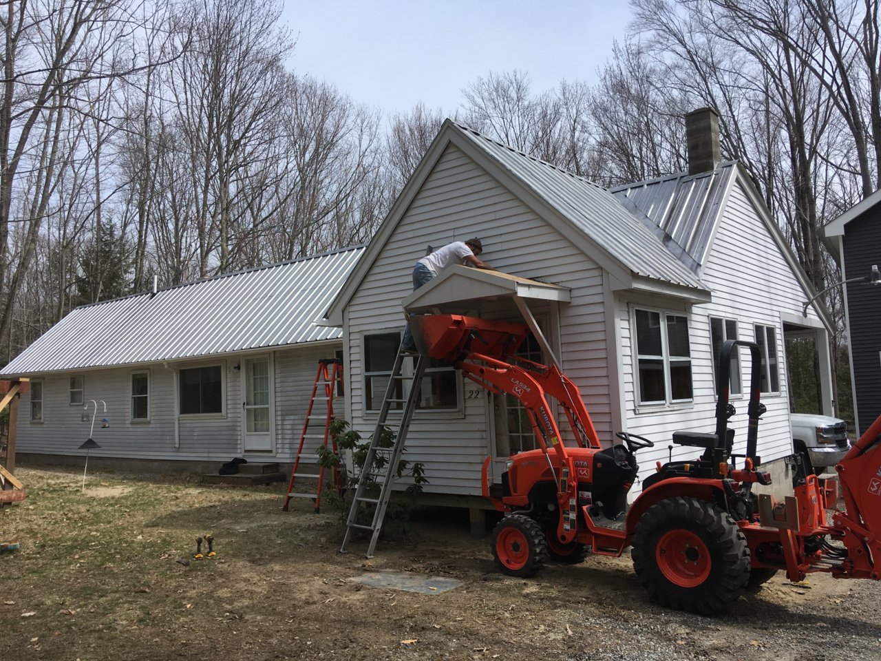

    7 weeks of un-sheathing and un-insulating and re-insulating, re-sheathing, new windows, and siding. Getting there..
