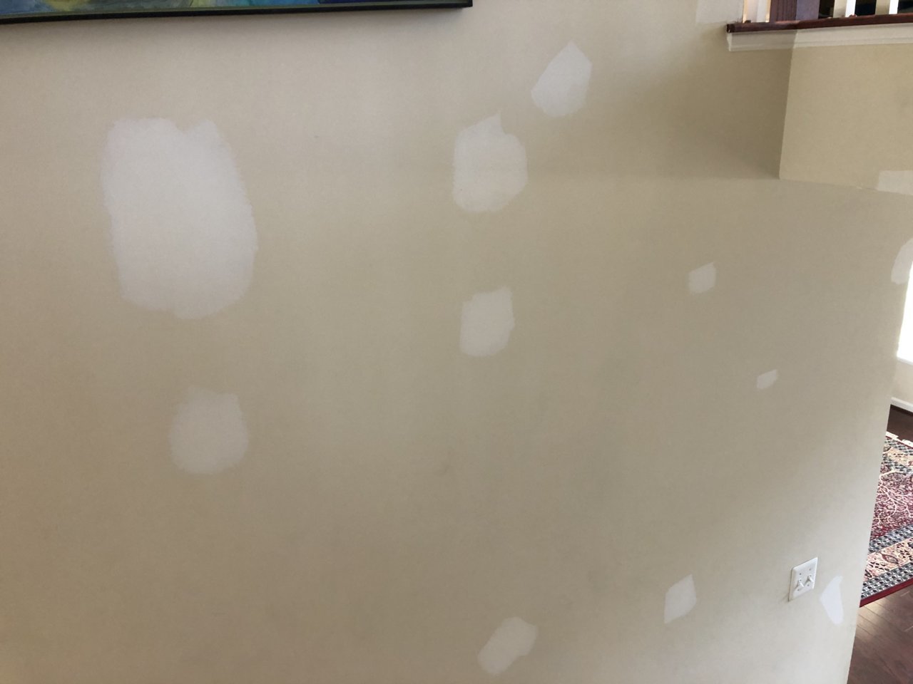

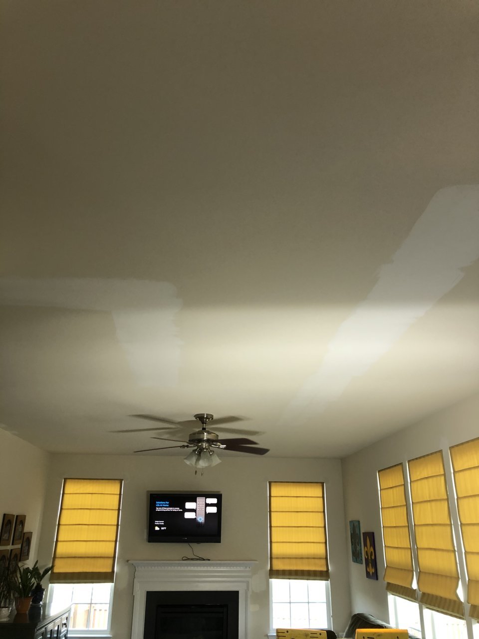

    The painter is fixing a lot of the issues with our drywall before he starts painting this week.

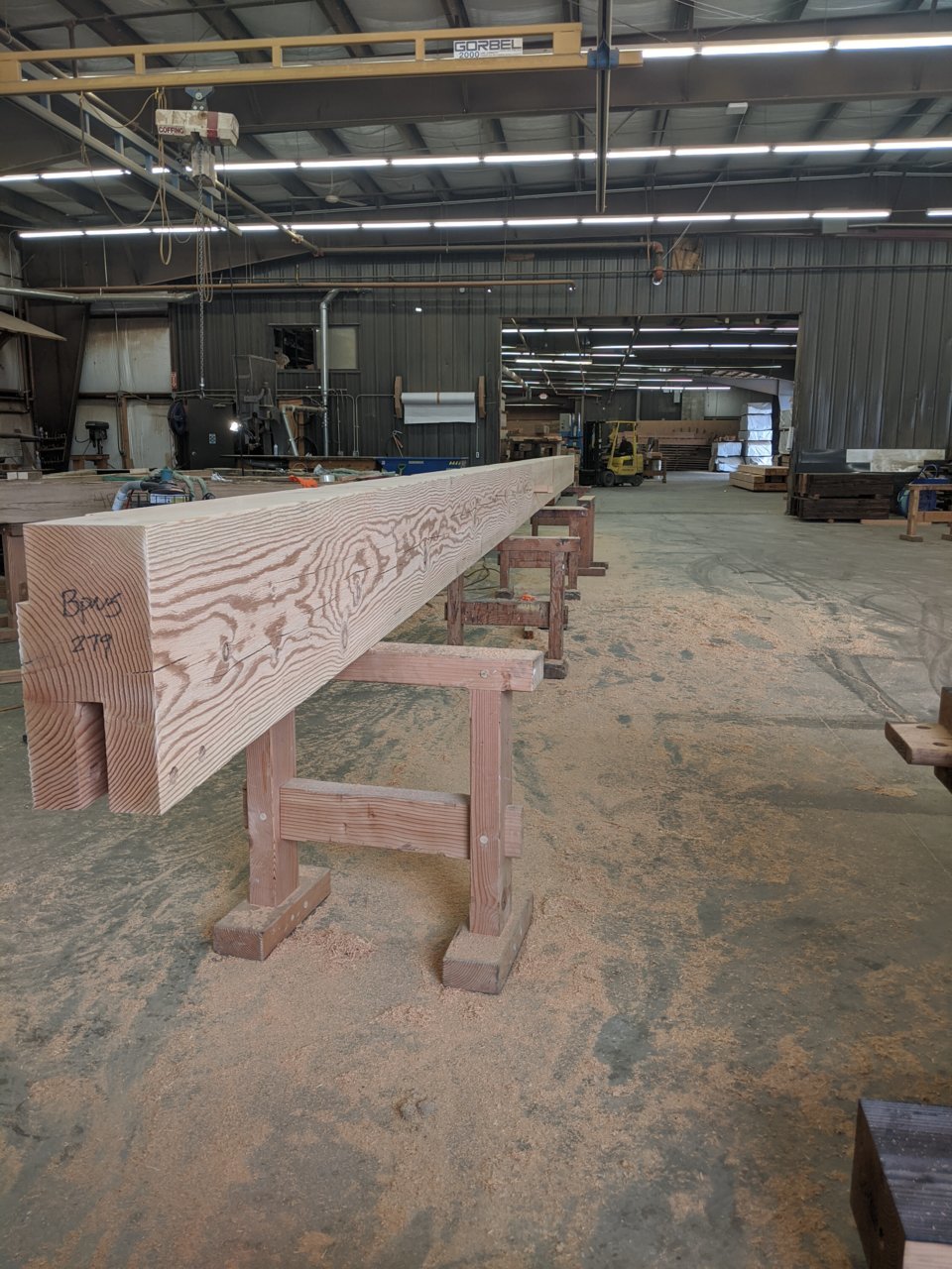

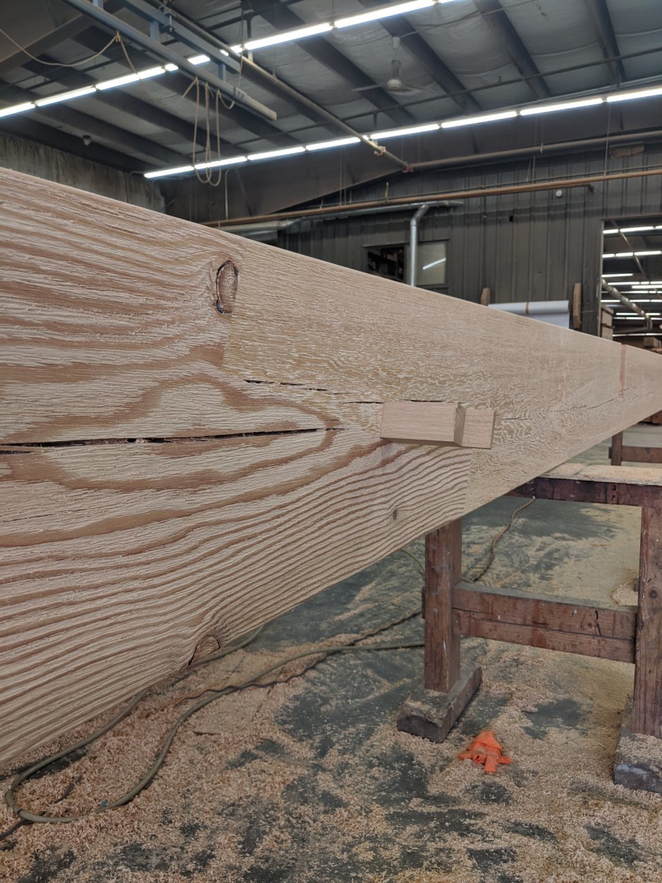

    Some stuff. Not a lot, just some.
    Serious wood pR0n there. :drool:

    Total length is 45', about 400 bd.ft. I'm not sure what the material cost is but probably at least $1,000

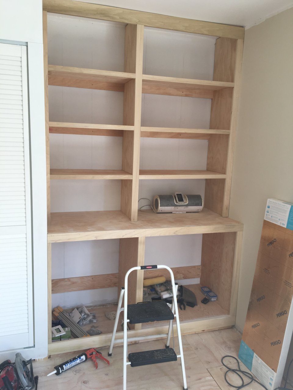

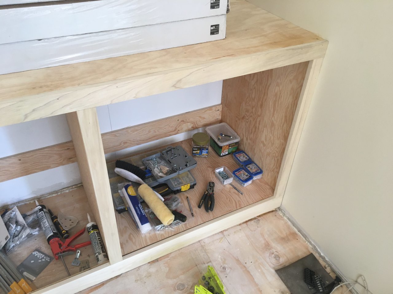

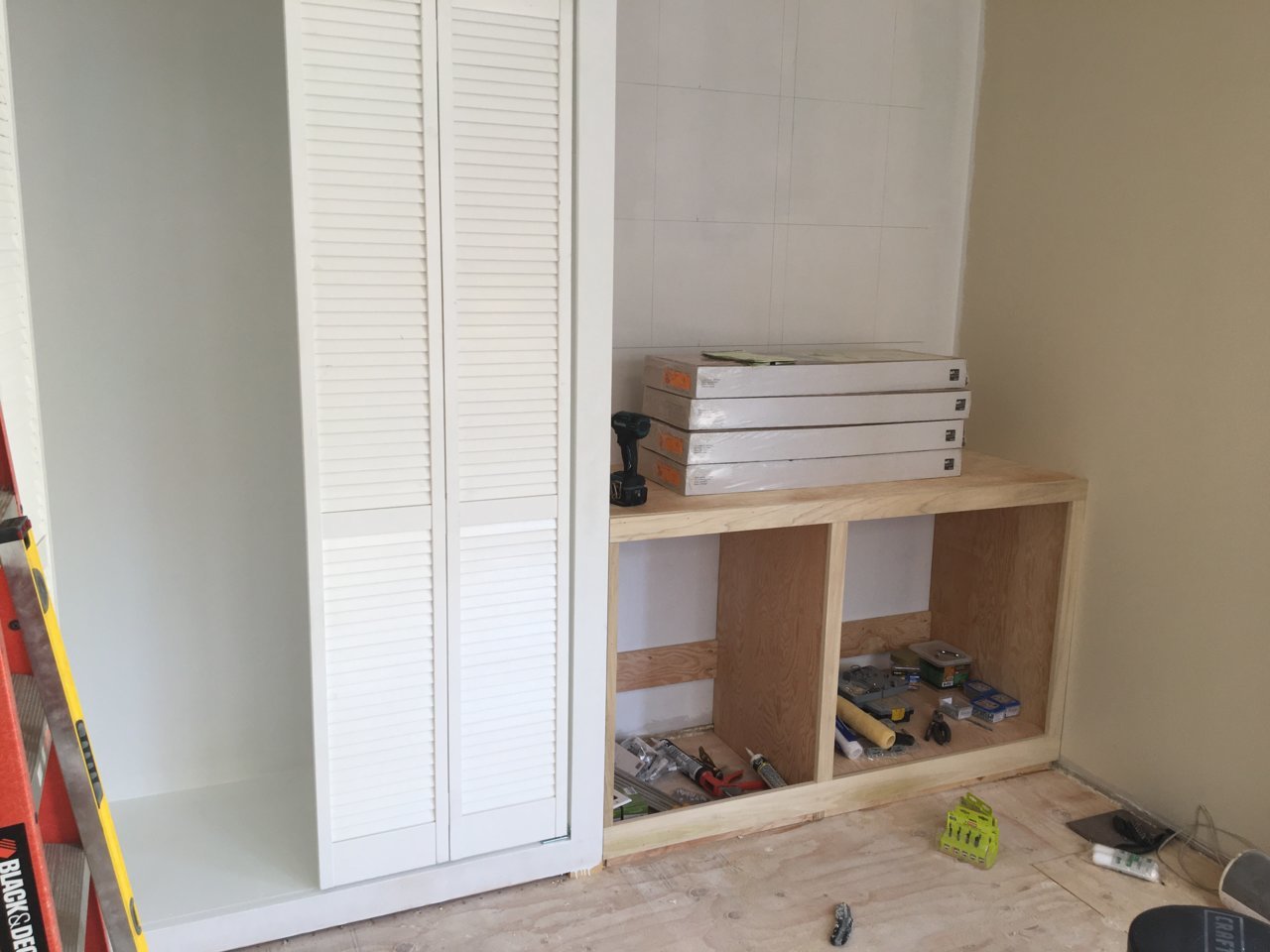

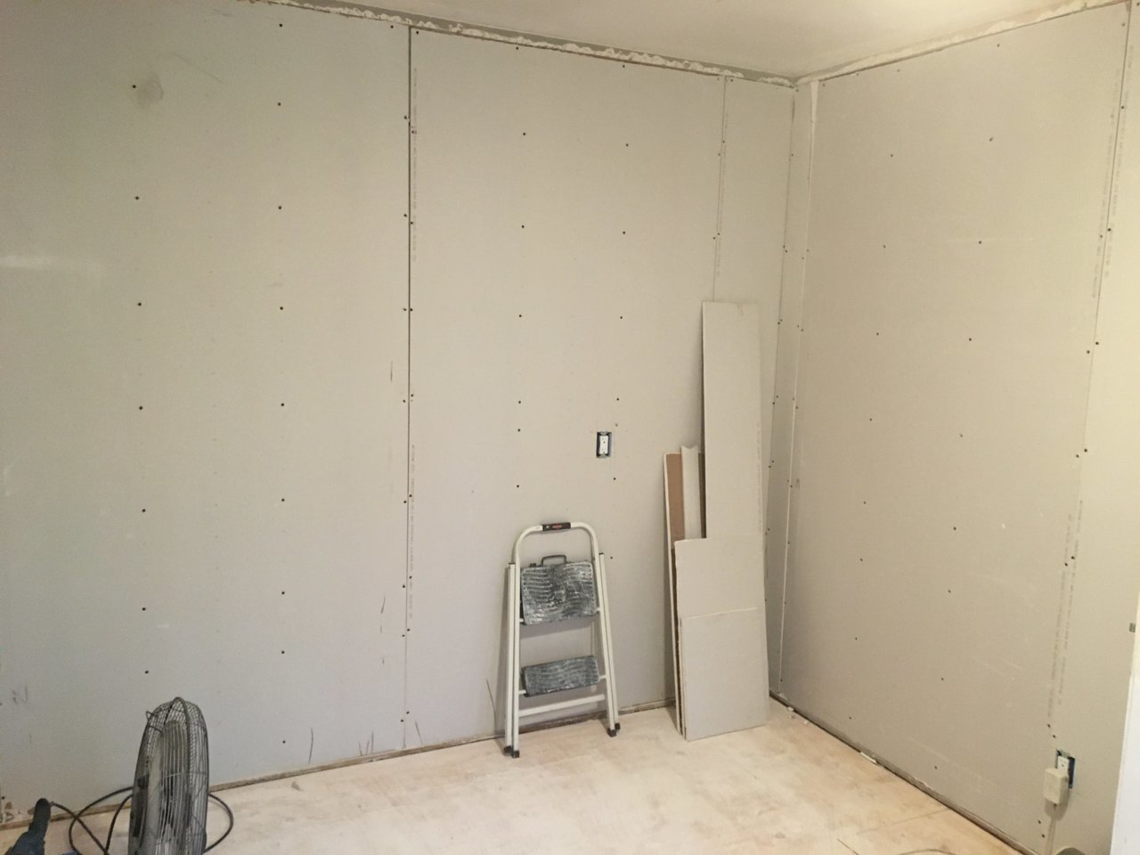

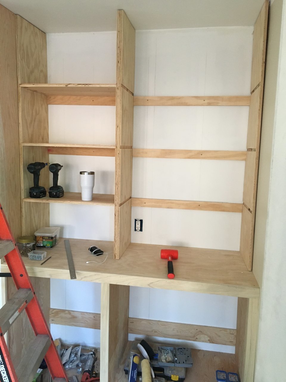

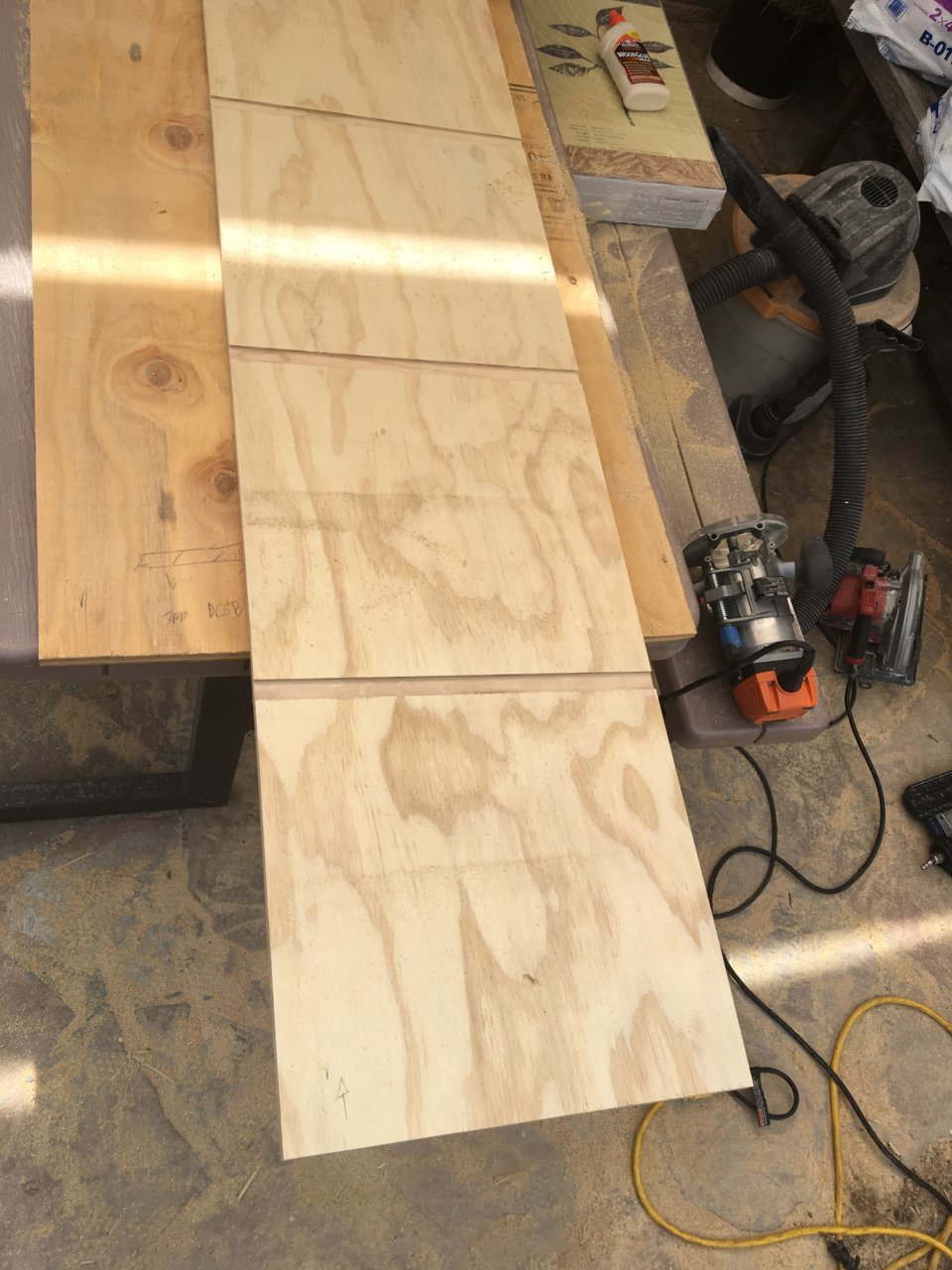

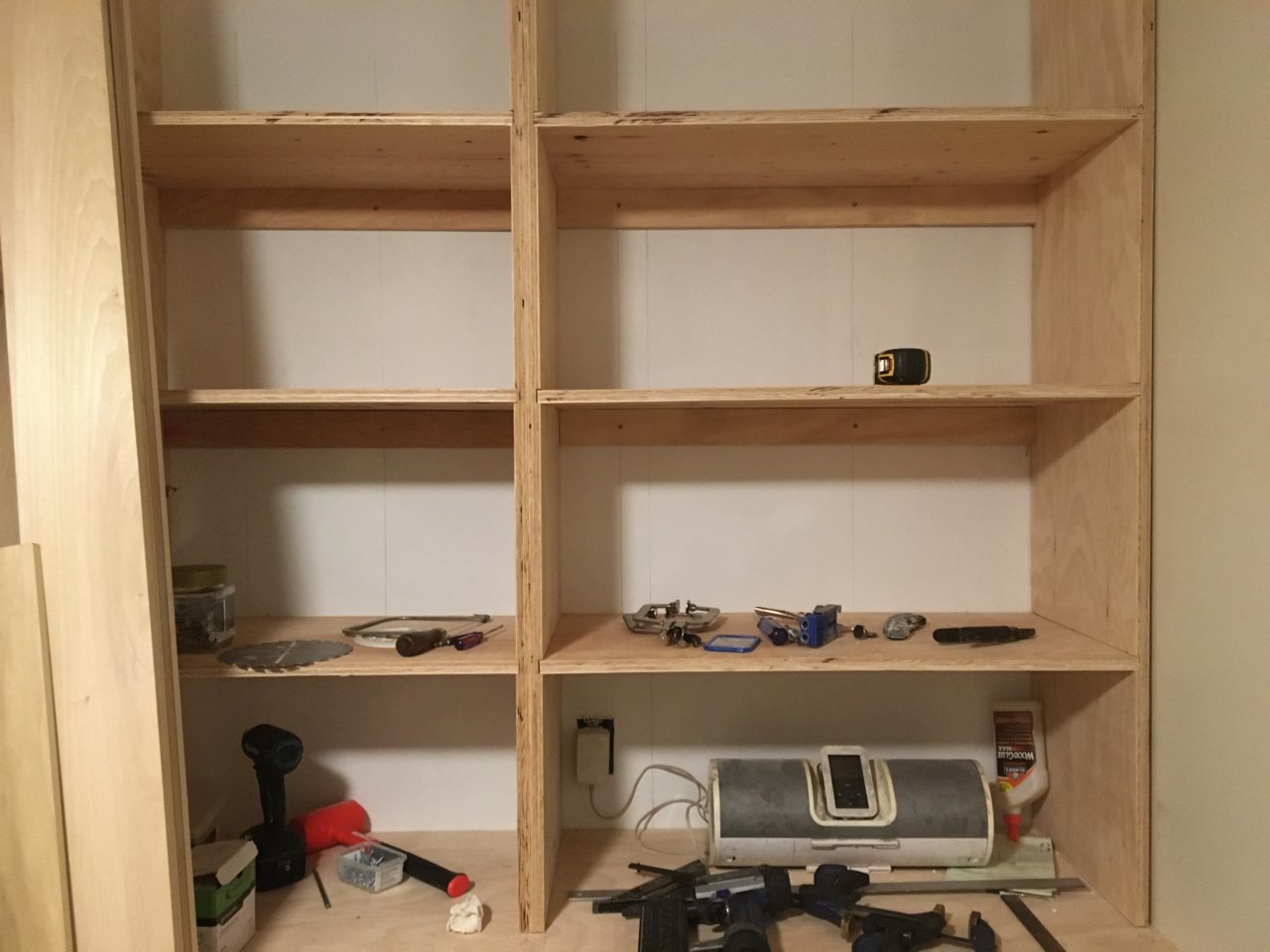

    Little update to my project. This is the same corner that I showed above. Humidity here made sanding mud a pain and slowed dry times but it’s done and smooth and painted. Building some built-in cabinets and a closet on this wall. I have the main cabinets completed and just have to finish up the face frames out of poplar. Kreg jig did a lot of the heavy lifting here as I went for hidden fasteners on everything. Also made a jig for my router to evenly space the shelves on the bookcases. Funny enough, this is my first time using the router for something other than milling out 80% lowers. Wood is way easier than aluminum. Progress pics and current state. Probably finish up the cabinets and shelving tomorrow and install cork flooring.
    Time to shake the sawdust off and go to bed.

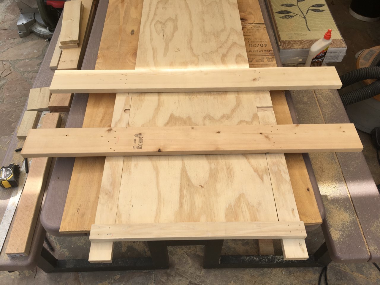

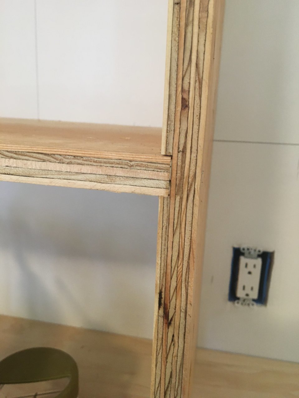

    Face frame completed. Pocket holes in the back of the frame keep everything together.
    And attached to the cabinets Glue and a few brag nails to hold it together while the glue dries.

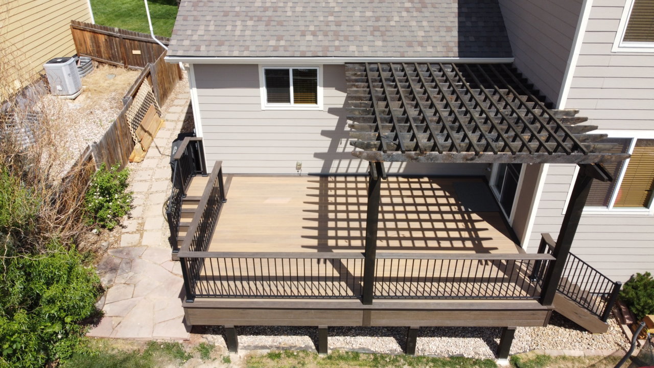

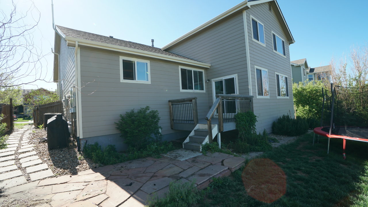

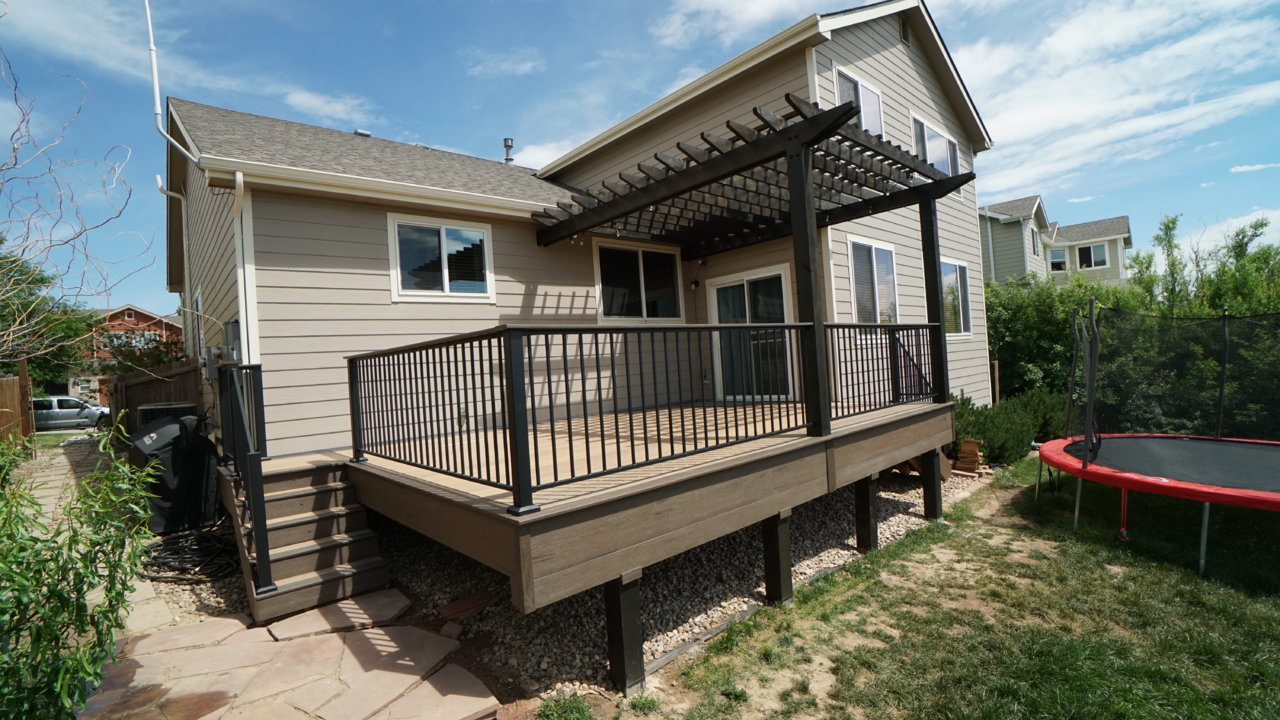

    and it looks like you even got to do some landscape work. I bet the homeowner is liking the new deck and pergola.

    Dude, the bush that was to the left of the old deck that I had to take out, retarded, those roots were something else :annoyed:

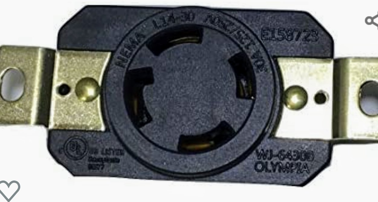

    I'm trying to add a L14-30 outlet on the back of my house. Rather than having a separate box along side the standard outlet, I want to put both in the same 2-gang box. The problem I'm having is that no one seems make a 2 gang cover plate. Has anyone seen more than a single L14-30 in a box before?

    Is this the right one?
    https://www.amazon.com/Leviton-8804...ocphy=9020759&hvtargid=pla-320149501361&psc=1

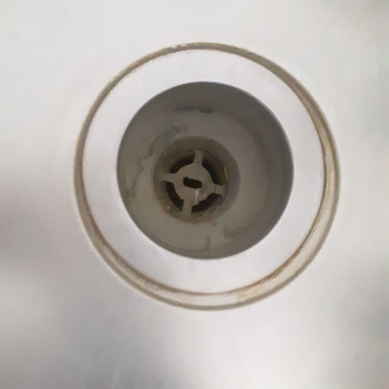

    20 min fix
    plus 3 trips to the plumbing shop before you finally get everything lol

    Yep, i just dont know how it doesnt bug people on install
