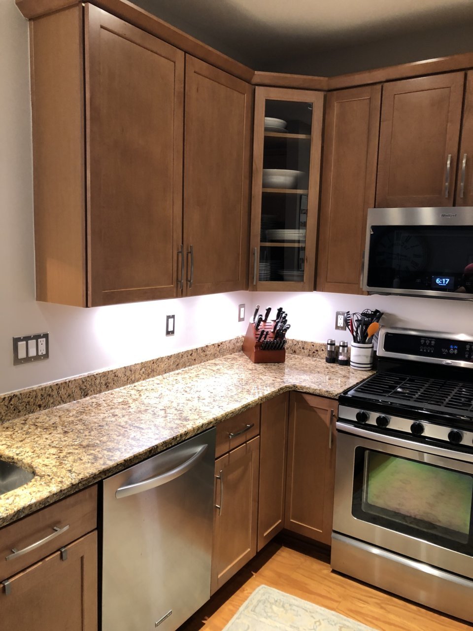

    What under cabinet lights did you use?

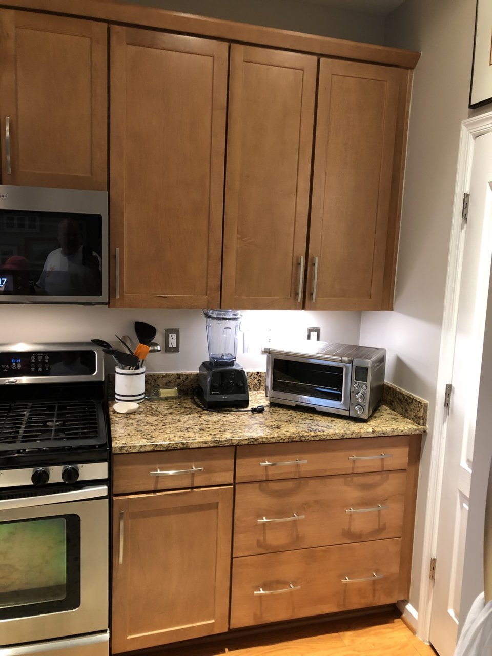

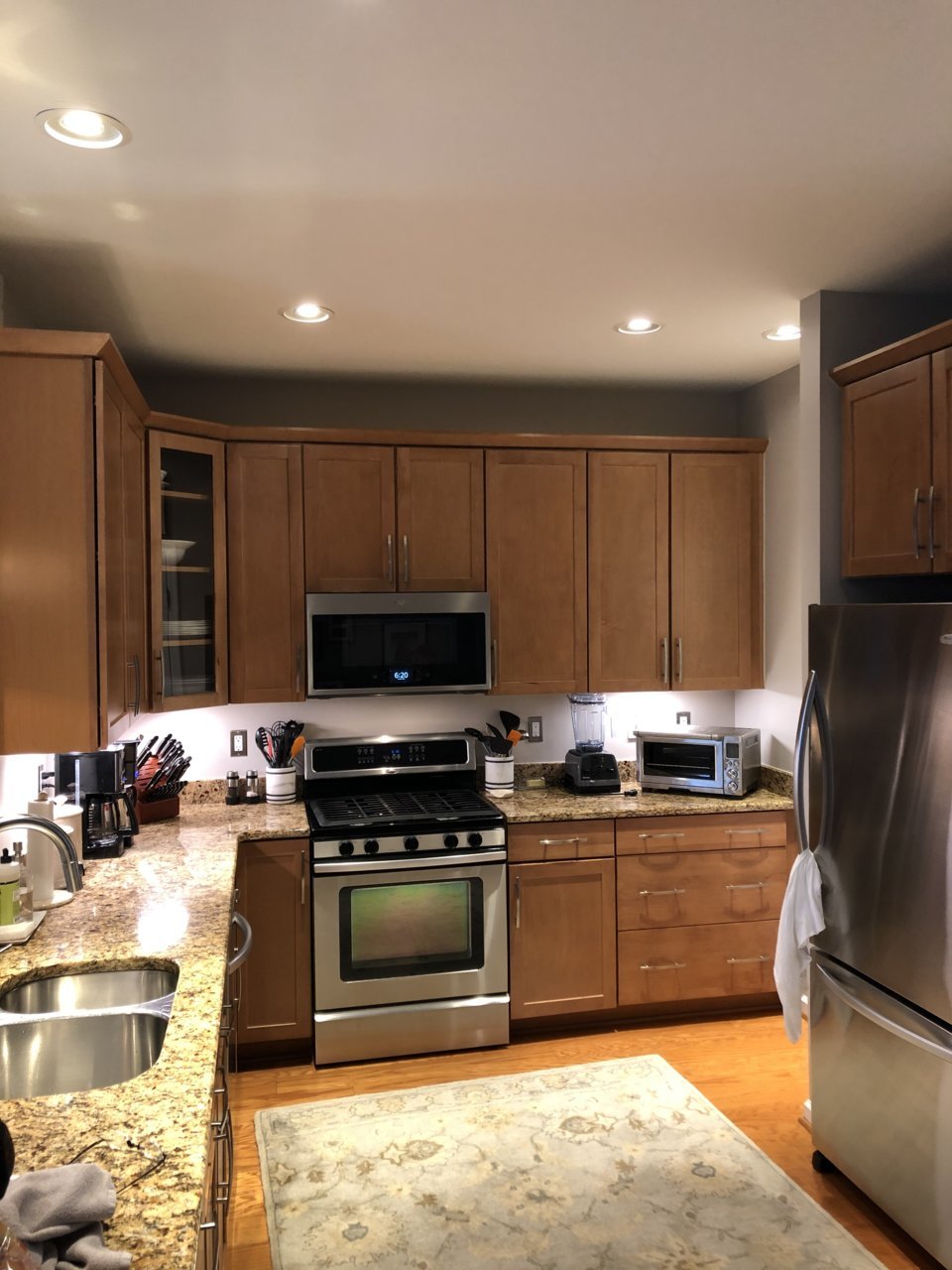

    Lowe’s was blowing them out over the weekend so I replaced the original contractor POS halogens. I thought I could do (2) 18 inch and (1) 12 but will need one more 12..... the better half is happy so I’m happy.
    Good Earth Lighting Premium Slim LED Color Changing 18-in Hardwired Light Bar
    Item #879889Model #UC1138-WH1-18LF0-G

    Thanks ill look into them

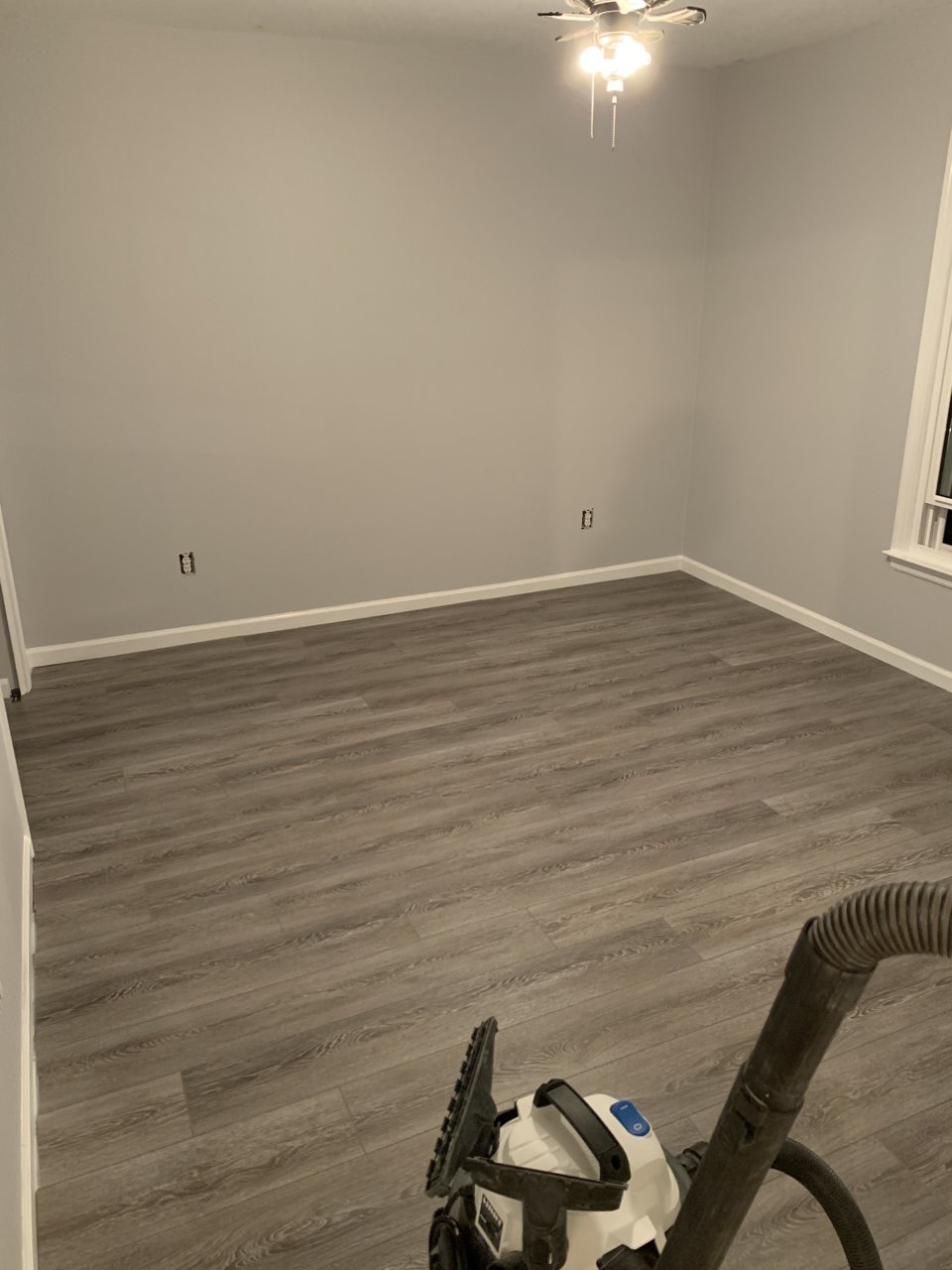

    I'm about to start my next project of basically what you did, next month. Ripping out carpet and installing laminate over slab ~250 sqft. I do have a couple questions for ya...
    Did you end up using SLC? How'd it go? I've heard getting the right ratio water/mix is tricky. Did you have any need to block the SLC from entering next rooms?
    Depending on how much my slab needs leveling, I am thinking of using either Ardex FF, or if I have to use SLC.:notsure:

    I’m in the middle of installing laminate and LVP throughout the entire house and I am using SLC everywhere. For the rooms I’ve done it in so far, I couldn’t imagine not doing it. Even my lower level, on slab, needed it. The end results are amazing. Yes, it’s expensive, yes, it adds extra time, but I’m so glad to have done it. The stuff I’ve used (Custom Building Products) has been pretty good about getting the consistency the same. I measured the 5.75 (the max in the suggested range) quarts into a 2 gallon bucket and drew a line on that bucket. That way I was able to repeat the water amount every time. Yes, you need to add a small dam between every room (wherever you want a threshold or to break up the pours). If the SLC is on wood subfloor, you will need to add metal lathe. There is also a primer for it (I usually need 2-3 times more primer than the bottle says it will go i.e. if the bottle says it covers 450sq ft, it really covers about 150). Most of the laminates have an allowable variance. The stuff I’m using is only 1/8” difference over a 10’ span. The warranty on the floor won’t be covered if there is any more variance than that and I’d imagine that the joints will potentially crack with movement over time too. If you don’t have time to do the job twice, then do it right.
    Room in this picture still needs quarter round around the perimeter, but you get the idea.

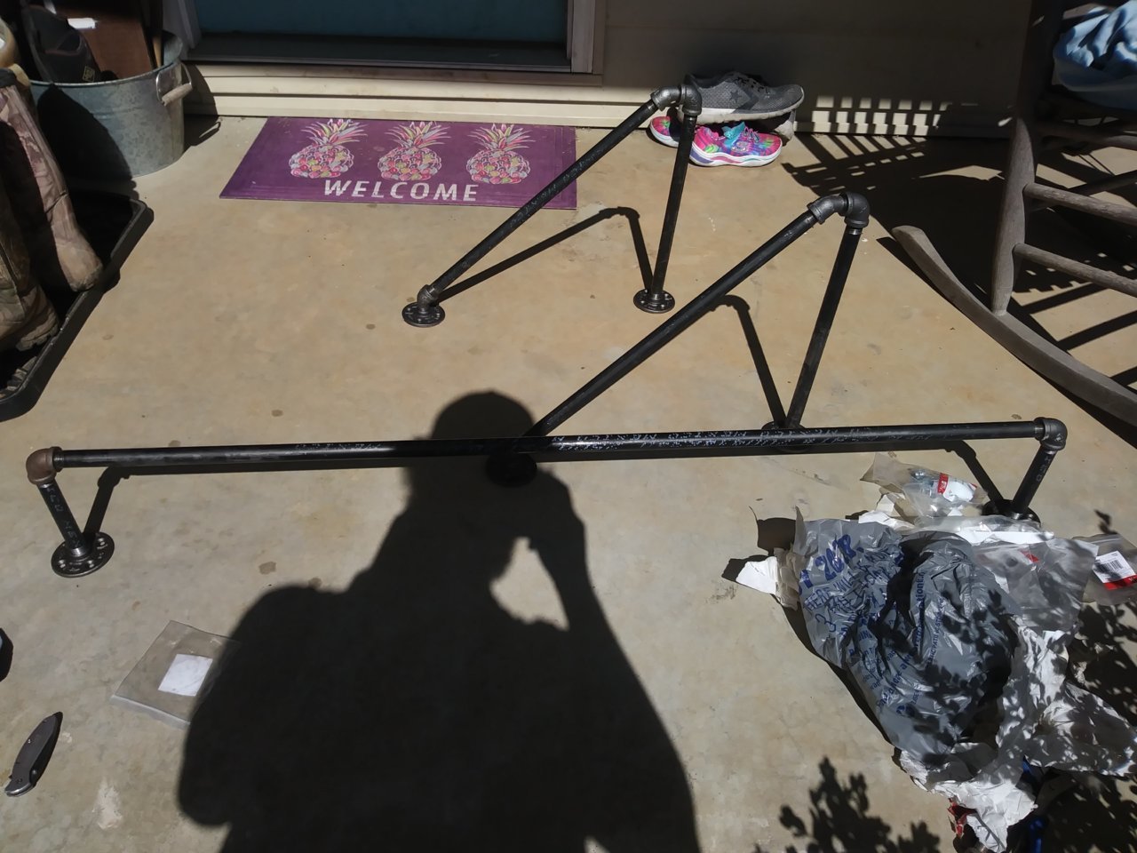

    Dropped $75 on some 1/2" black pipe and fittings and made a clothes hanging rack and brackets for the folding shelf for the laundry
